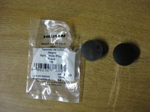

my first place was lowes and it took me awhile but i found one, its a nylon 7/8 hole plug that fits absolutely perfect in the hole. heres the pictures to prove it
heres the packaging and what they look like, i think it ended out to being 1.20 at the register. i sanded down the one on the left for a smoother surface to paint on. and i also sanded the dia just a hair so it perfectly fits around the hole

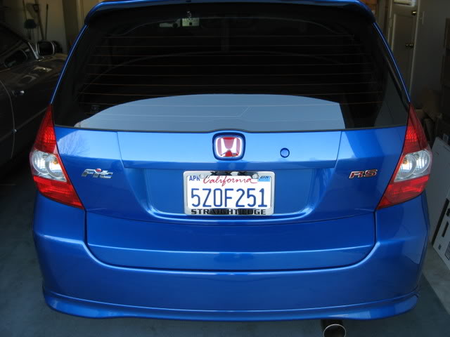

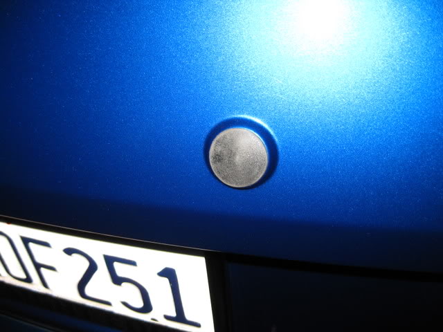

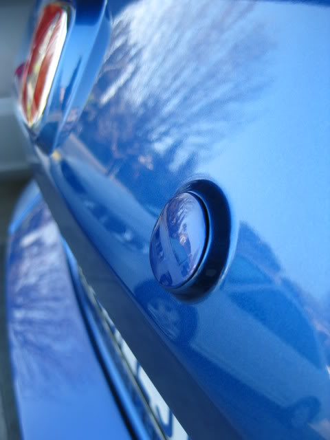

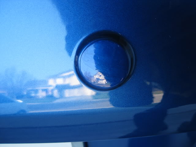

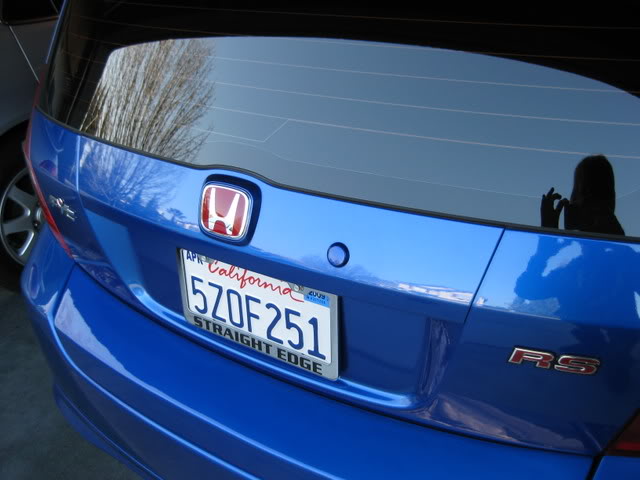

and heres the finished product!
to paint it all i did was sand it down really well and did my best with some touch up paint, it looks perfect to me, alittle dark in some areas but you cant tell very much at all, i hope everyone gets what i got out this one and grabs one of these for an easy perfect mod.

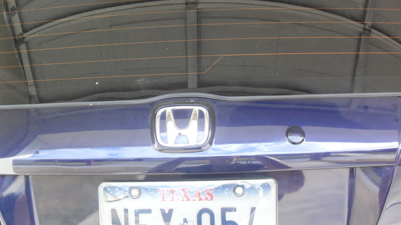

Well i wanted a temp. solution to deleting my rear wiper from the Fit, simply because i do not use it and it collects nothing but dirt on it.So i searched around and found this post
Enjoy:

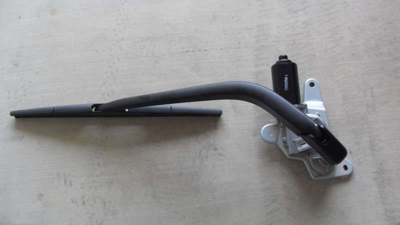

First, Removed wiper and motor from the hatch
Hole in hatch
Went to Honda and bought a bottle of Touch-up paint
BBP is now KNOWN AS DEEP VIOLET PEARL
Made a trip to the hardware store and picked up a few 7/8 nylon hole plugs and laid a few coats of touch-up on them

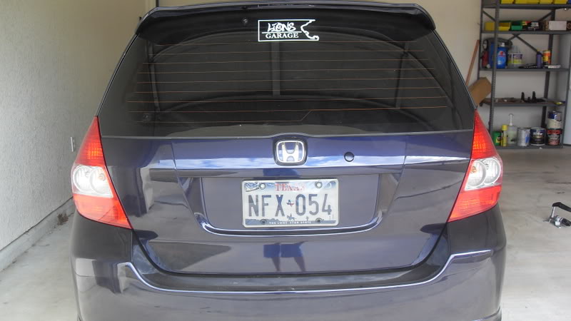

Finished product :
