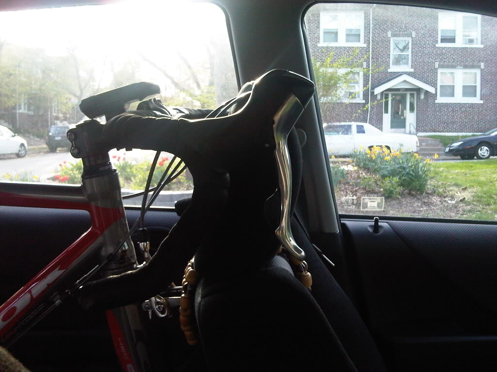

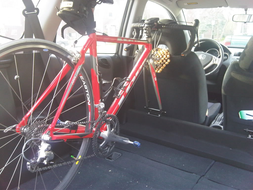

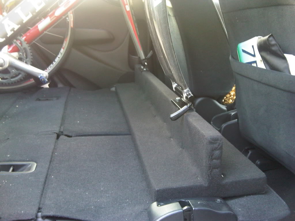

I just got this done. It was a weekend project that costs around $50-60 total, less if you know some people with wood lying around!
I bought two Yakima Blockheads and mounted them to a few pieces of wood.
The base is a strip of 2x10, cut to 42.5 inches long. The vertical piece is a little less than two inches high and about two inches thick. The Blockheads are mounted to another thin piece of wood and countersunk the bolts used to attach the Blockheads to each side. The vertical piece is attached with 2.25 screws. Then, I wrapped the mount in black felt to match the interior, using staples to hold the felt.
I used the elevation to clear the back of the headrest on the front seats. The bikes inside are a 51cm Look 55 and a 53 cm Raleigh Prestige. There is about 2 full inches behind the tires when the hatch is closed.
The bikes don't move and as you can see in the last photo, there is plenty of room in the middle for extra gear.
