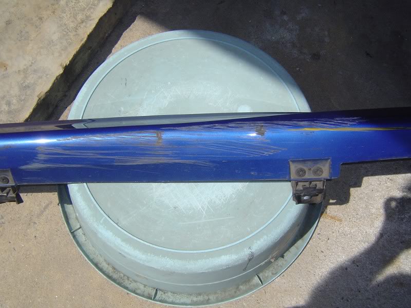

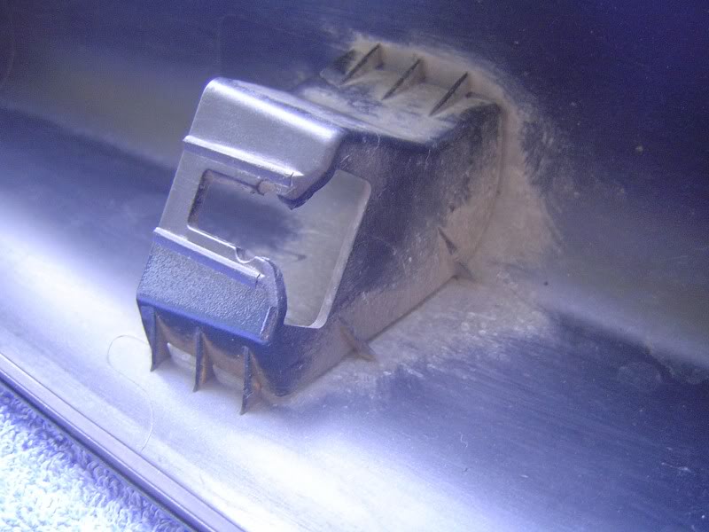

I've been looking to reuse my GD sideskirt that got ripped off by the curb, the only broken part of the skirt is the back brackets that hold the clips.
^ that piece.
I've got 3 out of I believe 8(?) haven't looked at the skirt in a while. I was wondering if it would just hold with the bottom black mount things,
I haven't seen the skirt in a while so I don't know its condition, it's somewhere in the garage.
My question is will it hold with just the bottom black brackets? Without looking too funky and out of place?
I'm sure you guys with the body kits know.

There are several clips that side into the side skirt which allow you to clip the skirt into the chassis of the vehicle. Those riveted plastic brackets in the side skirt itself just uses the black plastic push clip to clip under the car.

You should be able to remove and replace those clips as well. They should come out by grabbing them and rotating them about 45 degrees either left or right (its not specific). Transfer all your new/good clips onto the side skirt, pop it on, and call it a day.

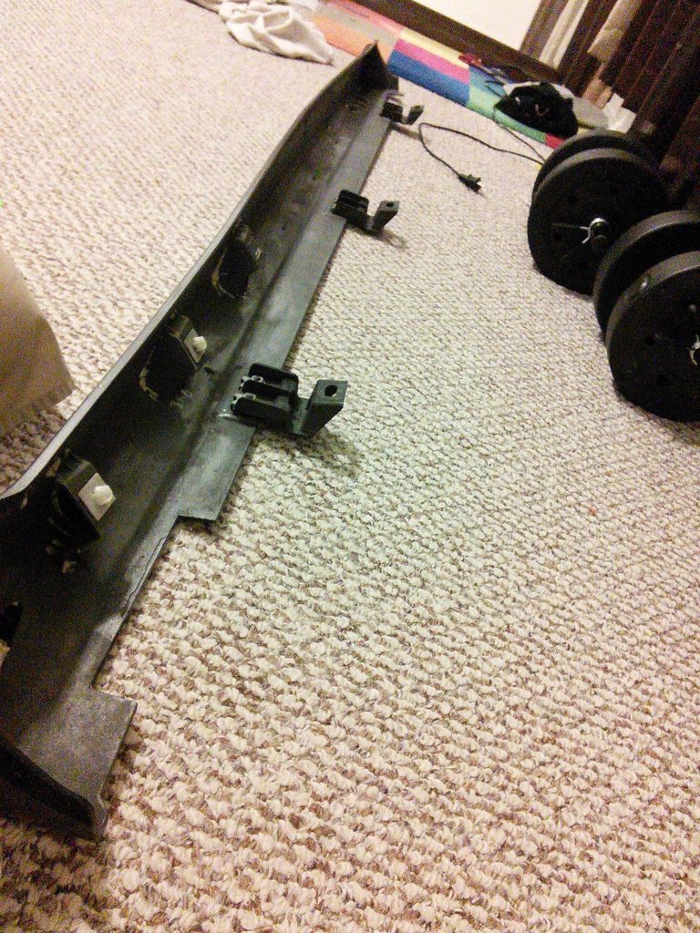

Here's a pic of the skirt's condition on the mounting side. Name:  n5VZiKqh.jpg
You can see the 3 brackets that I glued back on. The other 5 are gone.
