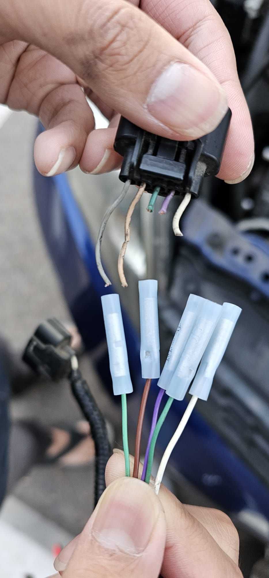

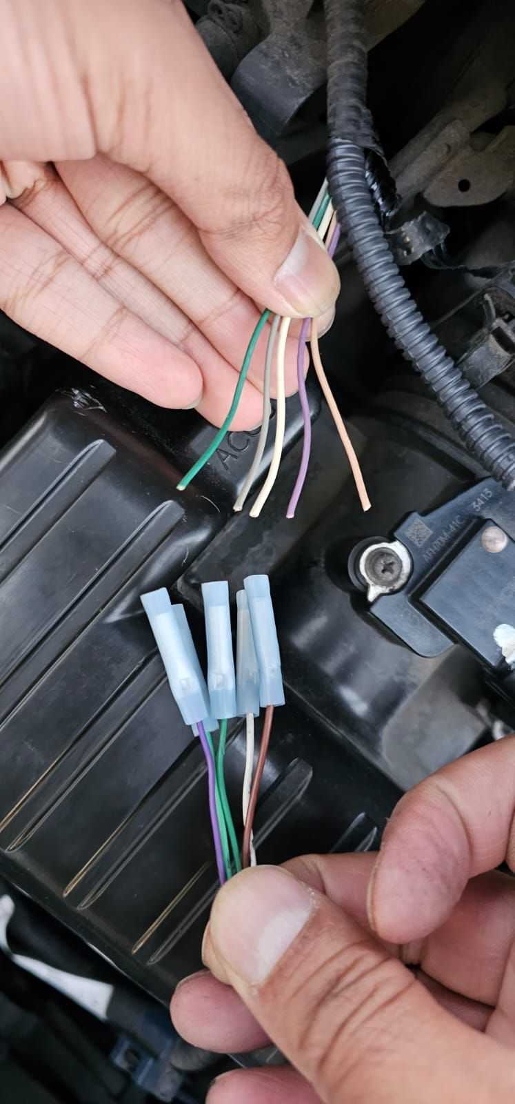

Mass Air Flow Sensor Harness was chewed by animal. I tried to replace it. I got Mass Air Flow Sensor Harness and connected wire with similar colors. Three of them are exact matched but I connected two with similar color coded wire. After this problem is still remain same.
1.Enigie light on
2.Traction control light on
3.Enigine temp "C" light on and off.
So I went to Service center today. And I got estimate of 995.00 with note:
Comments: CODES P0102 MAF SENSOR VOLTAGE HIGH AND IAT SENSOR HIGH VOLTAGE. CHECKED WIRING REPAIRS PREVIOUSLY MADE AND WIRES ARE REPAIRED INCORRECTLY TO WIRE COLORS. RECOMMEND TO SOLDER WIRES TO CORRECT WIRE COLOR FOR PROPER SENSOR READINGS.
Repair Estimate: $995.00
Looking for Any suggestion?
