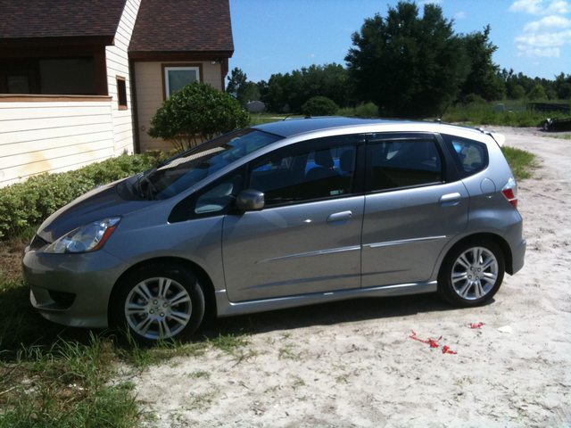

Here it is after all the accessorizing.. still has the red backing from the side molding on the ground
Since I had to install everything myself....
1) Read the instructions completely before beginning, and read a few steps ahead at least when doing each step. I put the rear bumper applique on crooked because of this. It's imperceptible to everyone but me, but when you do this stuff yourself, you'll remember everything you messed up.
2) The thing that is most worth having done professionally is the remote starter. Although, the only two problems I had were removing the visor and the plugs on the back of the fuse box. I've seen another question about removing the visor on here, and I plan to make a video showing how to remove it. As for the fuse box plugs, there is just a tab on the back you need to press in. But, I couldn't see it from the front. Just press the tab in with your finger and the plug comes right out
3) Everything else is pretty much foolproof. If they're charging you any more than you can get the parts for off the internet, it's not worth it. Other than the remote starter, I was able to do everything in a couple hours.
4) As for the wheel locks, the dealer put the factory locks on anyway and didn't charge me. I got the Gorilla System locks (16 lugs) so I figure that having the factory lock and three Gorilla locks on each wheel should be sufficient.
5) For installing the accessories, you really need the blue masking tape from a hardware store, also I got a nice dispenser of big alcohol wipes at CVS. They work a lot better than the crappy wipes that come with the parts.

wow makes me want body side moldings and i usually dont like them and i dont know if they would look ok with the mugen kit???
yours looks sweet!

I dunno if they would look good with the mugen kit, I got them because I was worried about having someone ram a shopping cart into the side of my door.
07 + Honda Fit Wide Body Side Molding
I think maybe this aftermarket molding would look better.
