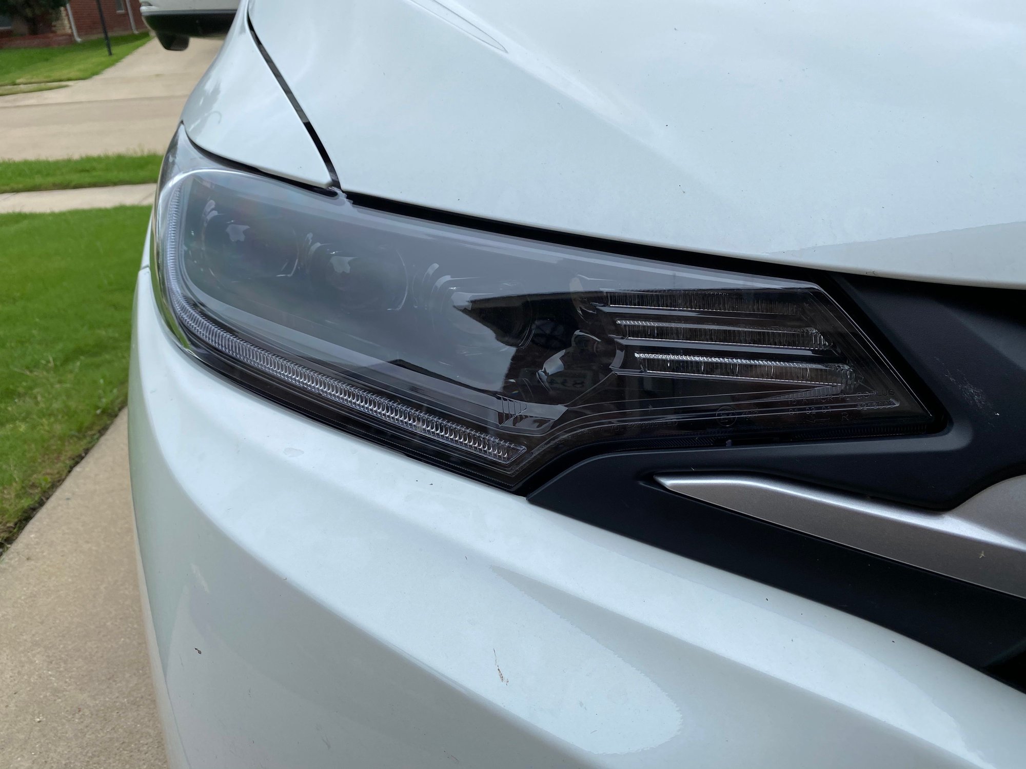

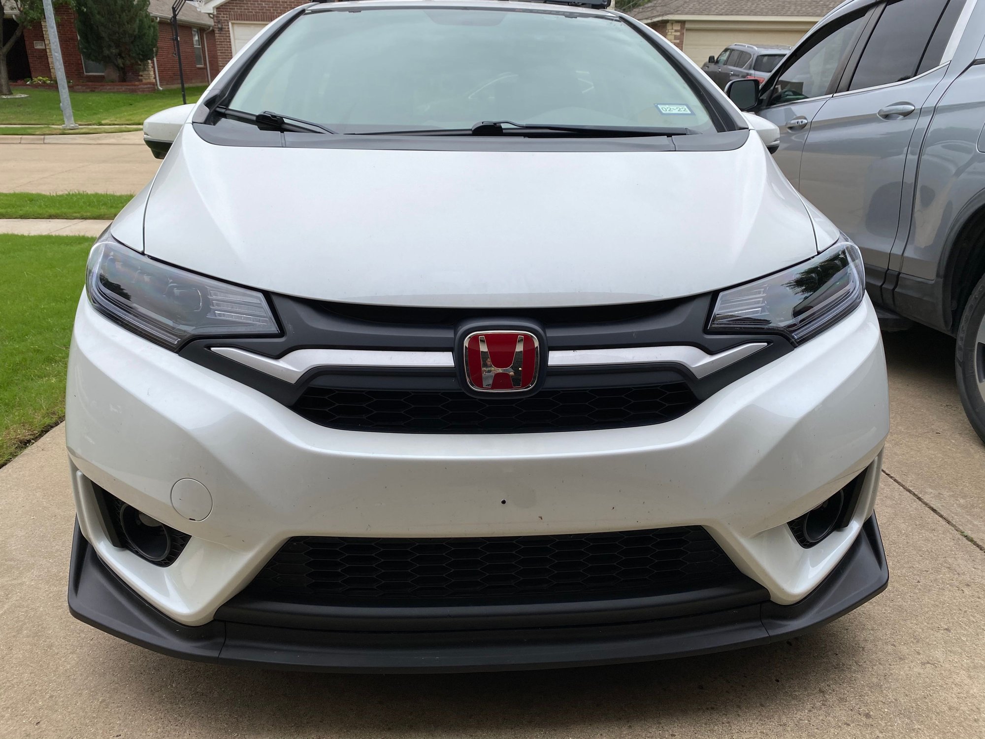

Replacing the whole Headlamp Assembly with a different one!
I have a USDM model. I did A LOT of research before I spent an arm, leg, and a neck on some Bad A** ones from TRS!
The VLANDS DO NOT FIT the USDM Models. The bumpers are different between the 2. Hope this answers all those questions about Headlamp Fitment!

Those babies looking crisp! I got the same ones....how do you turn off the DRL's??? Mines just stay on unless I unplug them from the fuse box.
