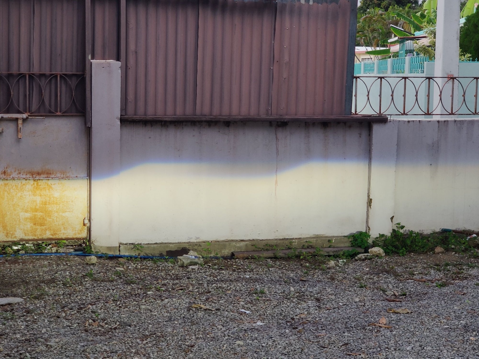

This is an output shot of the MLEDs before sunrise against a wall of what used to be a Blockbuster Video. Notice the intense hotspot where the cutoff lines intersect and how the light decreases off to the right. Not so much off to the left.

This is my indictment of these projectors in a nutshell. While it's not fair to take a shot of them while there was still daylight, note how the left projector's cutoff doesn't reach the right projector. While this is less noticeable the further you get away from a wall, this is how it looks at 25 feet away.

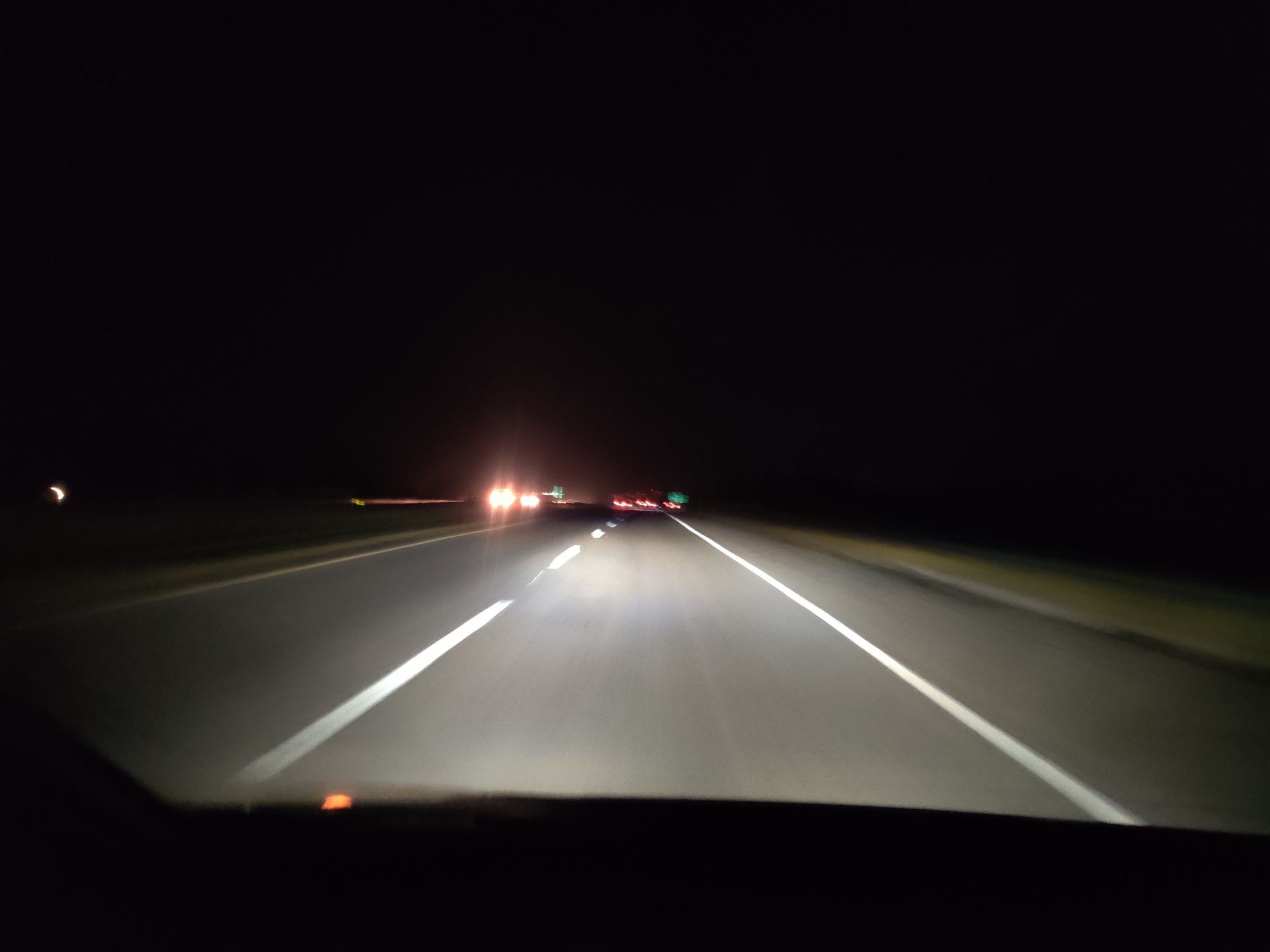

This is an absolutely terrible shot while moving on a two lane highway. While it might not look bad to many, it in fact is quite enjoyable seeing it live, although the color is off from seeing it in person. You can see how prominent the hotspot is compared to the rest of the output. In this setting it's fine, but I was really disappointed that these projectors couldn't have a wider output.
