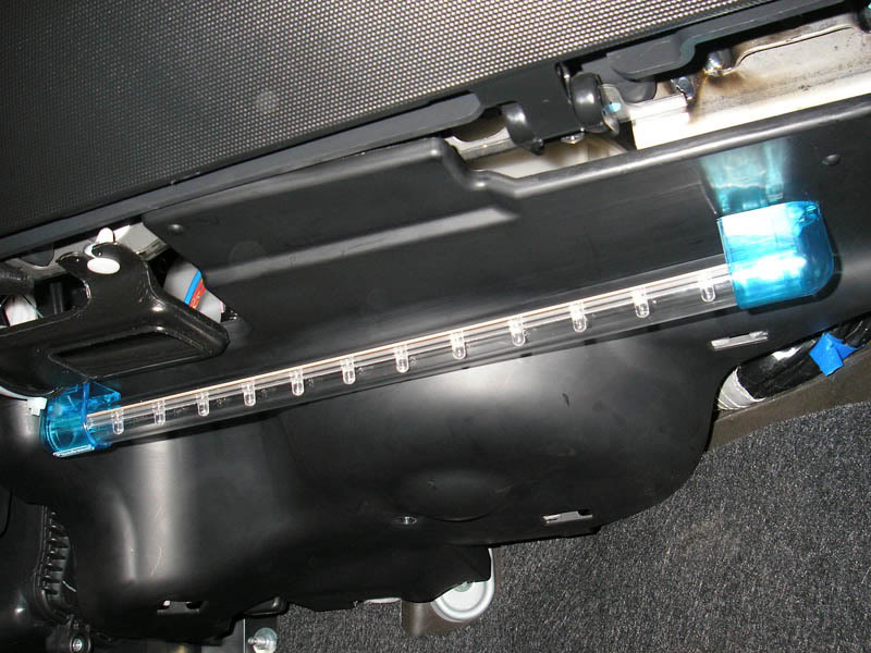

I ordered two LED light tubes and installed them under the dash. The light tubes are hidden out of visibility. I will be adding a switch soon.

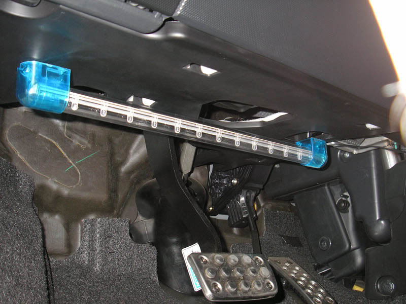

Here is a simple DIY. I will go into adding the switch and making the lights come on when the door is open after I add a switch. The first thing you need to do is mount the lights. Each light tube comes with two tiny screws. You can make a pilot hole for each screw using a push pin. The plastic is thin so the push pin goes through easy. Here is where I mounted the lights:
Keep in mind that I had to hold the camera at a very low weird angle to see the lights. The light tubes are not visible at all when inside or standing around the car.

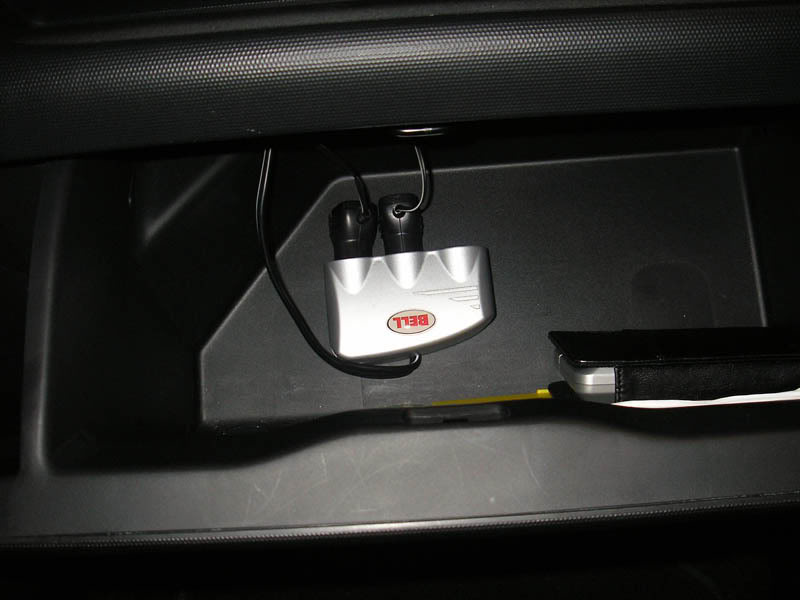

Then I bought a splitter for the ciagarette lighter power adapter and double stick taped it to the inside of the glove box.

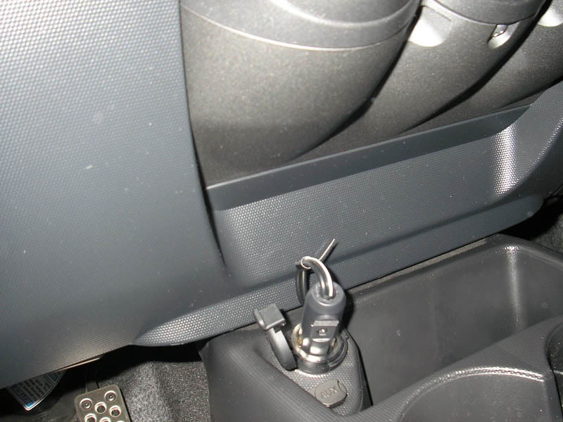

The wires are hidden behind the dash and plugged into the 12v power source.
