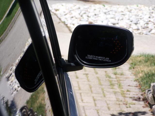

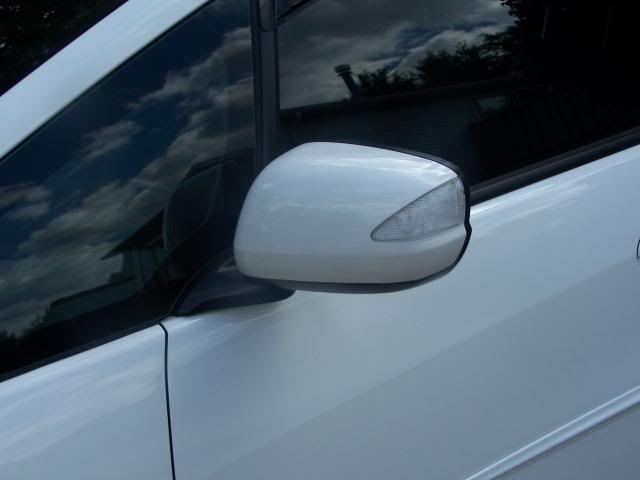

Attack the mirrors instead. I added the arrows behind the glass and changed the covers to winkers.

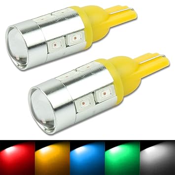

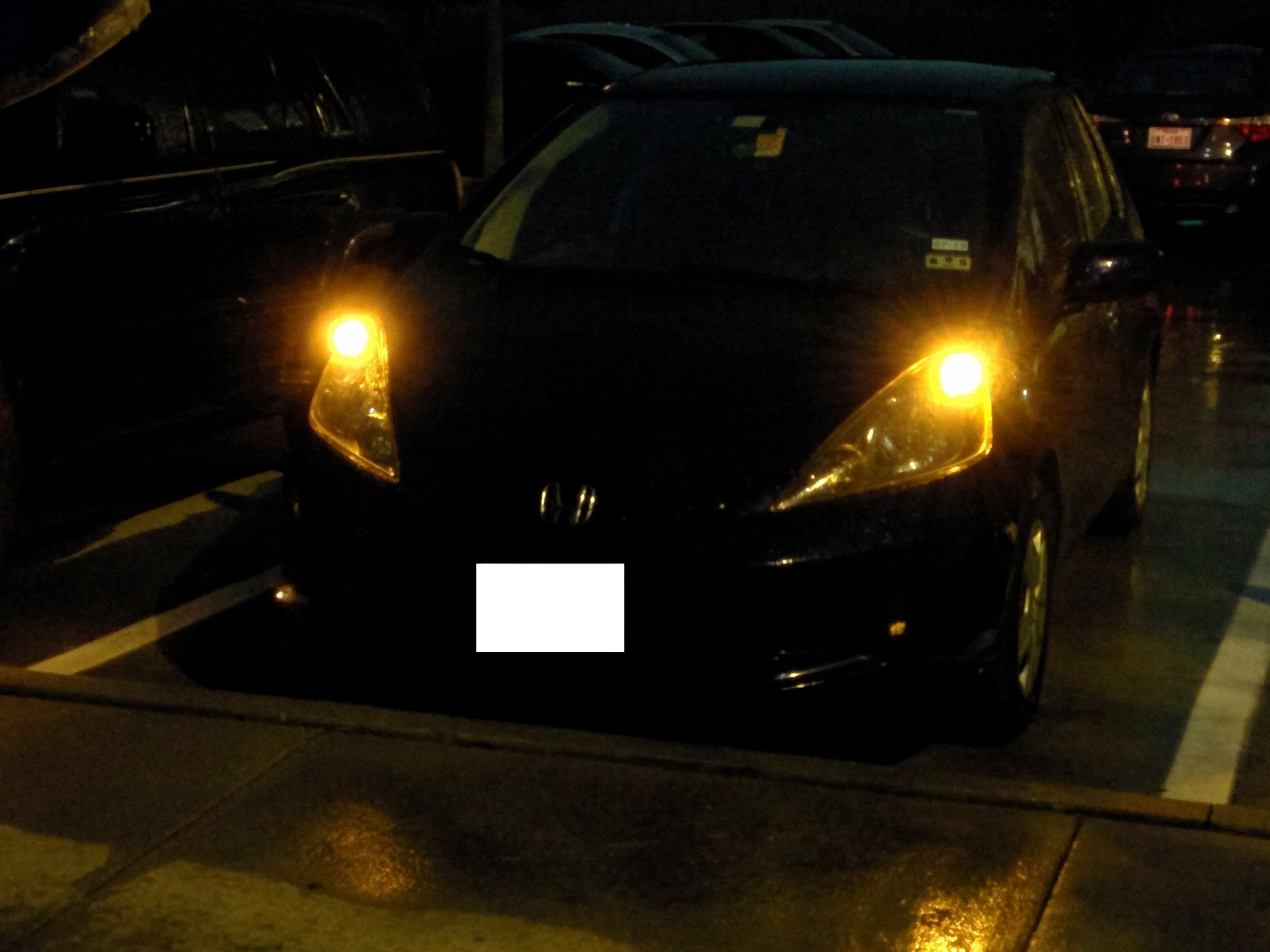

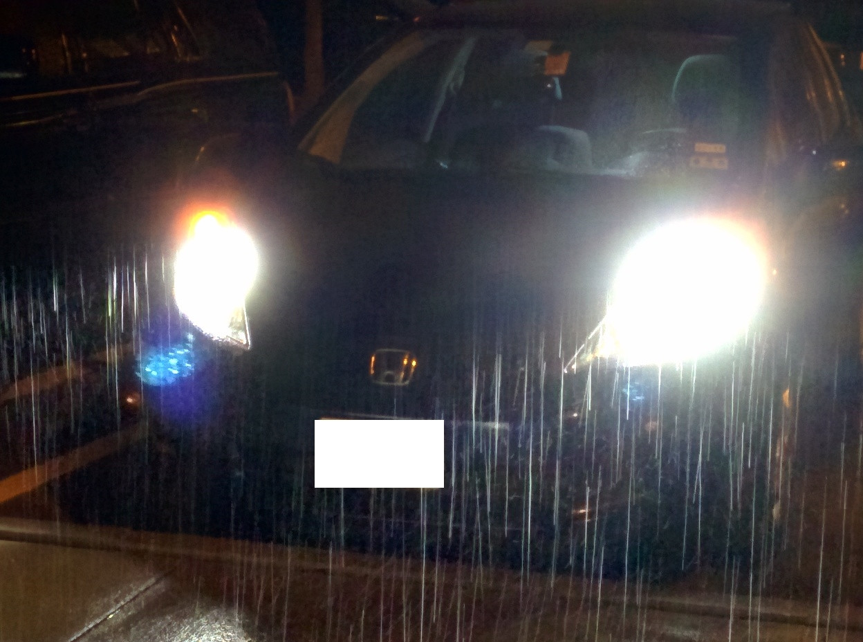

Hey, sorry for the late response. I've been busy lately. I currently use ones that look like the ones below. They can be easily found on ebay for around $5-$10 if you search for "t10 cree yellow".
I have no complaints with these bulbs. They look much longer than the OEM parking bulbs, but they do fit. They're also much brighter. I just took some pics.
Sorry about the bad quality on the second pic. They parking lights are actually much brighter than that. The camera couldn't adjust due to the brightness of my headlights.

As for the parking bulbs, I've posted pictures my previous post. You can find them on ebay if you search for "t10 cree yellow". They're inexpensive, around $5-10 for a pair depending on what kind you want. They fit well, haven't had any problems with them. I'm not sure how much heat it produces, but not enough to burn them out or cause any melting because I've driven at night for several hours before, and they worked like a champ.
