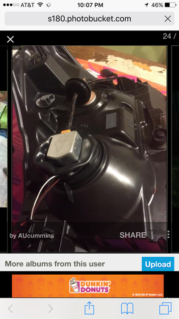

I'm just wonder guys, what are you guys doing with the dust covers on the back of the headlight. The d2S igniters are too big and bows out for the OEM dust cap to fit even if I trim it. Any recommendations? Would this work?

It looks like those could work? I don't have any cover on mine and regret not putting something there. Even though my headlights were sealed from the outside... moisure can still condense on the inside when it's humid out, and cold outside, similar to how moisure condenses on your windshield. So I do recommend sealing it. And it's probably best to put in your bulbs on a dry day, so the air that stays in there stays dry. I should probably seal mine... better late than never...
I kind of have a better solution...
What do you guys think. It's not on the fit but with the same idea....
