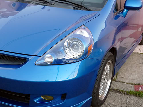

Overall the retrofit was not bad. The only thing that sucks is that on the driver side there seems to be crud on the inside of the plastic lens, meaning the only way to clean is the take the lens back off.
The two pictures compare beam patterns and the camera was on the same setting.
P.S. - Don't forget to take back out the cardboard from the oven when warming back up. It makes the house stinks for days when it catches on fire!
Thanks TRS for the awesome service and great product. Finally a retrofit for H4's that doesn't require hacking!

Rotational aiming wise, not much, rather none on the TRS Mini with H4 adapter. This is good and bad, with the adapter it is slightly off on the passenger side because the adapter ring locks into place using the H4 bulb slots.
I decided to not mess with it since it is only slightly rotated up towards the passenger side (counter clockwise 1-2 degrees looking through the windshield) where it doesn't effect real world driving. Only those wall photo shots.
Of course vertical adjustments need to be made.

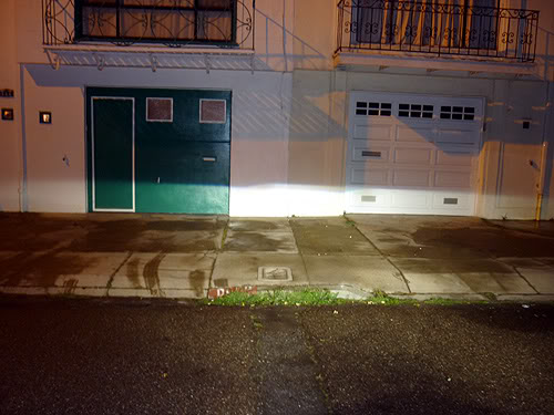

As promised beam shots.
After looking at beams further I think the rotation issue is exaggerated due to the downward slopping cutoff on the left side.
I am running DDM Tuning D2S (35W), but I think I might switch to 81522+ to increase brightness.
If you also notice the last pic is compared to a stock 350Z. The underexposed picture show the difference in brightness of the factory Z, but mini's are still not bad for being so cheap.

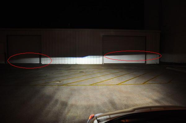

Great quality pics. In this photo below, which is supposed to be the "correct" side? The left drivers side doesn't look right to me due to the slope... The right side looks more favorable since it's a higher even beam, but it does slope upwards at the end.
That is how the projectors are supposed to be! The right is higher so it lights up the side of the road and to light up signs etc... It's known as a "step". The left side is lower as to not blind oncoming motorists! In Japan,UK the projectors are opposite from the ones pictured since they drive on the opposite side of the road!
I know that much. But here's where I'm talking about. I guess some "sloping" is normal, but the left side looks a bit exaggerated. I'll let you guys know how mine turn out when I get them later this week.
Compare to the MiniD2S cutoff from the HIDplanet thread below.

Looks to be doing the same thing to me just not as much! It could be the way the clear part of the housing on the ge8 is shaped that's causing it to bend the cutoff thus making it appear different from the photos on hidplanet.

The rotation does seem to be a little off. I have the h1 morimotos and I had to tweak the cutoff shield to achieve perfection.

Nice job. Another fellow Fit owner who converted to projectors. I did a write up for the GD3. It should be the same for the most part installing the projectors. No cutting necessary unless its the shroud. Other wise everything fits perfectly and you just need to aim the lights up. I added some slim washers which gave me a little more color at the cut off. Best easy upgrade you can do to your headlights without getting the projectors which fall short in output. I do have to let everyone know that the projectors are skewed a little bit. I didn't notice it until I put everything on my car and closed up everything. But its only 1-2 degrees off. If your anal about it you can grind a sliver off the H4 adaptor to rotate it correctly.
My cut off

The Apollo shroud does float but it is not noticeable unless one looks for it or possibly unless one is thinking about painting the reflector black. Also the shroud is large enough so none of the projector is showing.
I think the sloping is caused by the highlight cover like someone pointed out. The pictures of the other persons Mini's seems to be not installed in a car. The driver side project cutoff is dead straight in the middle, only the passenger side one is off a little.
On a side note, I ordered some Osram 66240 from TRS.com so I will get pics comparing the output to the 4500K DDM Tuning D2S's.
