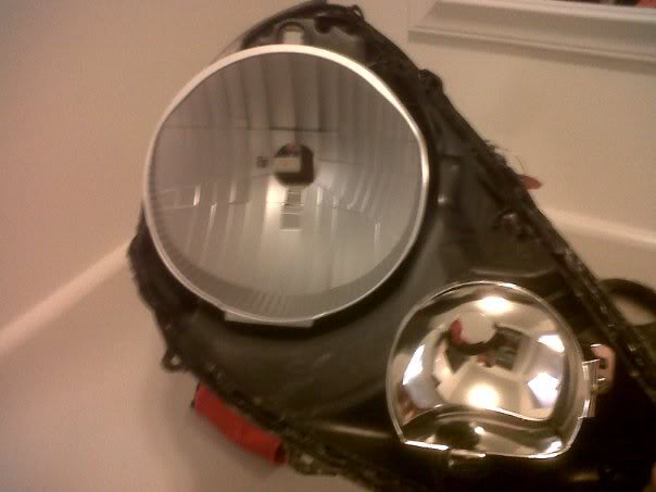

Basic mini retro... I am using ddm ballasts, Morimoto D2S 4300k bulbs, Mini D2s projector and TRS harness...
I painted the headlights JDM black, I used the apollo shroud some slight trimming was needed.

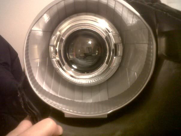

Mini D2s and shrouds

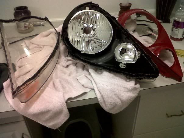

Painted the reflector silver to reduce glare but still have an oem look

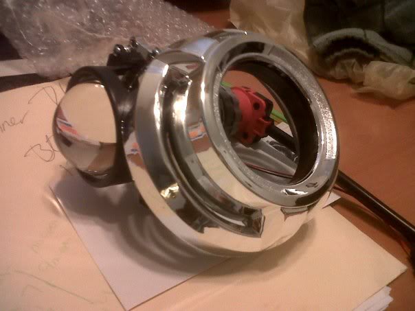

The projector and shroud mounted

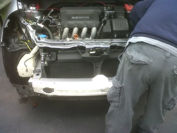

Remove bumper and lights

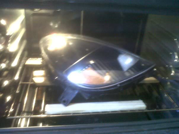

Seal them up I did 250 and 8 min but everyone has a different idea on this one.

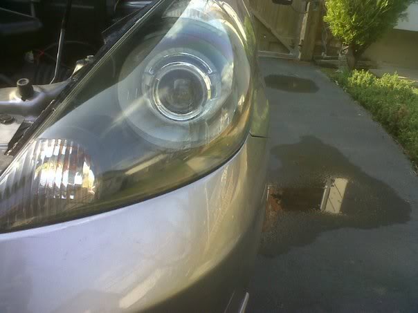

Here they are mounted...

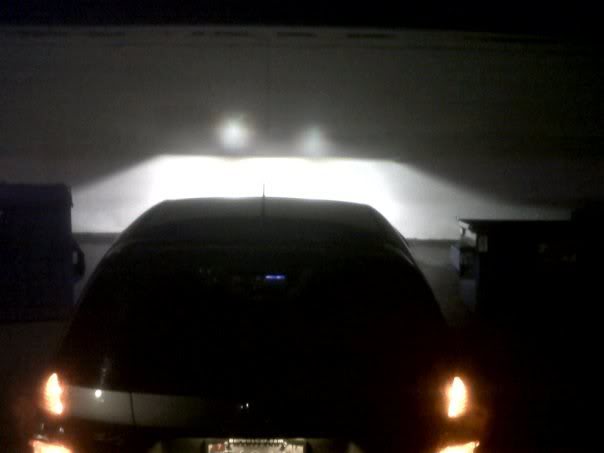

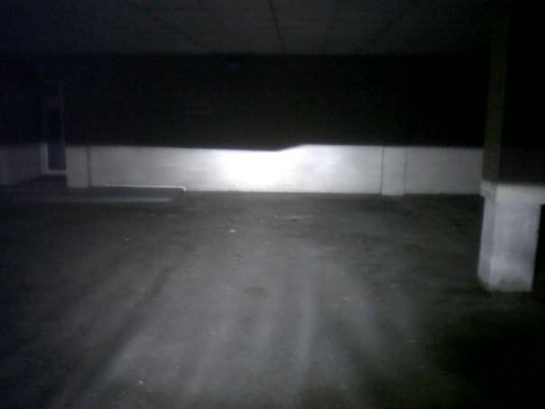

Low beam and high beam output pics from 25 feet. The parking lot was on a slight slant, and the hot spots above the high beam are glare off of the shield... They are a tad wider then the pic there was a dumpster to my left

There's just something about putting the headlights in the oven that I feel iffy about, but if I'm confident working on much more integral parts of the car myself then I don't see why I can't do this. Just need the cash as usual

Koi - What I would do is set your oven for 350 degrees and put the headlights in for 4-5mins. Take them out and try to pry them open. If you can't do the first time put the headlights in the oven for 1-2 minutes. It takes a lot to melt the headlight. As long as your careful it should be fine.

To add to what danger said make sure none of your brackets are touching the rack and work with the lens down while opening... The brackets are real easy to bend and break!!!! Ask me how I know lol

i would also say turn off the oven while the headlights are in! just heat it up to yuor perferred temp and shut it off, the last thing u want are melted headlights!
