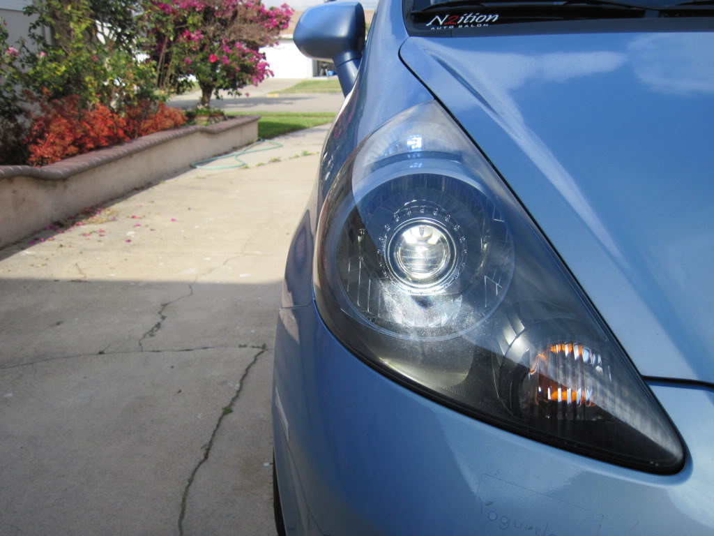

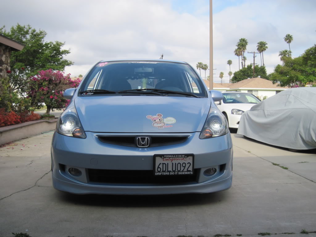

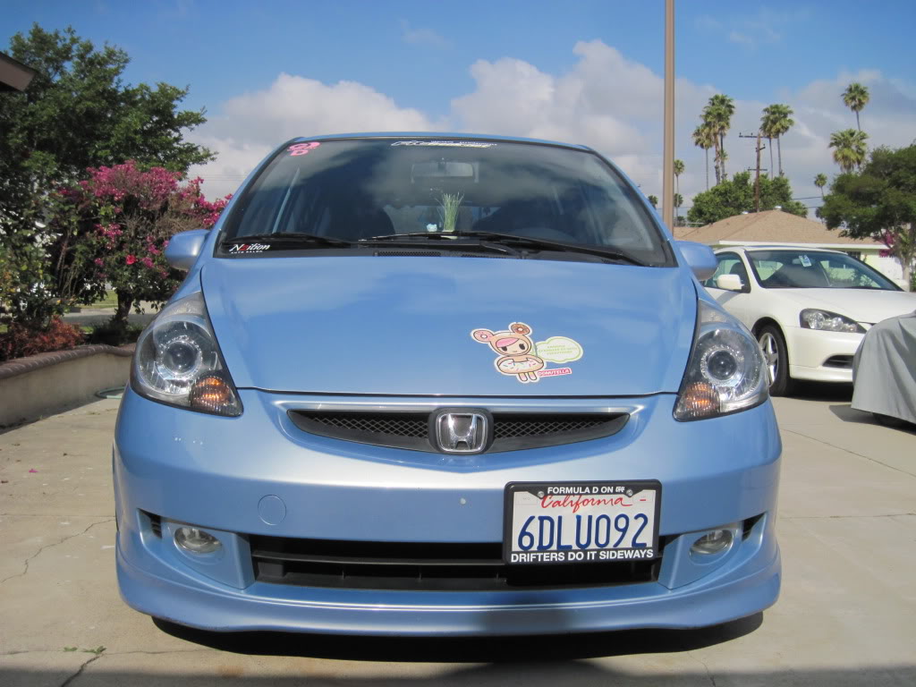

pics are in, no nightime cutoff ones though, dont wanna see them anyway.. it's off. haha YES my car looks like a frog/crazy person

Looks pretty good there. Always liked those shrouds and had them on my 8th gen Civic, too. Next is to show the night shots!

looks great jason. all you need now are some cutoff night shots after you finish the rotation and alignment.

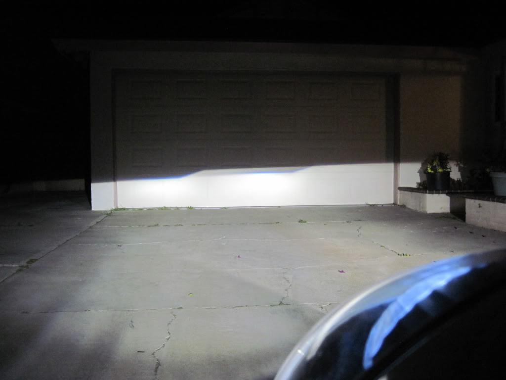

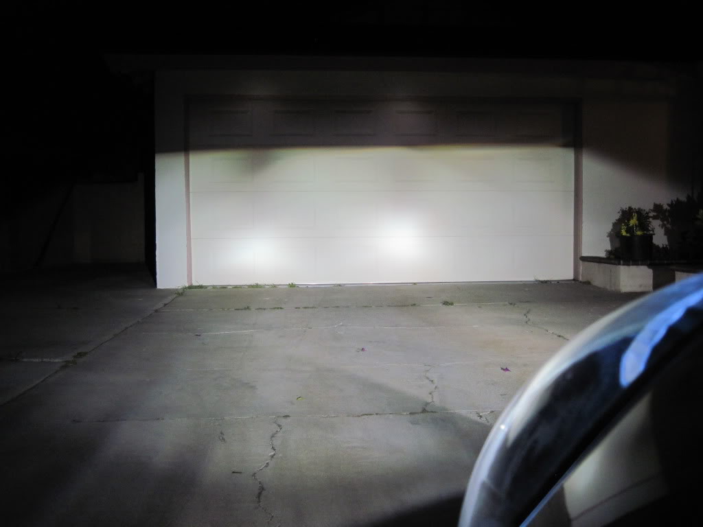

i'm too lazy to readjust them, the right side just tapers up a little on the far right and down on the left, it's not a big deal. Really sharp cutoff though. If you want I'll just step outside and snap two pics really quick. haha

sorry they're not DSLR Perfect, my double-A powered point and shoot will have to suffice There's slight slight glare as you can see above the beams but I just drove in front of my car in another lowered fit tonight and they're nice, no annoying hid glare at all.

the blue cut-off isnt THAT noticeable in real life, but it is a little noticeable, it's a nice touch

That isn't too bad at all. Depending if you're on a level surface, I'd line them up a bit.
Overall, good job!
