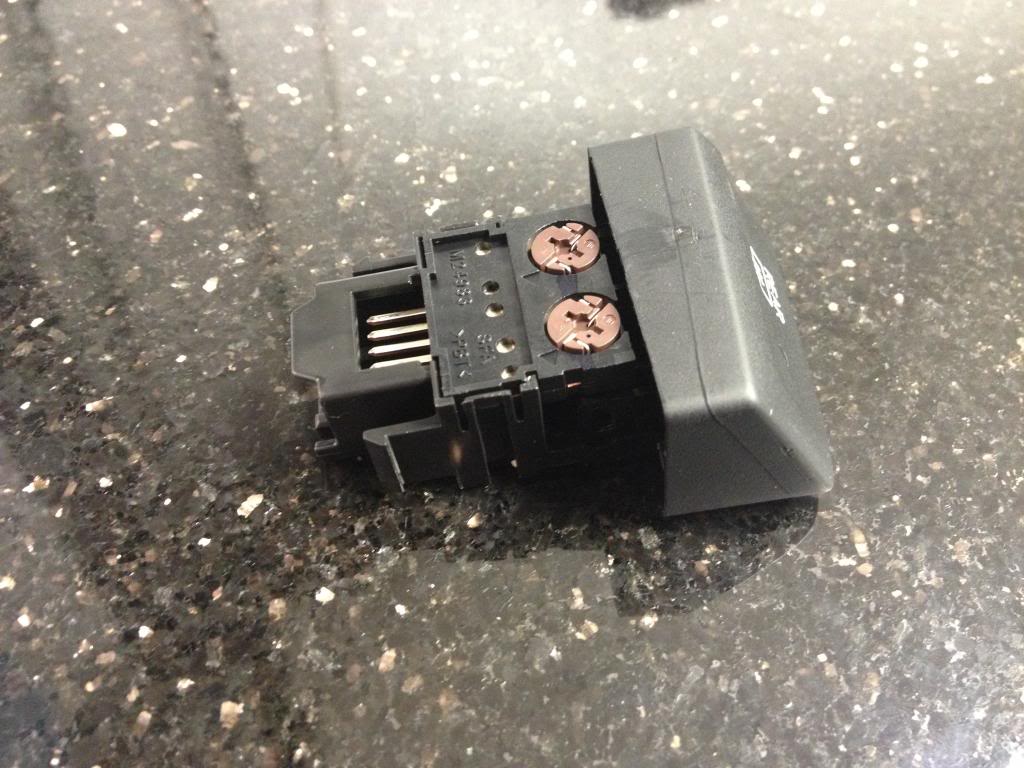

Turns out one of the 2 LED bulbs doesn't work. The bulbs are under those screws.

Sorry about photos
I'm sorry but I'm having difficulties posting photos on this site.
Yes I ordered 2 bulbs from the Honda Dealer (their service dept helped me find the release tabs on the switch.) The bottoms of the bulbs look like screws.
They are 2 different colors. Yellow and Blue. This produces the green light. I have other photos I hope to post that show how I can tell at least 1 of the bulbs is out and details on how to remove & etc.

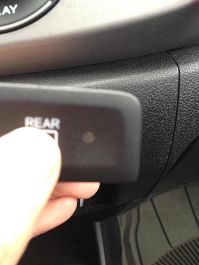

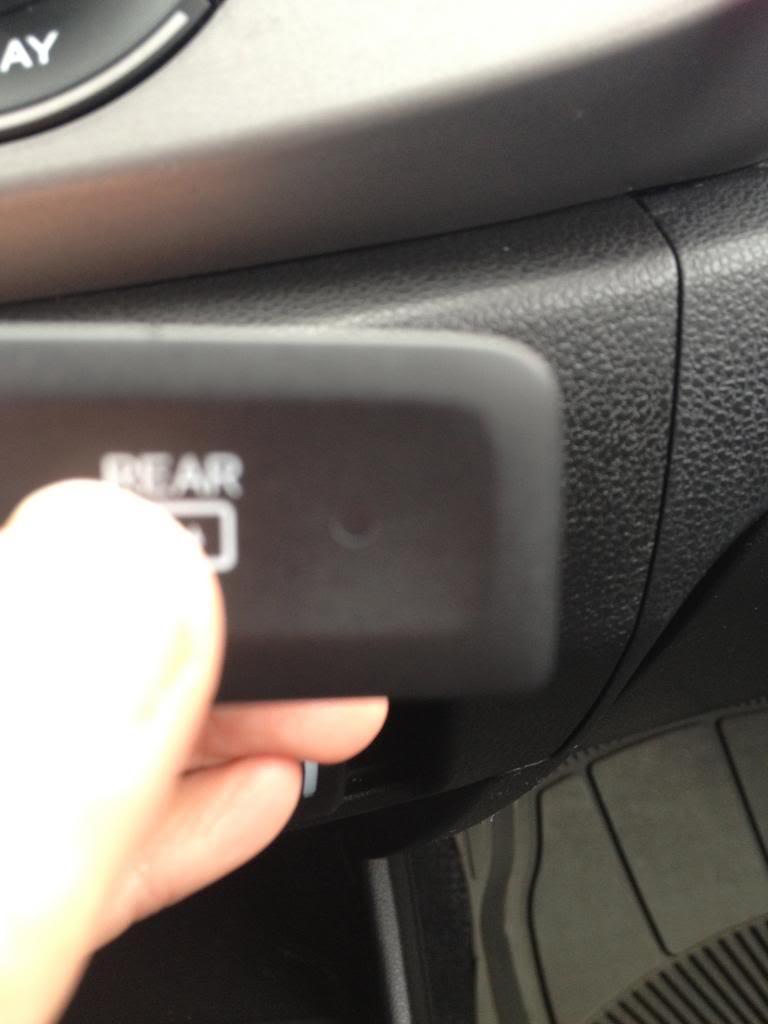

Photos?
on
off
Should be bright green
