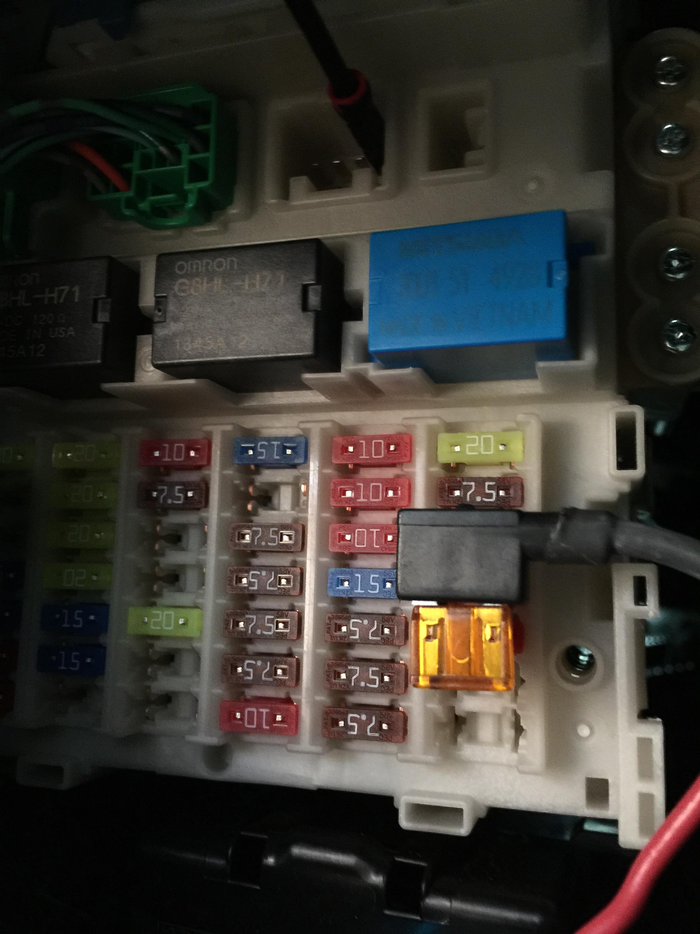

Ok so tapped into the power pin for the dome light. LEDs are wired to middle post of switch, wire from some pin is on one of the other connections on the switch. Haven't put the 12v constant in yet I ran ground to negative battery terminal since I couldn't find a suitable ground point. So the LEDs are not working with the dome light....if I switch them on they are just always on until I switch them off.
I picked up an illuminated switch, this has +, ACC, ground. Is the illuminated switch the problem? I know I'm missing something just not sure what.

I'm guessing that the ground pin for the dome light regulates the on/off and fade for the LEDs and since I'm not tapped into that at all is why my set up is not working....
What if I did this a bit differently...is it possible to wire led + to constant 12v, then (and I'm sure an illuminated switch is not appropriate for this project, I'll have to get a proper 3 prong on/off/on switch) - from LEDs to middle prong, - from dome pin to top prong and ground to frame on third prong....then it simply controls what circuit is completed?
