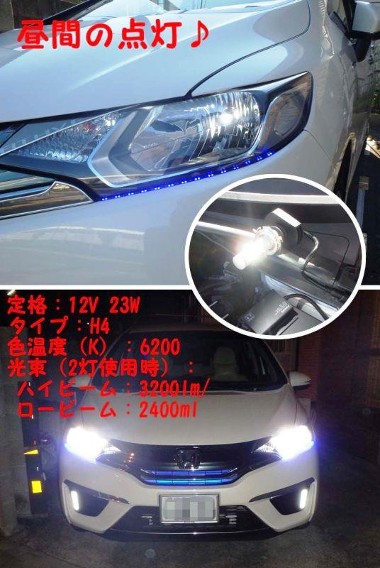

here's a pic in the GK headlight..
no output shots though..
diy with the install process
PHILIPS X-treme Ultinon LED H4?????? ?????d(´??)b??fit3/HONDA?Maintenance Handbook???????Minkara - The Car & Automobile SNS (Blog - Parts - Maintenance - Mileage)
(need to translate - use google chrome)
*edit - found pics of it on in the GK*

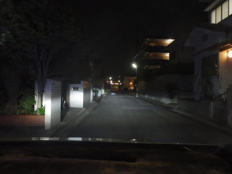

some really good pics and blog comparing the led to regualar halogen.. my only thing im trying to figure out is DRL.. otherwise i may pull the trigger and try them out
the blog (need to translate):
?PHILIPS X-treme Ultinon LED H4 ?????? ?????????...??????????????????!!???v?????????????? ??????? Always Going My Way ??Blog???????Minkara - The Car & Automobile SNS (Blog - Parts - Maintenance - Mileage)
GK output pic:
and why I think they will work well.. placement of led bulbs look spot on with H4 placement... and the led's are small to mimick halogen sizing.. just need to figure our DRL

Sorry to bring this back up. I have a pair on GE8 and here's my opinion.
Installation is very easy. Take less than 15 minutes. It will light up right the way, but driving during daylight hours the DRL warning will come on due to low wattage.
At night, there is a different story. Comparing to halogen bulb, this LED (fitted to stock DOT VOR headlight), the lights are scattered. Lots of glare right above the hot spot. Otherwise the color is very white. Have TRS LED fog and these LED is not as "blue" as the fog. I would want to post some pictures but have not yet been able to. Hopefully I will find a night to drive around and see.
Probably these LED are better suit for ECE lamps rather than DOT lamps (especially DOT VOR lamps).
