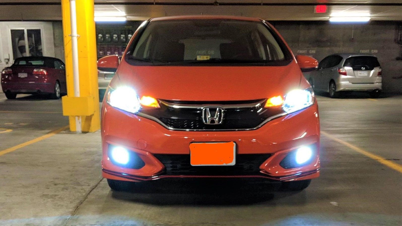

just wanted to share my latest mod on my 18 sport.did the headlights and fogs.
both with kensun led kits. 6k top and bottom headlights need to be aimed as well

Noice! Was it a toUgh install or quite a bit involved?

it was pretty straight foward.but you have to jack the car up on the bottom to do the fogs.
i took it to my boys shop and it literally took 10 minutes. you do have to cut the dust covers
in order for the led fans to breathe definitely need to align the lights afterwards.they are
really bright as well lovin it thus far!

Can you go into more detail on the exact kit? I see kits for $40 and $100 but they seem identical .. the more expensive one has anti flicker resistors already ?
The cutoff looks good but i dont see any housing on the pictures of the bulbs, did you do something with your existing headlight housings ? DRL still work ?

I used a "fanless" set of LEDs for my conversion and didn't have to alter the dust covers. They DO serve a purpose.

these are the exact ones in the links provided
https://kensun.com/collections/led-c..._eti_led_chips
https://kensun.com/collections/led-c...ith_cree_chips
i pulled the fuse for the drl's no modifications to the headlight housings

i know those led's all headlight led bulbs need air of some sort so that the bulb can be cooled
doing that way the blubs life span is much greater than the other that does not have any circulation
trimming the dust cover to let the fans do its job is not an issue esp when the kensun bulbs are
completely waterproof and the dust cover has a tight snug on the bulb so that no water can get
into the housing whatsoever

The lamps I use have large aluminum heat sinks in lieu of fans. The heat sinks are sufficiently exposed to cool adequately.

Water has entered and accumulated in the right fog light. Can someone tell me how is that possible ? Thank you

is the fog light inserted properly? meaning that if there is any gap between the light and the housing,it will cause water to enter.

I have not changed the fog light. I don't know if precedent owner did it. The fog light where water accumulated is still working. The other fog light is not really visible because it looks like mist or don't know what exactly has formed on the inside glass. This one is not working.

then try to take the entire assembly out.make sure there are no cracks,leaks,etc... dry the entire housing and go from there.
