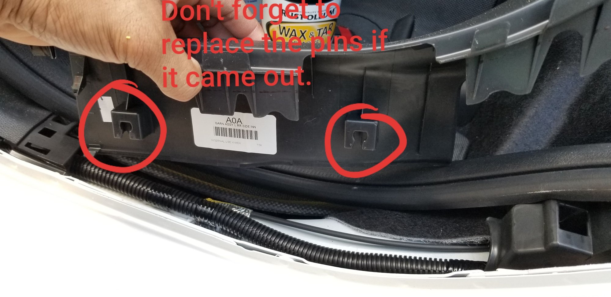

Start by removing the glove and lower trim panel. Super easy.
Route cable behind head unit.
It might help to remove USB/12V outlet panel to help guide plug and drivers side connections.
Don't forget to replace the pins if they get left behind in their holes on the sheetmetal. Trim pieces are super easy to take off.
