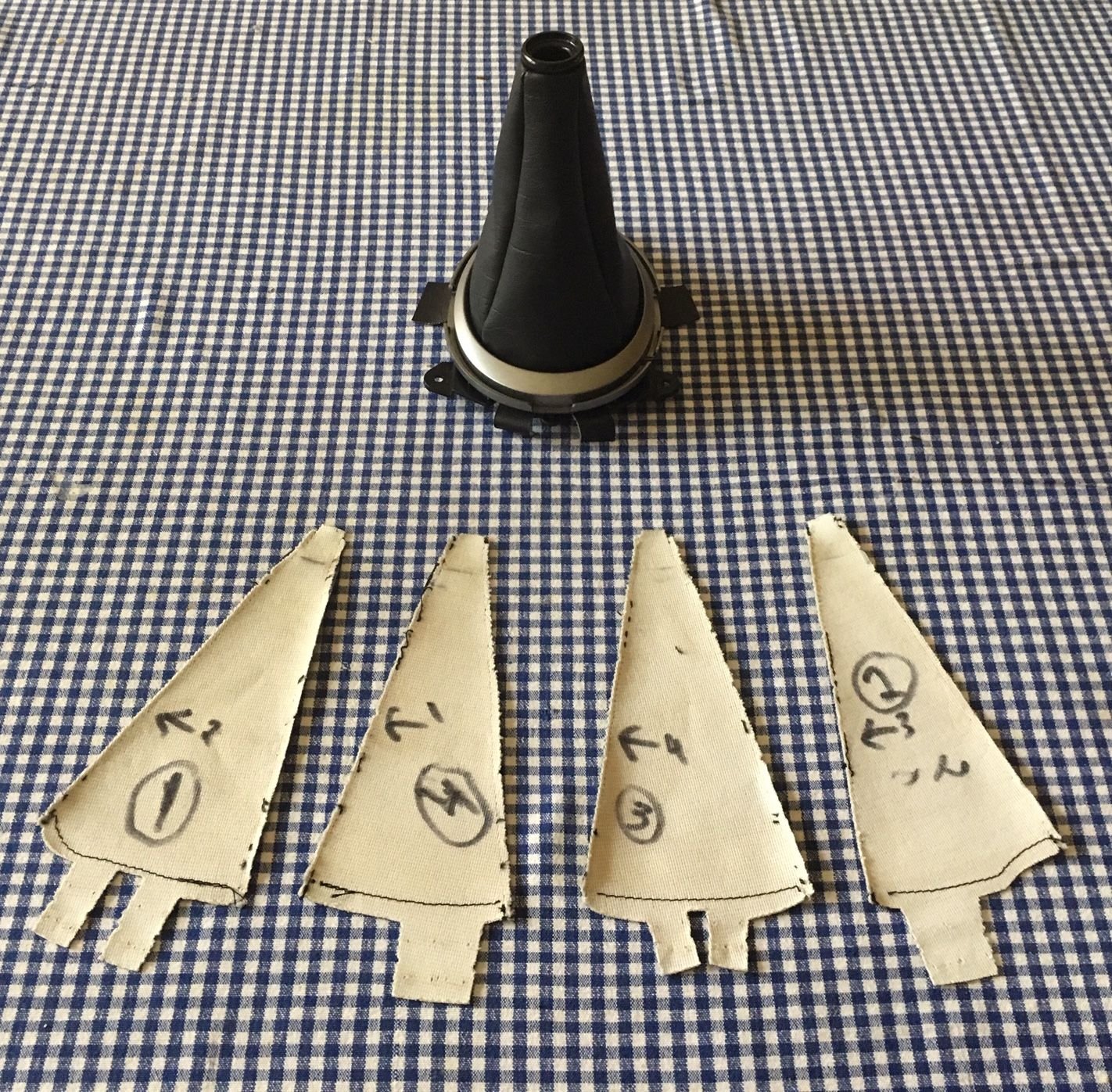

Did this just for the hell of it to see if I could operate my mom's sewing machine. Came out very well, I think. OEM boot was damaged (in less than 35k miles) during stewardship of original/prior owner. Took it apart to use as pattern and purchased $5 worth of material. Figured it would take a couple of tries but I seem to have gotten it on first try. Sewing up new boot after cutting materials took about 10 minutes but tearing apart old boot carefully and ironing old material flat took about 45 minutes. Was it worth it? Well, this boot material is superior to OEM and I now know how to operate, albeit to a limited extent, a sewing machine. Ha!

Newly constructed boot in background; old boot panels in foreground.

That is a fantastic job. Prepare for lots of requests from others with torn/worn boots!
