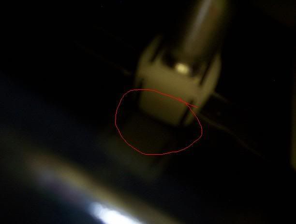

HEY GUYS
OMG it took freakin 2 hours
cuz i couldnt get cable A out
but i did and when i was installing the short shifter adapter i lost 2 of the allen screws
i was wondering where i could get some do you think a local hardware store may have then
and also i just installed 2 of the screws and was playign with the shifter and i noticed when i shift into 1,and 3 the lower part hits the back wall
Old Oct 14, 2007 | 08:22 PM
  #56
Mr B's Avatar
Posts: 214
From: Arcadia, CA
I'm not sure about where to get allen screws so small, but you can contact H-Fit to see if they'll be able to get you some spares. I also don't have a problem with it "hitting" in 1st and 3rd? Could you perhaps take more pictures and maybe ask H-Fit about it?
Cable A is easiest to take out if you have a crescent wrench for leverage and gently turn it counter clockwise.

about the screws H-Fit has nicely sent me an e-mail saying they would send me a few, and so far i assume that i may have not tapped the adapter in with a plastic hammer or soemthing
so i will double check on that
and yeh cable A was a B*tch to pull out i just used some leveage
and im not sure how to pry cable B out ahhaha it seems stuck on to me
i didnt want to brake my flat head
any advice on taking that out???
what i did was take cable A out and just flipped over the shifter assembly
=] so yeh im just ognna wait for the screws to come in and redo everything

You definitely need to take the assembly out so you can securely hold it while you pound in the H-Fit. Well, not pound it in with a hammer but more so with a mallet or something to soften the blow of the hammer. I told you it was a pain. I'm also guessing your hitting in 1st and 3rd might be because it's not fully in either.
The instructions told ya to get the metal clip off of cable B. I had zero trouble with that one so... I dunno where you're stuck. Maybe calling H-Fit may enlighten the matter.
