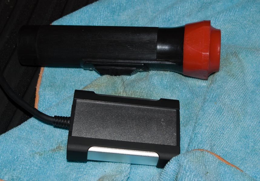

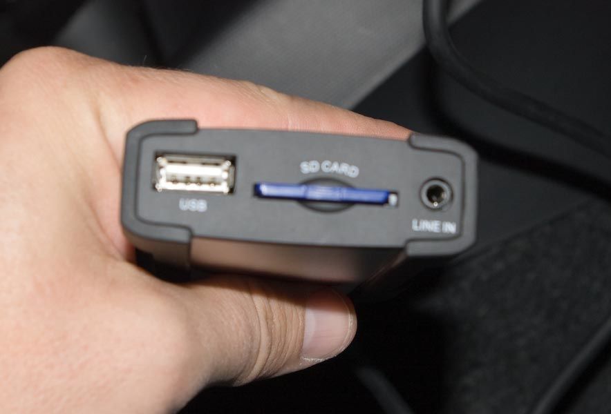

As promised, here are the pics, click to download a larger version. First, two shots of the unit to show size and features.

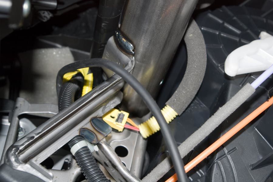

This shot shows where I had to reach my hand and run the cable. The player cable is the dark one running diagonally from upper left to lower right through center of the shot. The large steel tube is a structural member running across the vehicle. The hole is hidden by the tube and I couldn't get my camera up high enough to get a pic, but it's there.

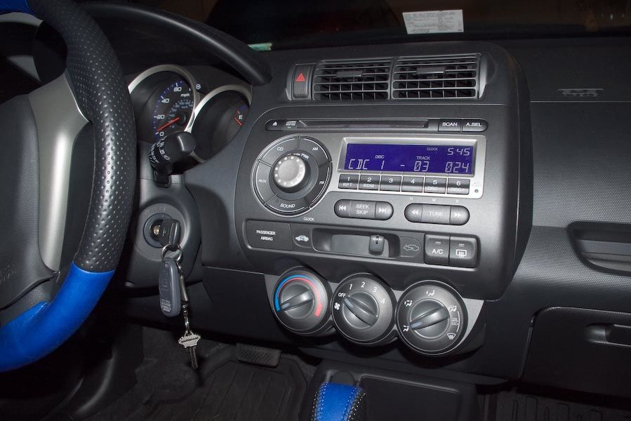

And finally, proof positive that this thing works. Note the unit doesn't put song titles on the stereo screen, only folder and file numbers.

- no separate power light but a light is visible through the Aux port when powered on
