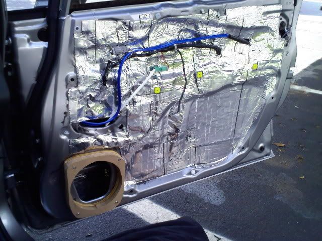

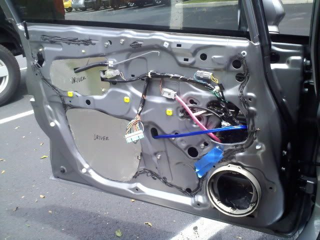

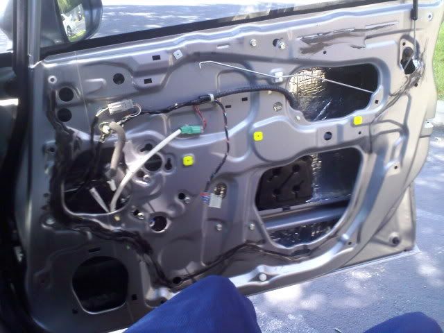

I used Second Skin's Damplifier and would highly recommend it Sound Deadening Materials for Noise Reduction from Second Skin
here are some pics of what I did

I couldnt tell you what made the most difference but overall the car was much quieter. The doors now give a nice thud when they are shut. I used about 60 sq ft total
nice job, how thick is your baffle and is that MDF? Does the door panel give enough clearance with that thing?

mike410's Avatar
Posts: 620
From: Ft. Lauderdale, FL
its about an inch thick and the door panel just clears it but I have removed some stuff from the door panels. I tried 3/4 inch mdf first but the speaker was still hitting the door

Originally Posted by guitar_trance
Did you soundproof the inside of the door panel (the back of the actual exterior skin -- we can see it near the top, through the panel holes) as well as the inside part we see? Or is that slight/minor insulation from the factory?
Just curious.
Yeah I did both the inner and outer skin of the door
