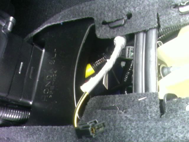

I'll find out right now
Old May 16, 2006 | 10:12 AM
Fillmatic's Avatar
Posts: 66
From: Chula Vista, CA
Originally Posted by b17gsr
Ok, according to the online manual on
I can't find the damn cable. Someone with a US base modle should check to see if there's a loose plug under the console near the cigarette lighter, I wouldn't be surprised if it was there.
Negatory on that one.

Fillmatic,
From your photos it looks like there might be a six-pin vehicle connector where the aux. jack harness would connect to...Can you just double check for us desperate base owners who want to use the Civic Aux part?
If it's really not there, my guess is down the line at some point Honda will eventually offer it for the Fit.
