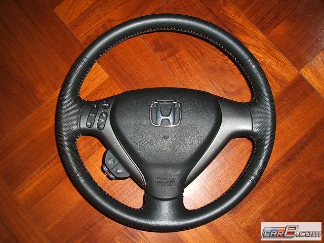

Old Feb 8, 2010 | 06:11 PM
  #120
SNOWFIT's Avatar
Posts: 157
From: Calgary
Originally Posted by b17gsr
This is a better version with bluetooth...found this online would like to share with you guys
