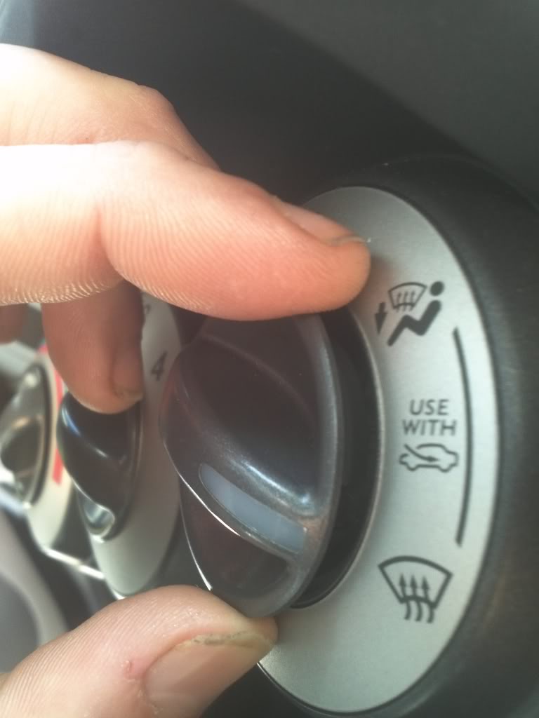

I used a very small flat head the first time. I just now did it with both hands using fingernails. It snaps in beyond that it slides right out.

then use the tiny screwdriver and gently pry from the notch inside the ring. Hope that helps

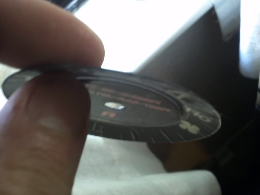

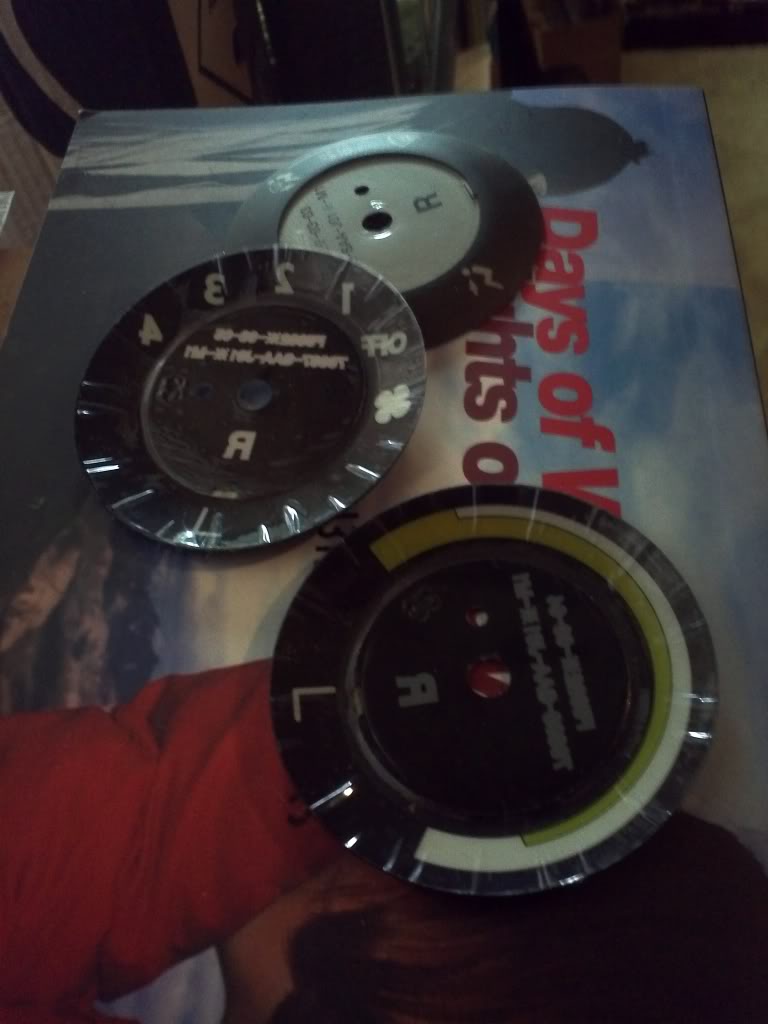

they're a semi rigid plastic pre shaped. Like half a credit card-ish. New ones will have a peel off backing. Install is easy just line up the notch in the sticker with the notch on the base. Press and push your knob back on. It'll click when its in. Start buying other jdm trinkets for the interior

Those are more to show thickness. As the jdm ones are different color. You can compare the differences between the two
