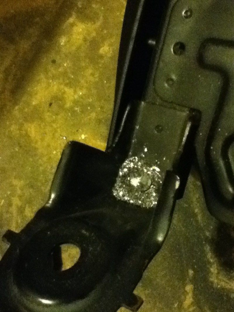

Remove the stock seat attachment brackets. These are held on by a large silver rivet, spot welding on the edges and a small spot weld on the underside: 1) Using the drill and 7/16" bit, drill through the silver rivet.

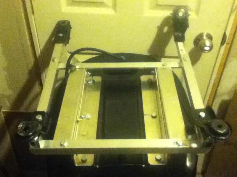

Attach the universal brackets to the G1200 seat after drilling the proper holes with 7/16" bit. Do this one hole at a time as the bottom of the seat is not perfectly flat. Use the included bolts.
Step 5
Find the correct seat position for yourself. Place the seat on top of the aluminum angle which is resting perpendicular on the aluminum square tube. you will need to find the correct forward/backward position AND side to side position. Mark these on the aluminum angle with the marker after finding just the right spot.
Step 6
Drill the holes with 7/16" bit and attach the aluminum angle to the square tubing (1 1/2" bolts) and the universal brackets/seat to the aluminum angle (3/4" length bolts).
Step 7

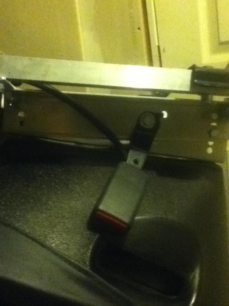

Sit in the seat, adjust the tilt on the universal brackets and drill holes for the seat belt connector. I had to tilt the seat back up and the front down for a near stock feel. Also keep in mind this position will be a little on the high side, this can be remedied by using a small square tubing. For now I like this position better as I can see more of the road and other cars. Once you find the right tilt position of the seat on the universal brackets, only then drill the 2 holes for the seat belt attachment, the larger one for the bolt and the smaller 3/8" bit size for the piece of steel that keeps the belt piece from rotating.

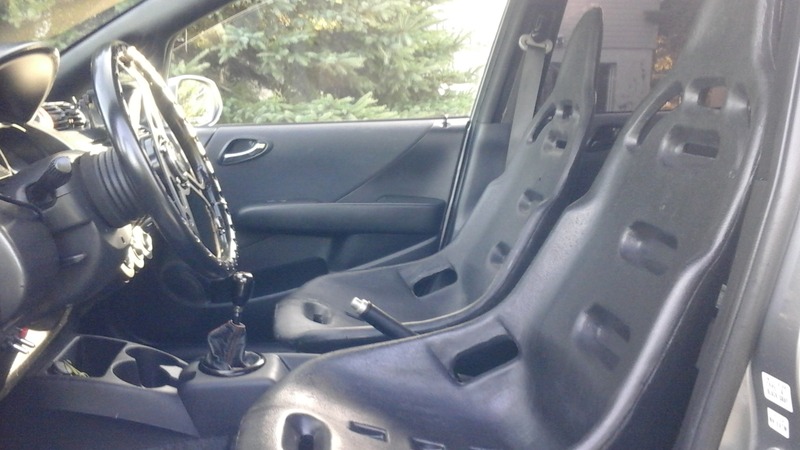

Got 2 used rci seats for free and they are officially 2 lbs lighter than the summit g2100 seat. Just some finishing touchs left but they are mounted in the car.
Will weight the whole setup when finished.

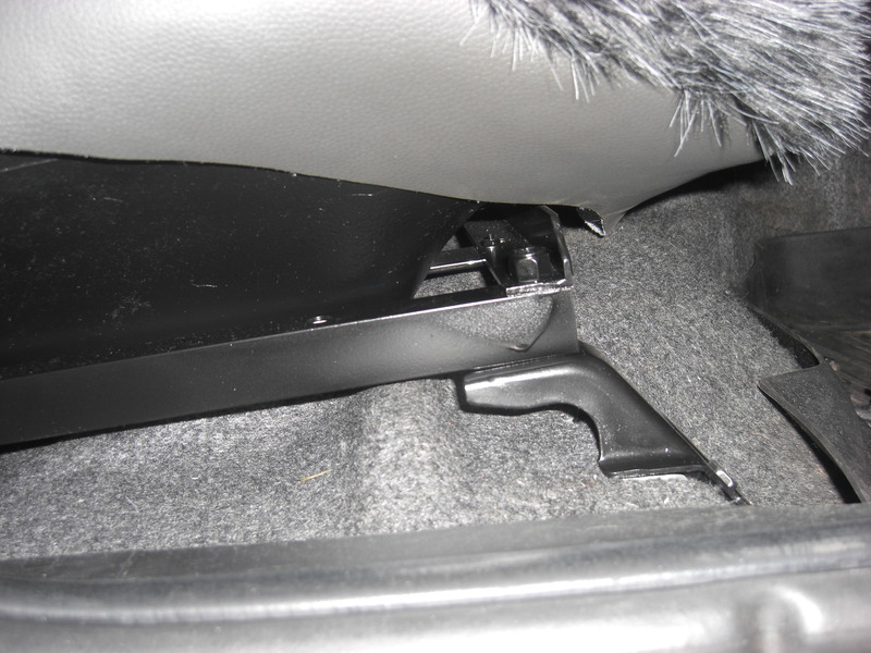

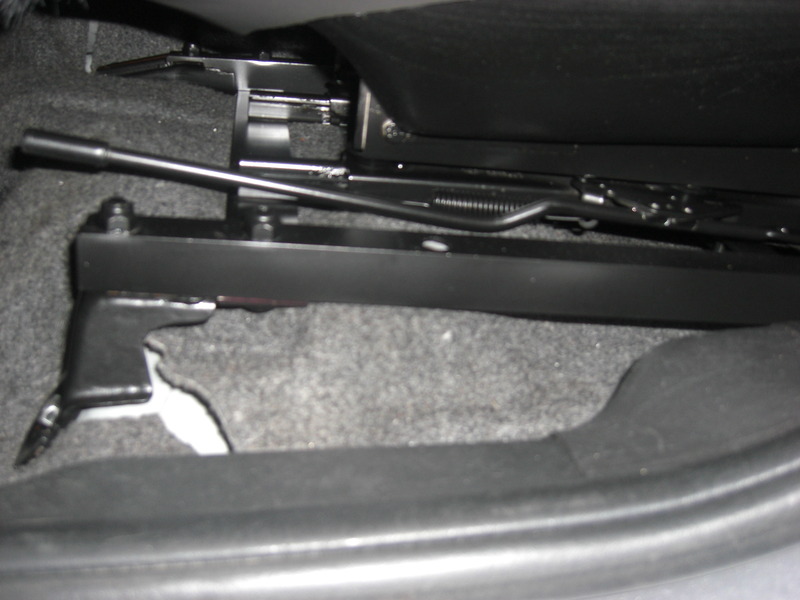

Made more updates to the RCI brackets. The wife requested an adjustable slider for the driver's seat so I installed the Summit Racing universal slider (it's cheaper than the RCI). Since this would have added more than another inch in height to the current setup, I had to go back to the drawing board and figure out a way to lower everything. It was a bit of a pain in the ass since the gas tank comes up under the seat quite a bit in the front.
What I did was use some aluminum flat on the underside of the square tubing at the front and moved the aluminum angle also to the underside and forward a few inches. This angle requires some trimming on the right hand side, but is way stiffer than the flat aluminum would be. The front flat aluminum is not too flexible since it is somewhat supported by the frame underneath.
To make room for the adjustment arm of the slider (it pulls outward towards the door and the aluminum tubing of the bracket gets in the way), i made similar fixed brackets as the summit one but oriented them so they had a narrower attachment point to the bracket. The total weight is now 22 lbs for the adjustable seat.
AND in doing all this I was able to improve the weight and height of the passenger seat by mounting 2 pieces of aluminum flat to the underside of the RCI seat insead of using the 4 pieces of aluminum angle (which enabled anlge adjustment). This was simply bolted to the aluminum angle running across to the square tubing and now is not only lower but is at a good angle forward. This dropped the weight to 15 lbs!
The weight I gained in the driver's seat I lose on the passenger's side.
Pics to follow!

Removed the adjustable slider from the drivers seat with some thicker aluminum flat:18 lb, down from 22 lbs
