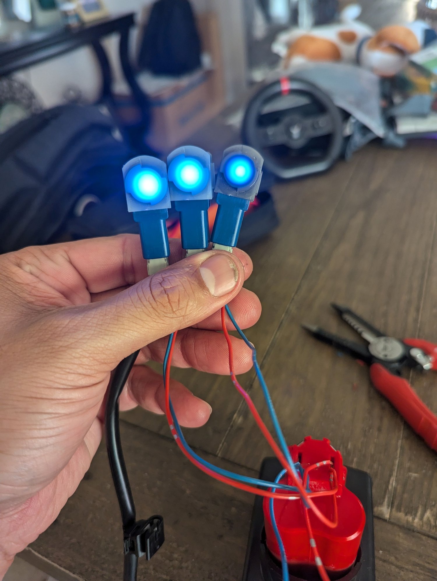

Found these ambient lights off of a honda CR-Z that was at my local salvage yard. Added to driver side footwell, trim above the cup holder and passenger side footwell. Made a harness and tapped into the wire that turns on the corner lights and headlights. I got an extra two lights that I am going to try to add to the rear.
The one on the far right is the one I added to the cup holder area, since its a bit darker.

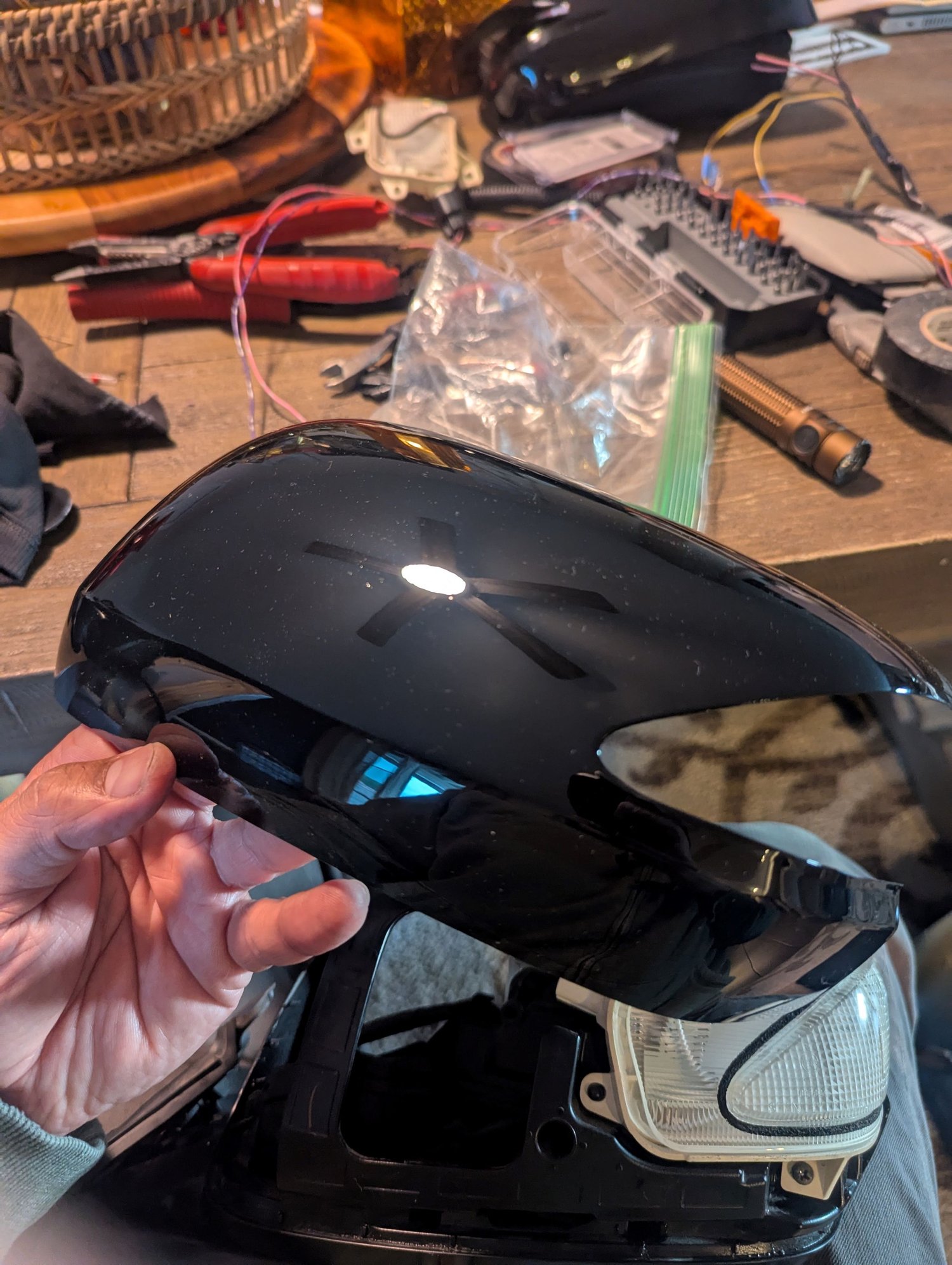

Ordered these covers through Amazon and got the side markers from a Honda insight. Going to take the covers to my painter later this week.

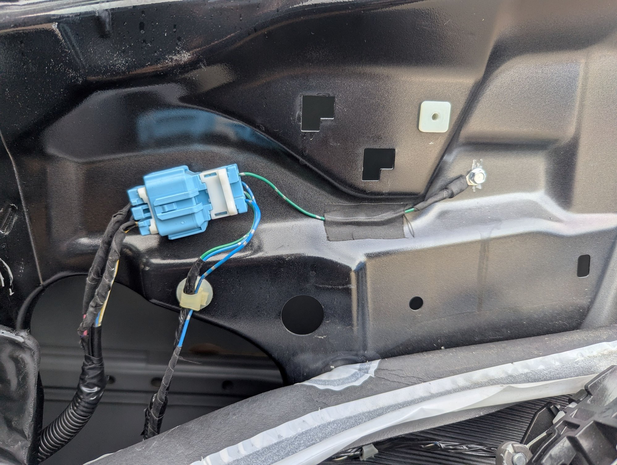

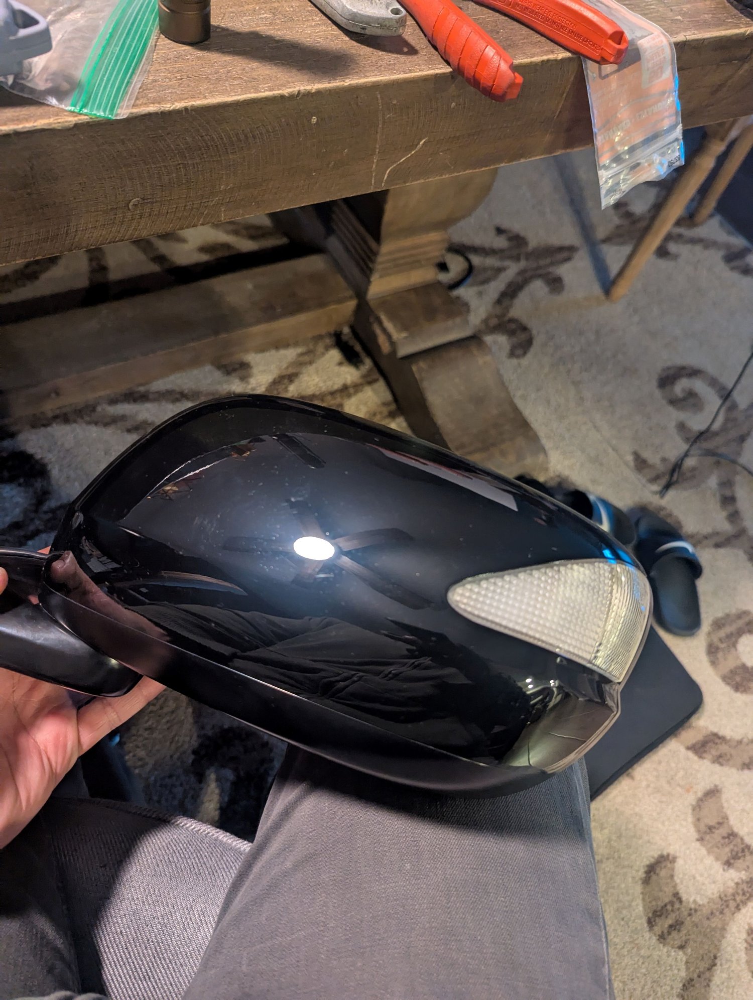

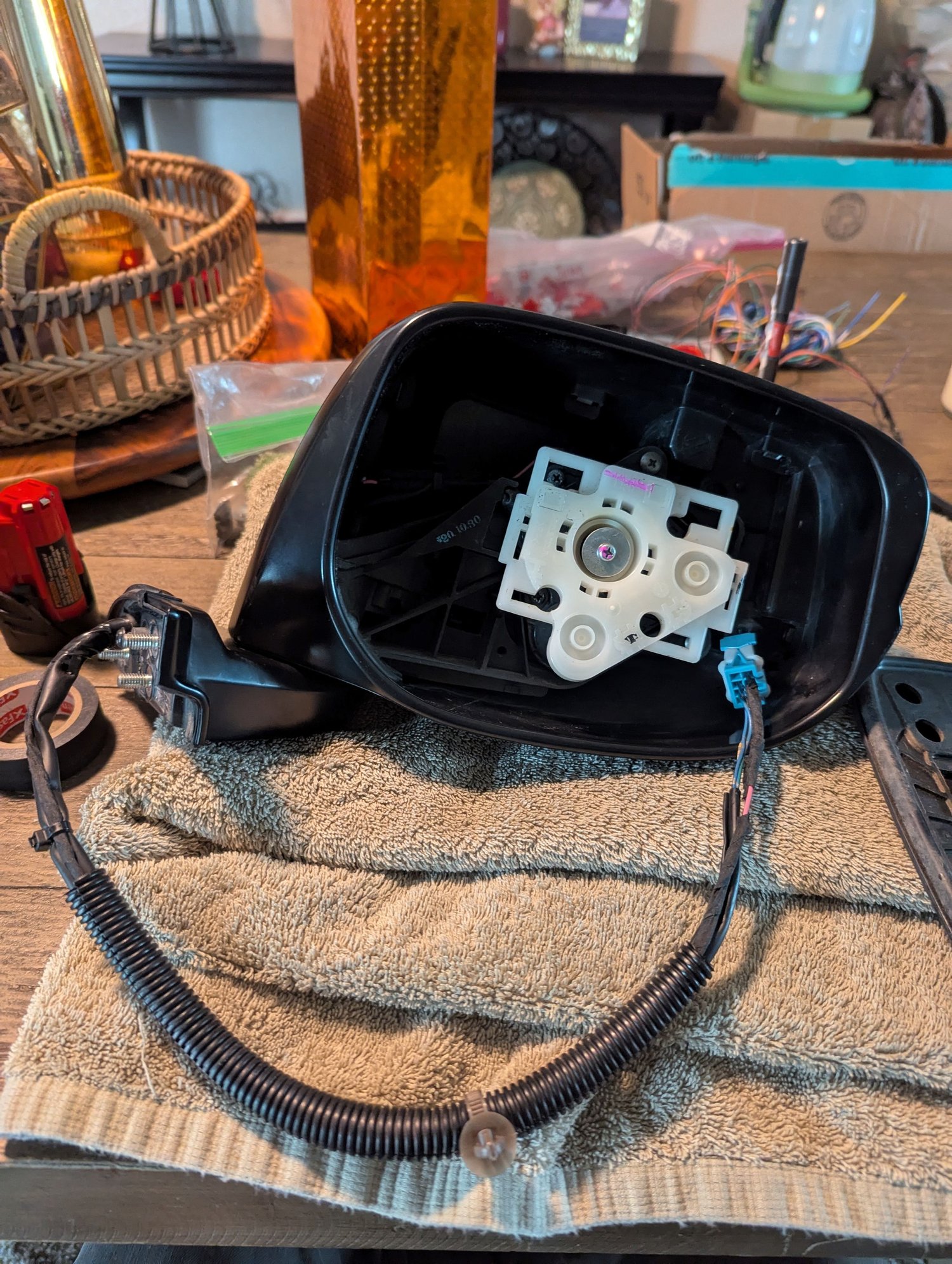

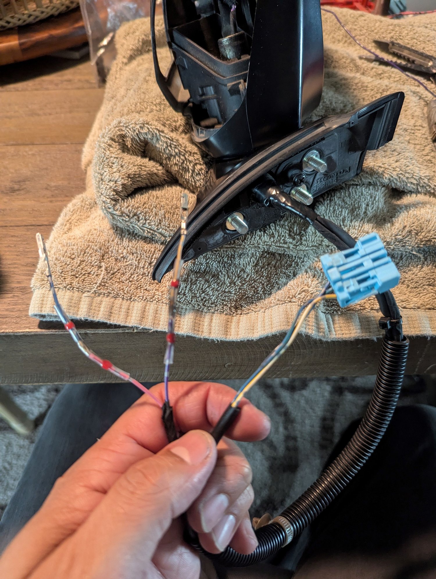

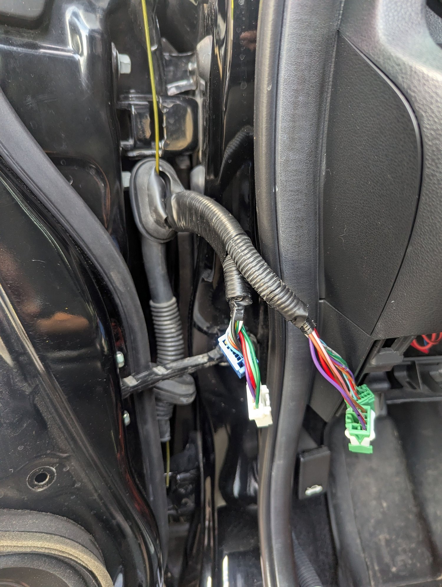

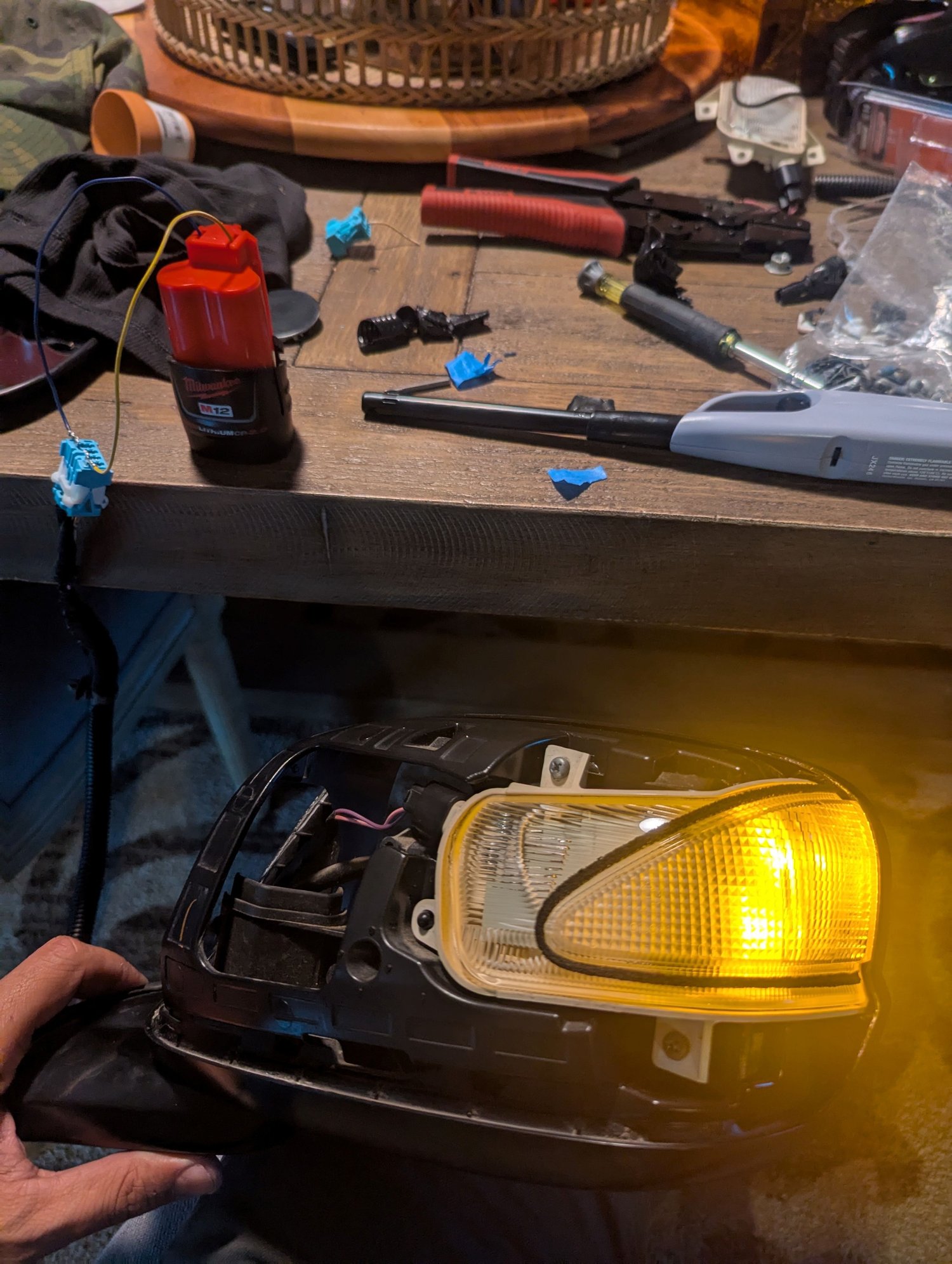

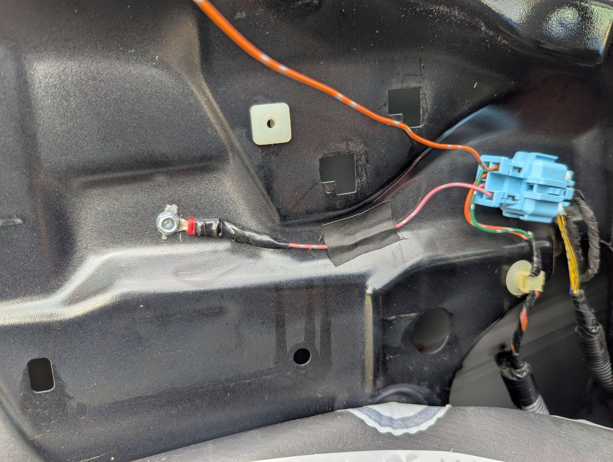

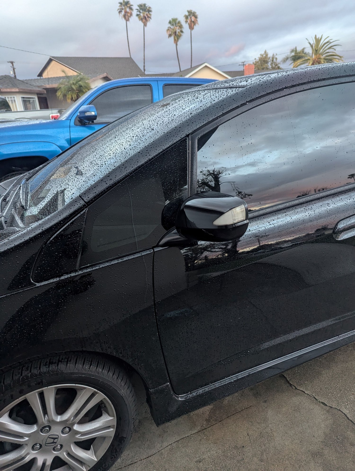

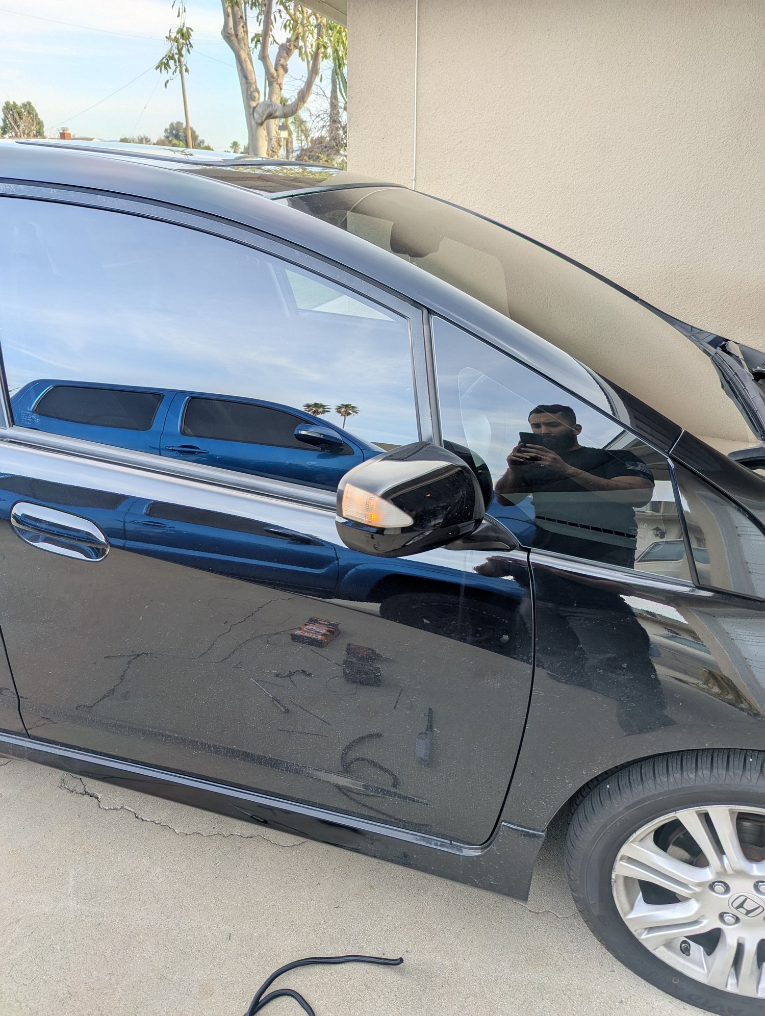

Well we got some rain last week and I decided to have something do inside the house. It's a very simple mod to do, literally two wires that need to be connected. For the ground, I just tapped in directly to the door, and for the hot wire I just fished through the door grommet and tapped into the wires that trigger the blinkers. The Insight LED lights fit perfect on the Fit housing, you just need to screw them on. For the wire going from the door to inside the cabin, make sure you leave it long enough to somewhat drag to the bottom of the door and then into the grommet, because if its not, you will have issues when lowering your glass. If you have any questions feel free to ask.
Covers finally painted

Harness complete
Harness complete
Passenger side grounded to door.
Driver side grounded
Found it easier to unplug the harness in order to fish the coat hanger through.
Driver Side
Driver Side
Passenger Side
Passenger Side

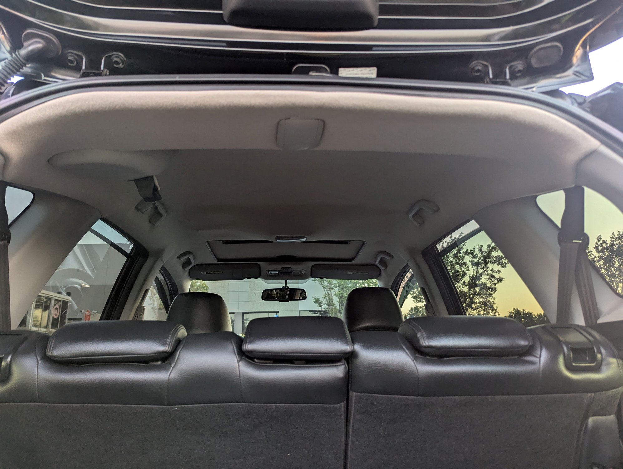

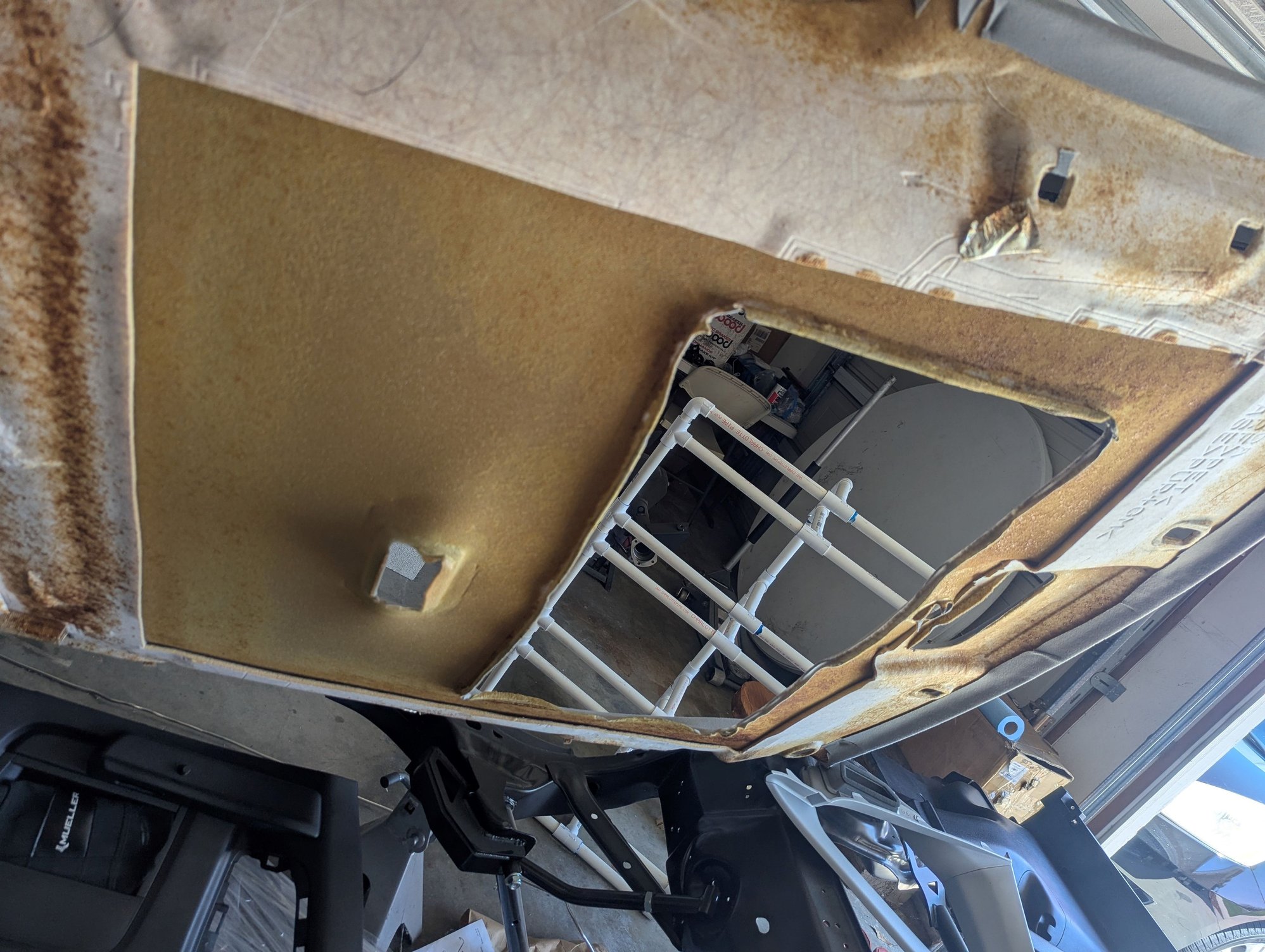

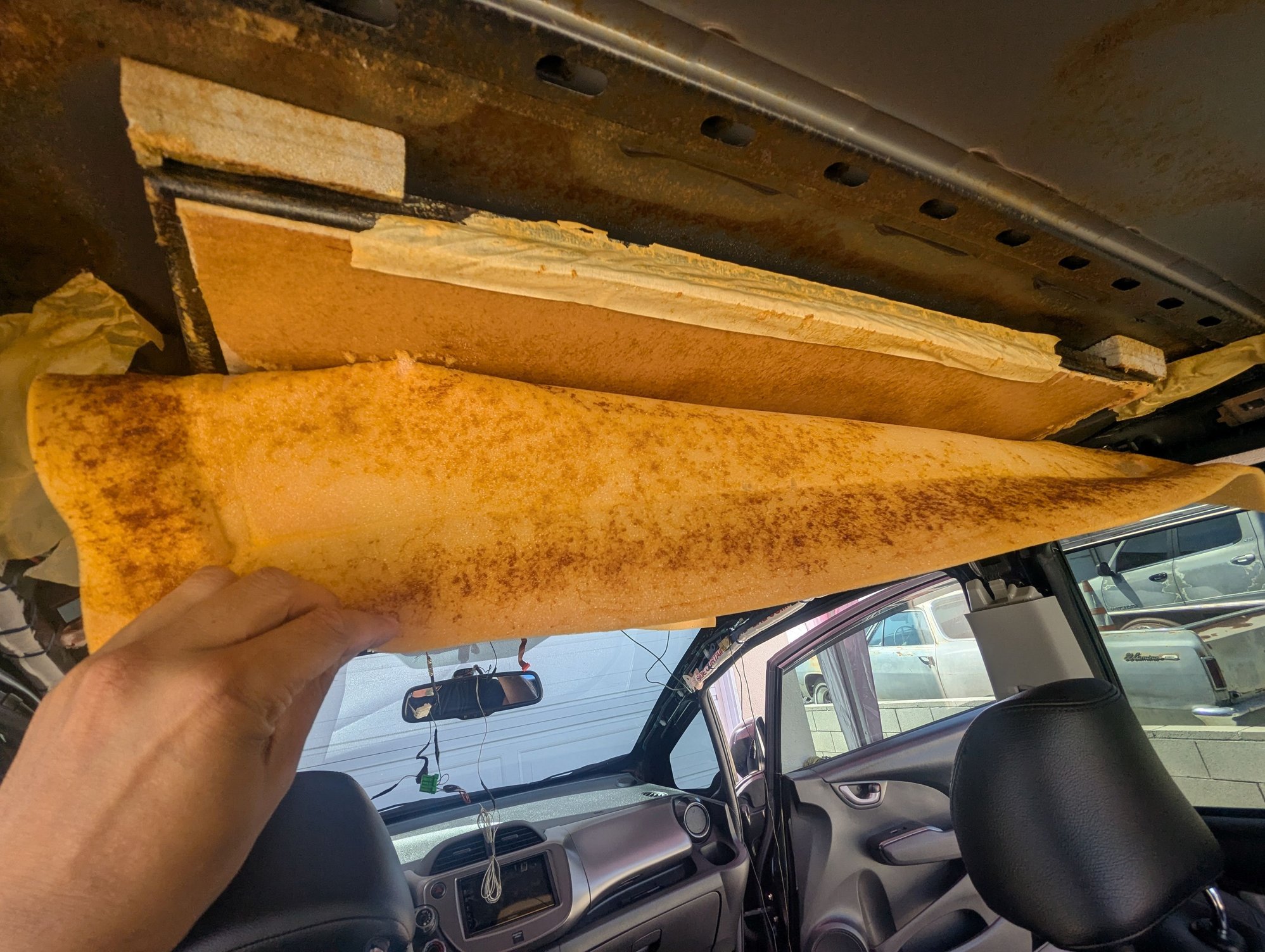

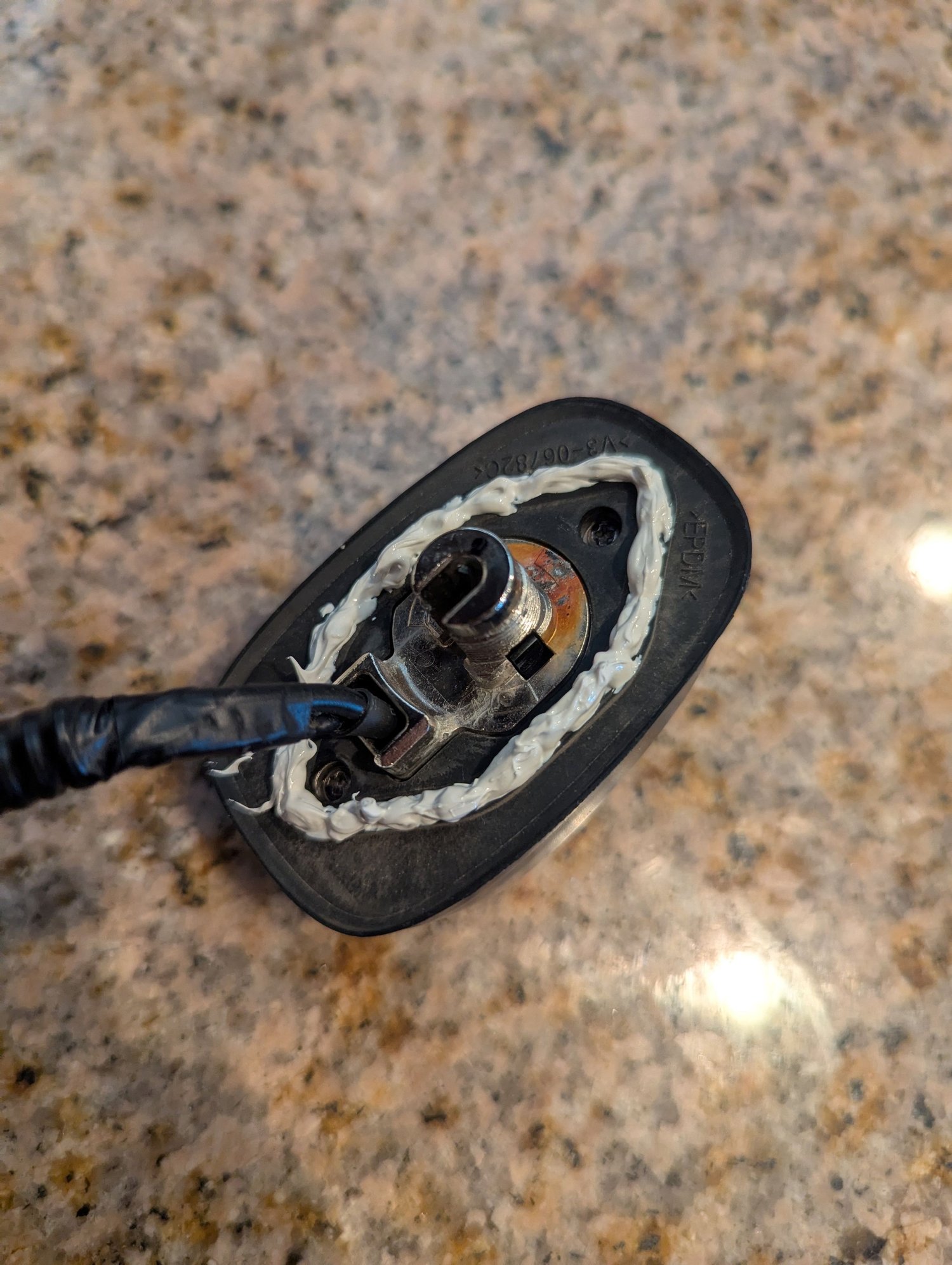

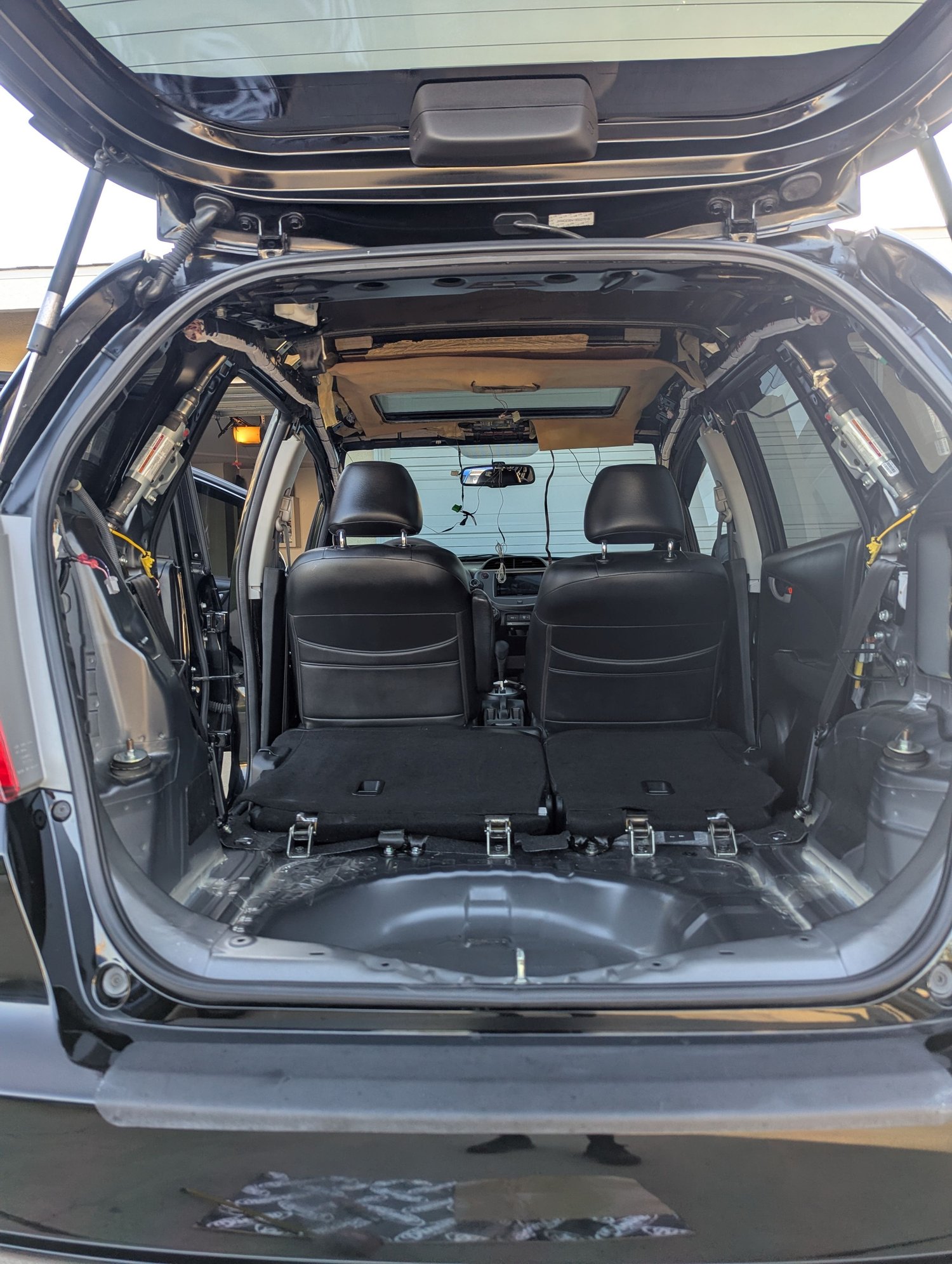

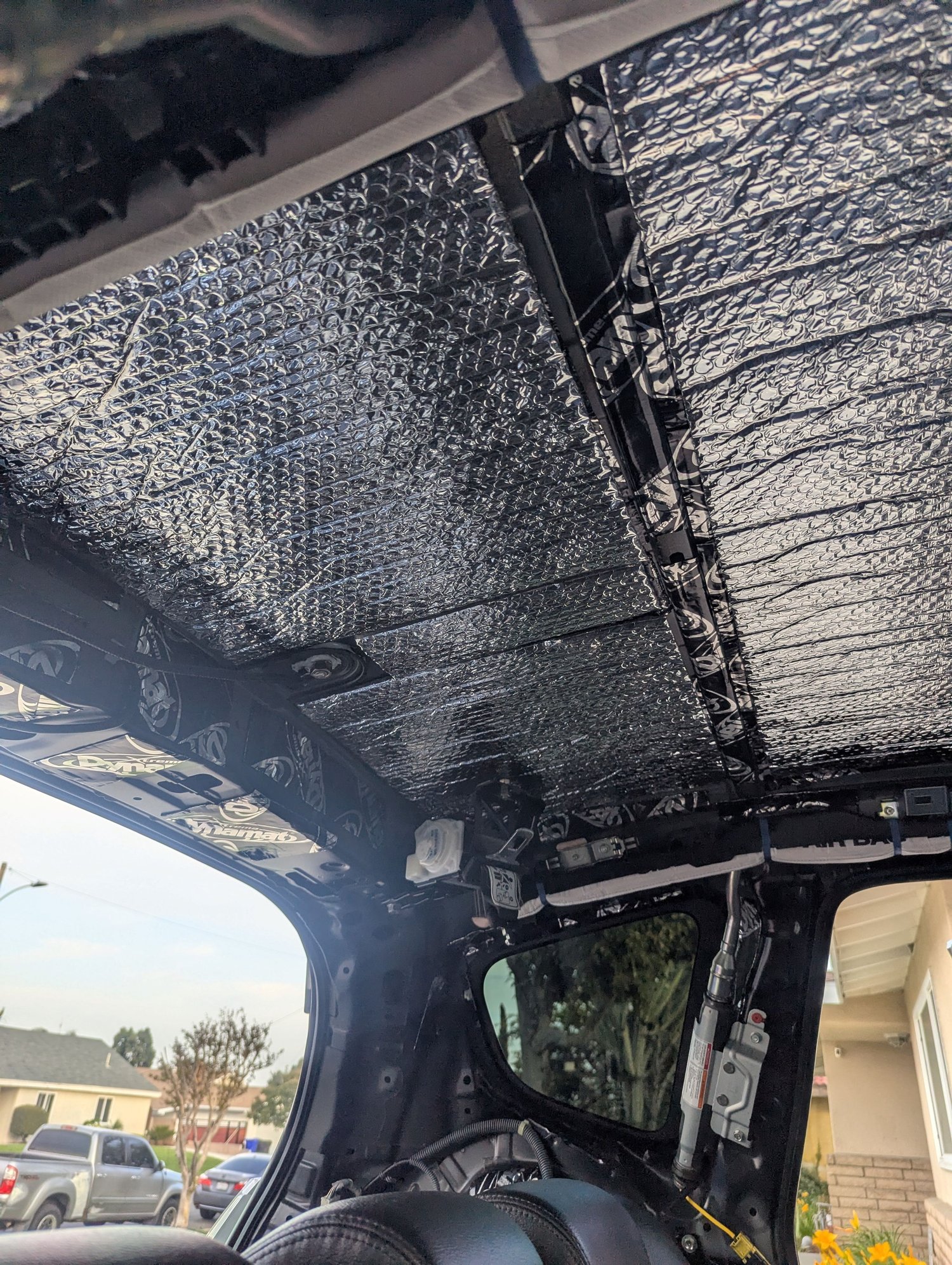

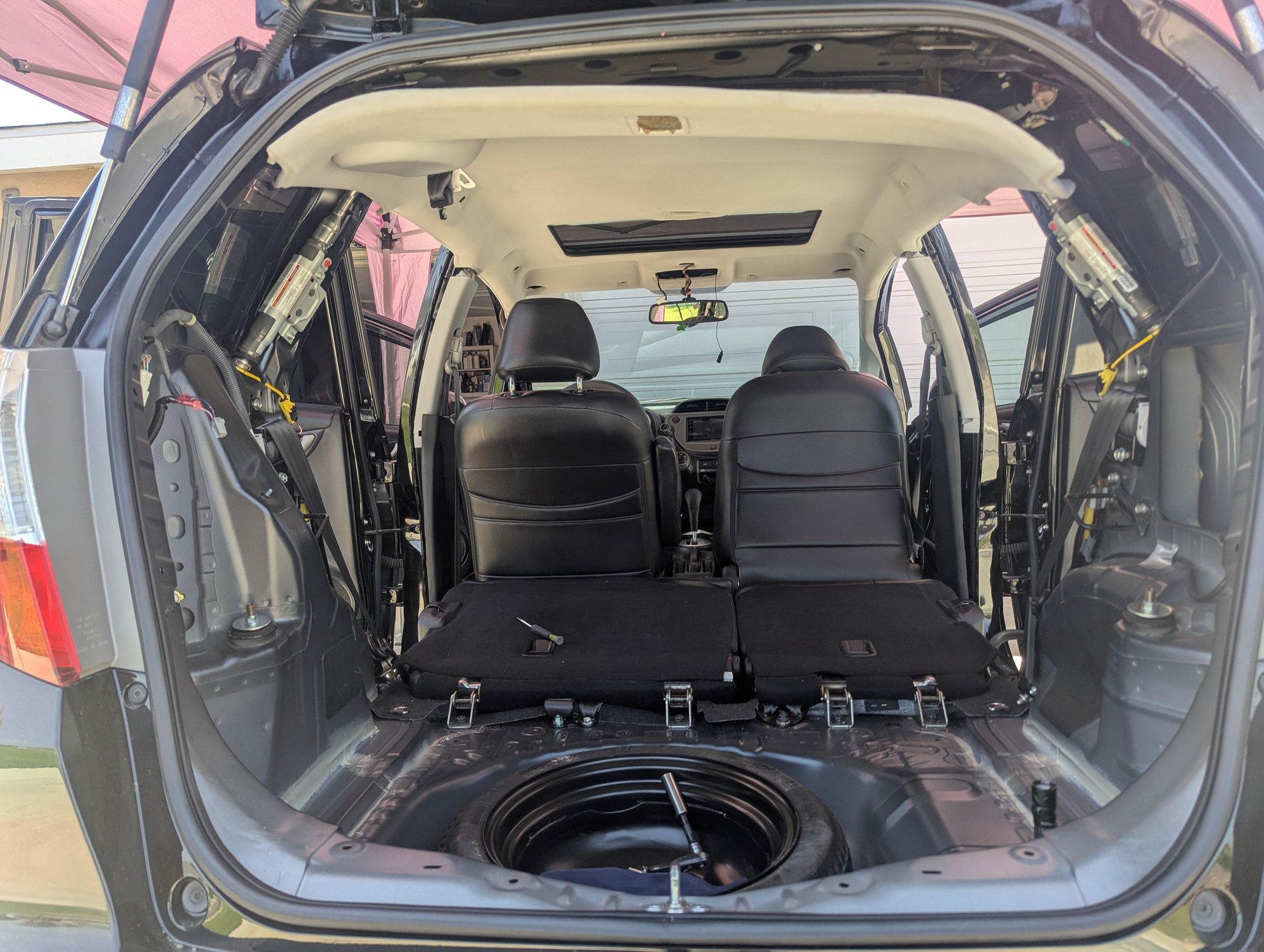

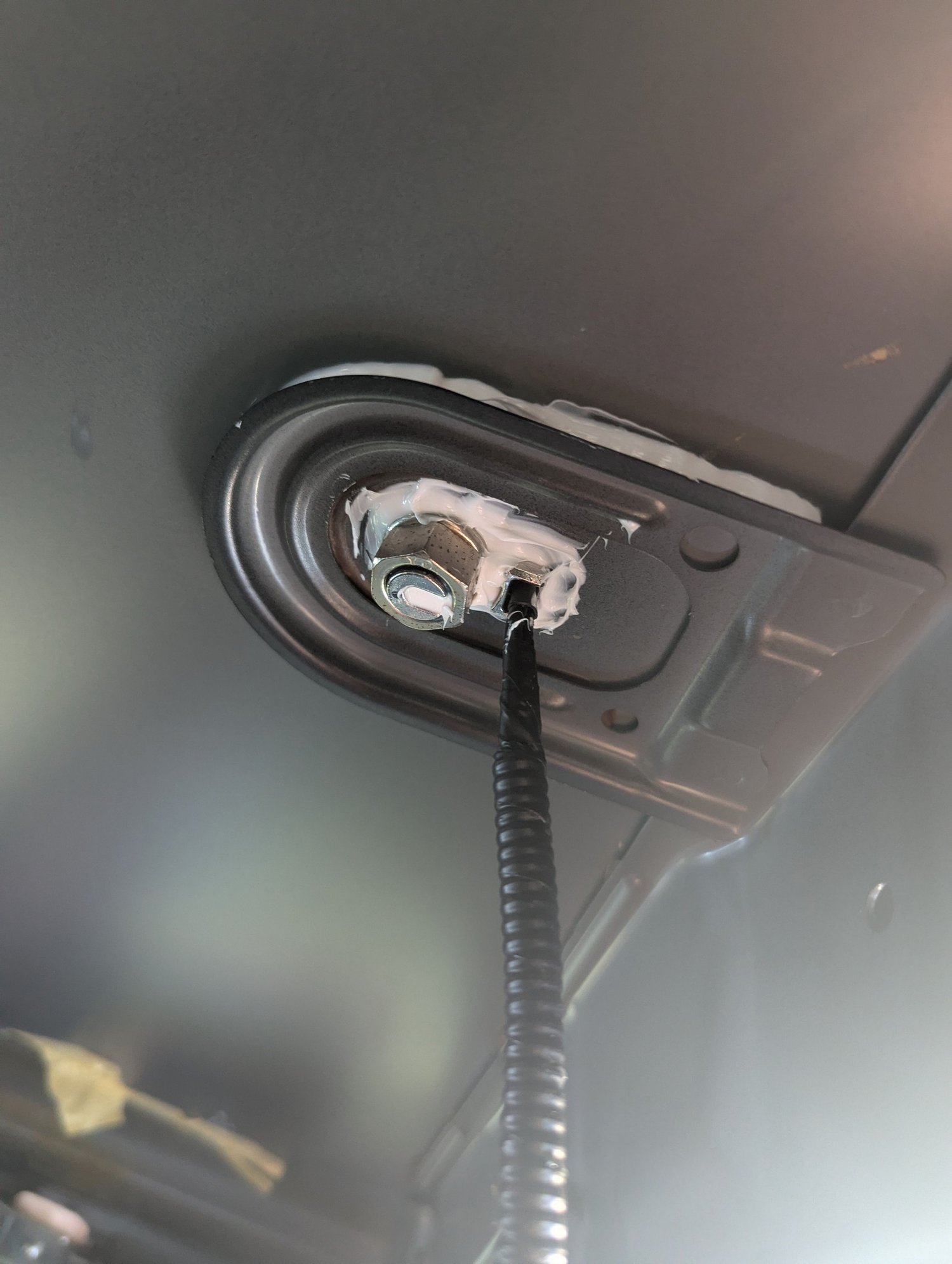

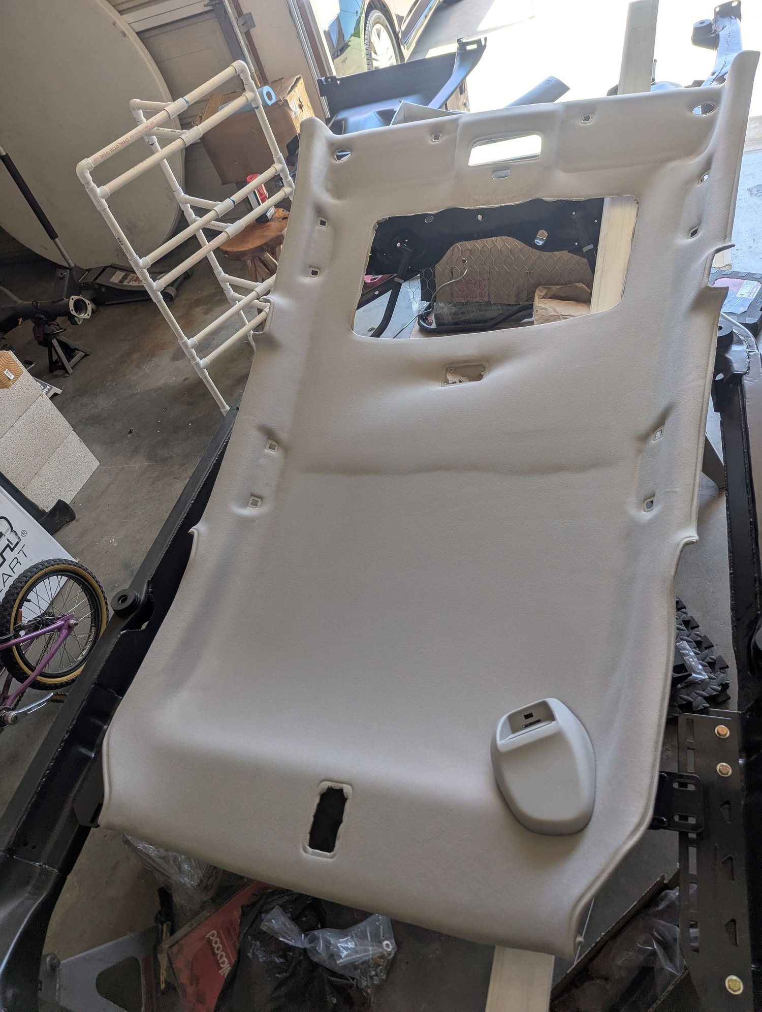

Well I decided to tackle the leaking antenna issue on my Fit. Since I was planning on adding dynamat to the roof area, I decided to drop the whole headliner, but since my GE8 has an aftermarket sunroof I had to get the whole thing reupholstered, because the fabric was tucked into the area around the sunroof. Once I get the headliner back in ill add some photos of the finished product.
The nut for the antenna was loose, so I tightened it and hosed the antenna area down, but it was still leaking. So I decided to add a thin bead of SEM seam sealer to the bottom of the gasket, siliconed the inside and added blue loctite to the nut. I gave it a few days to dry and sprayed it again with the hose and no more leaks.

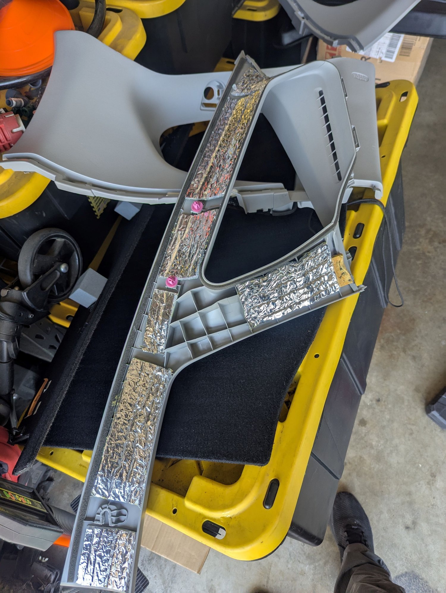

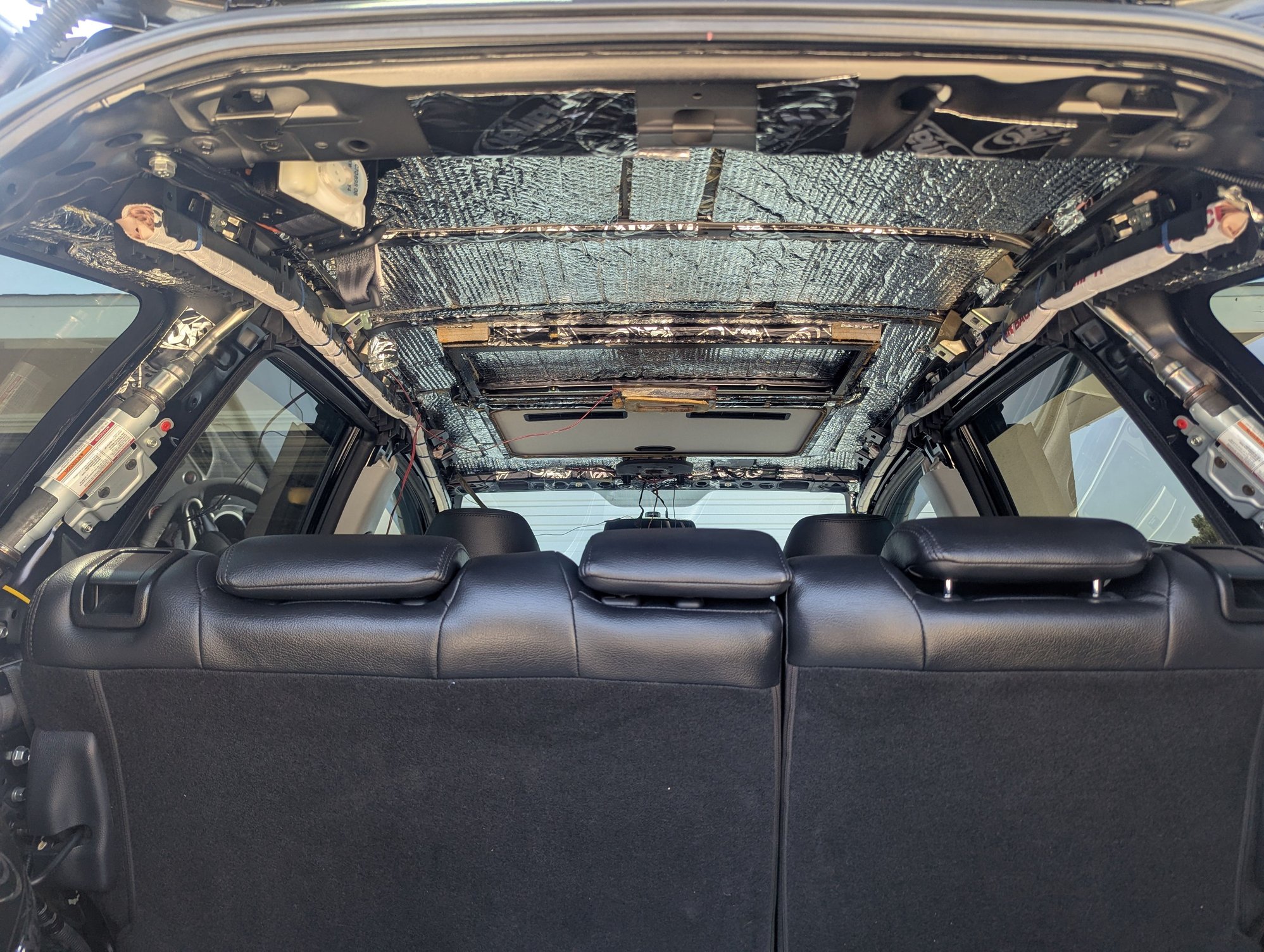

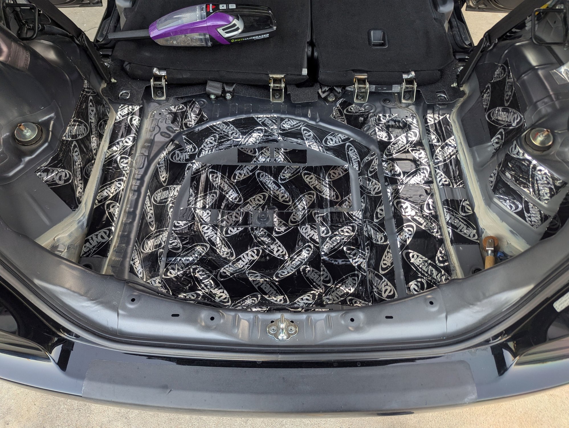

Next few pictures are of the dynamat that was added. I only did the roof, hatch door, hatch area and spare tire floor. I also added some material called Refelctix to help with the heat. I also added some of that material to the back of the plastics. Next project will be to remove seats and carpet and add dynamat to the floor and doors.

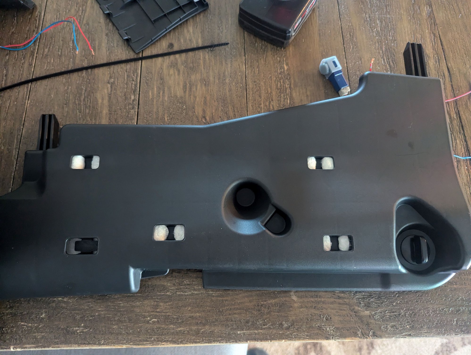

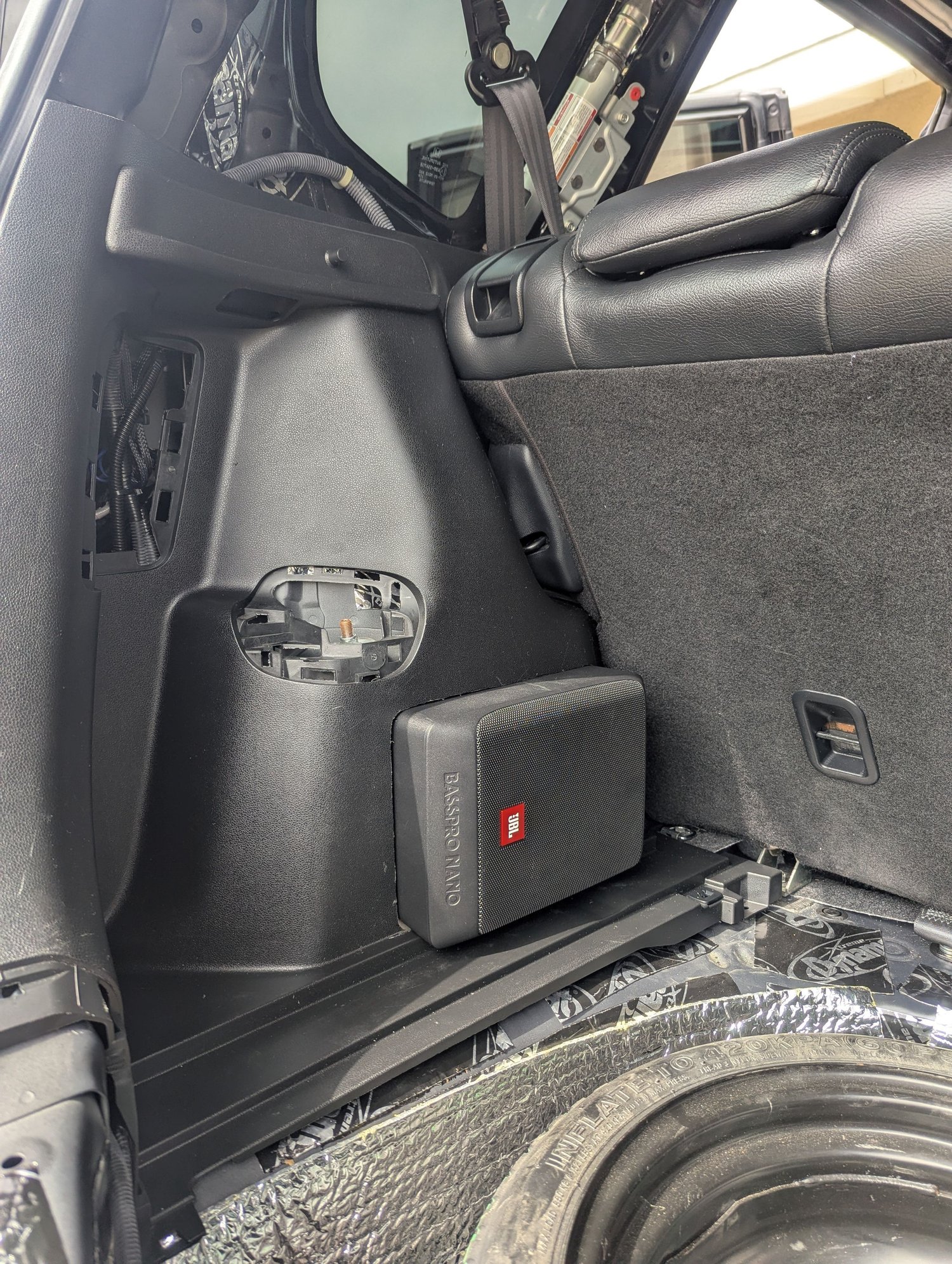

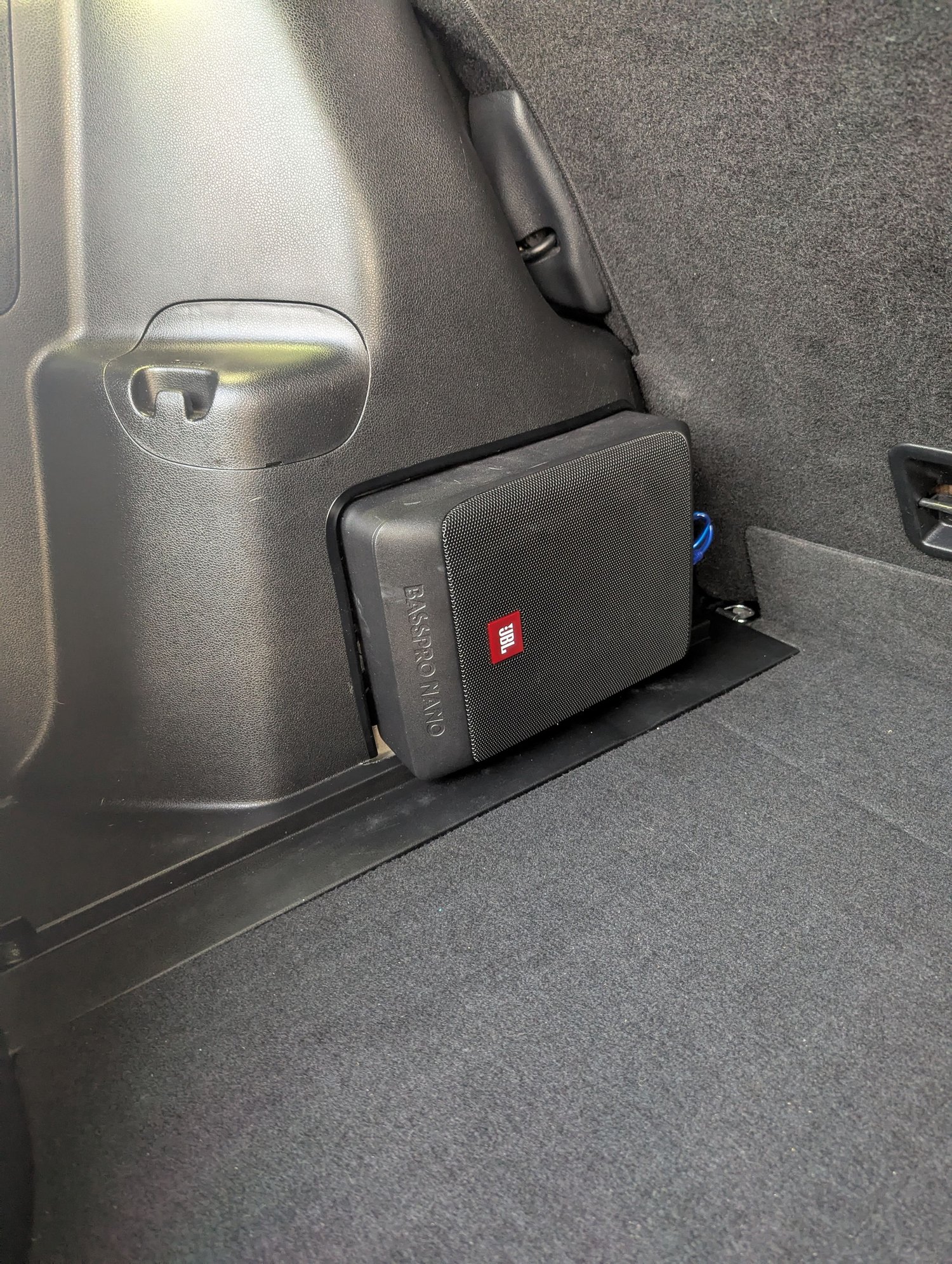

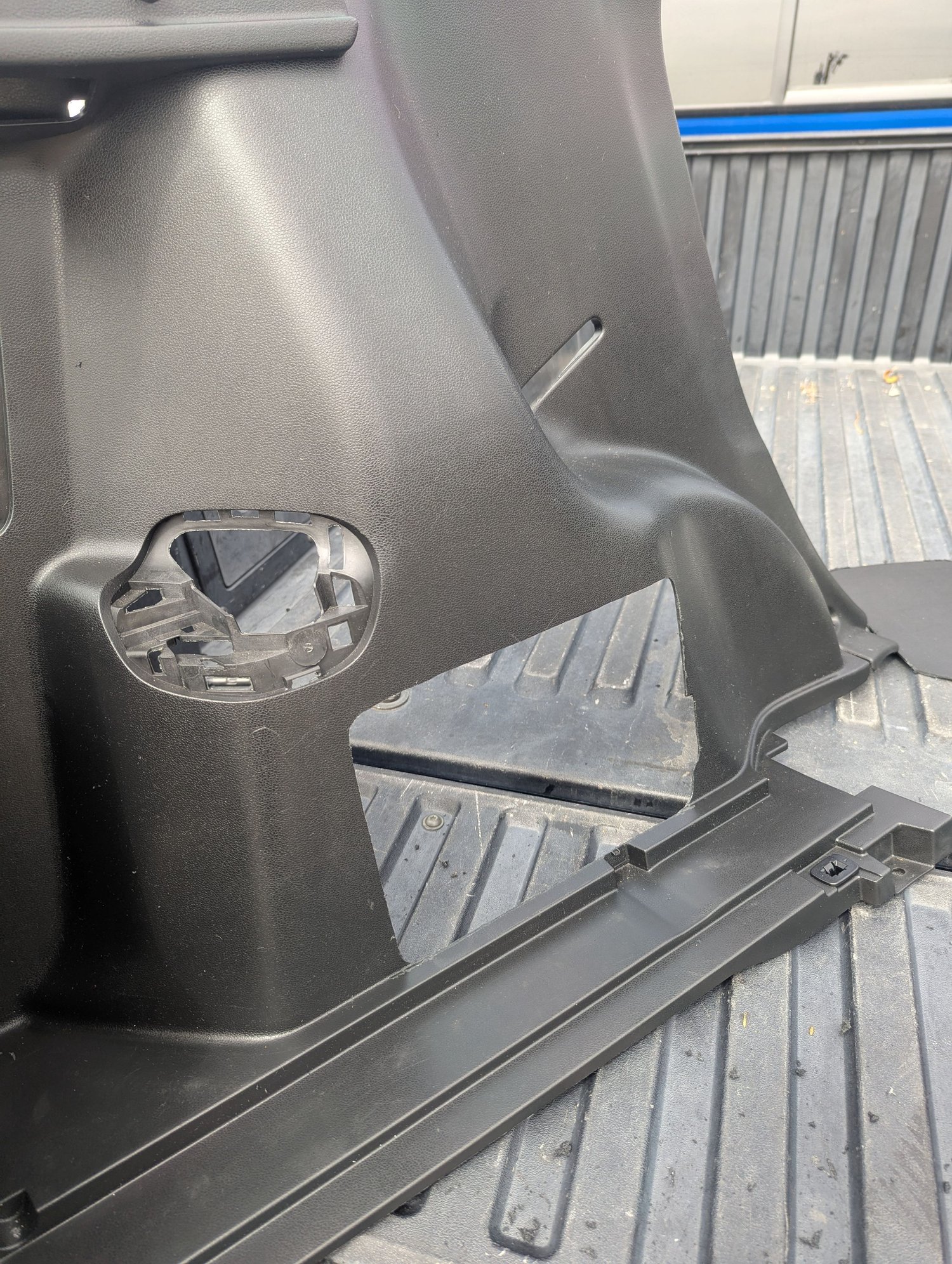

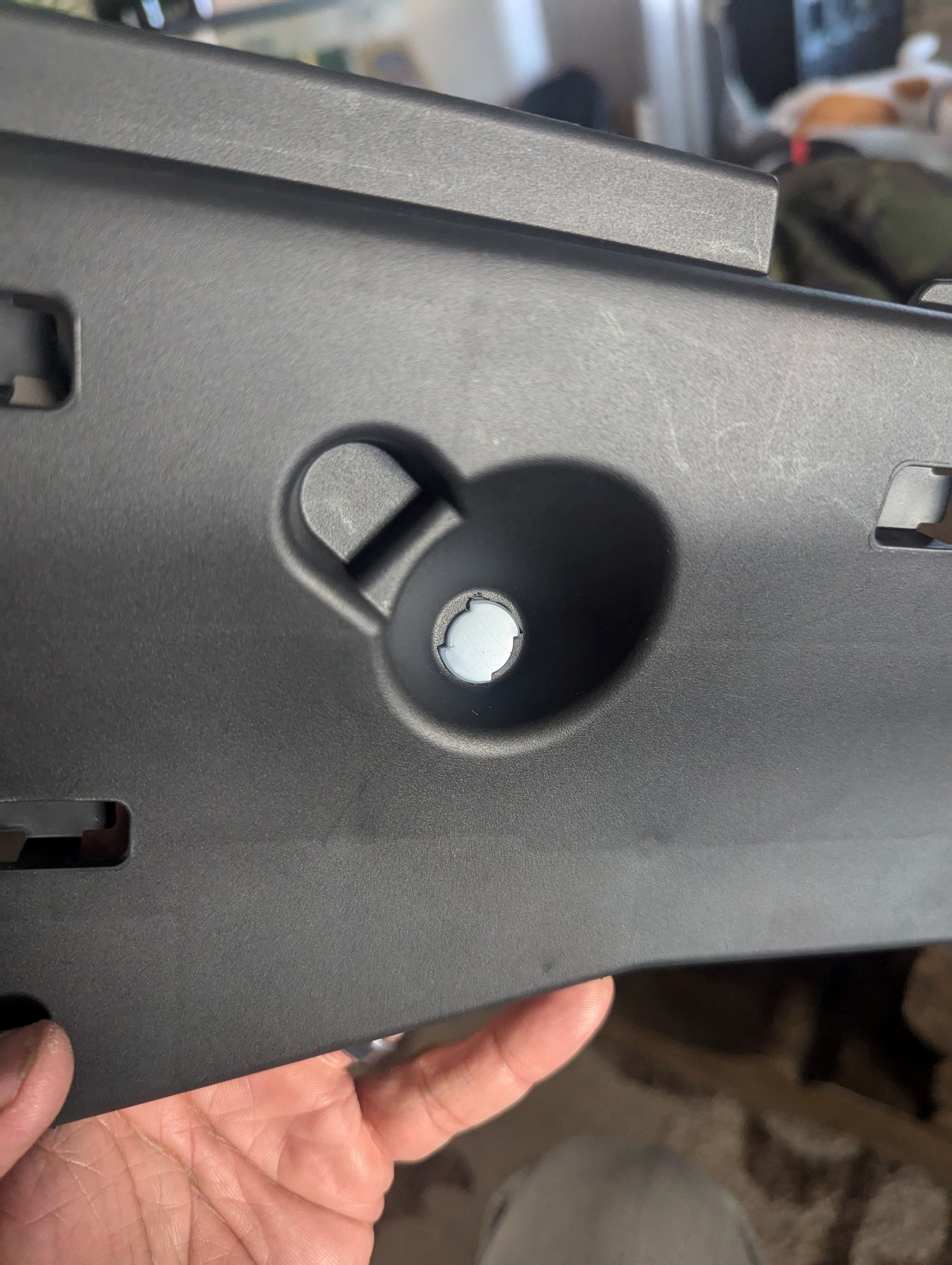

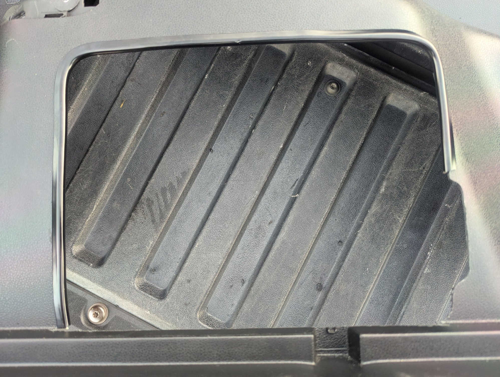

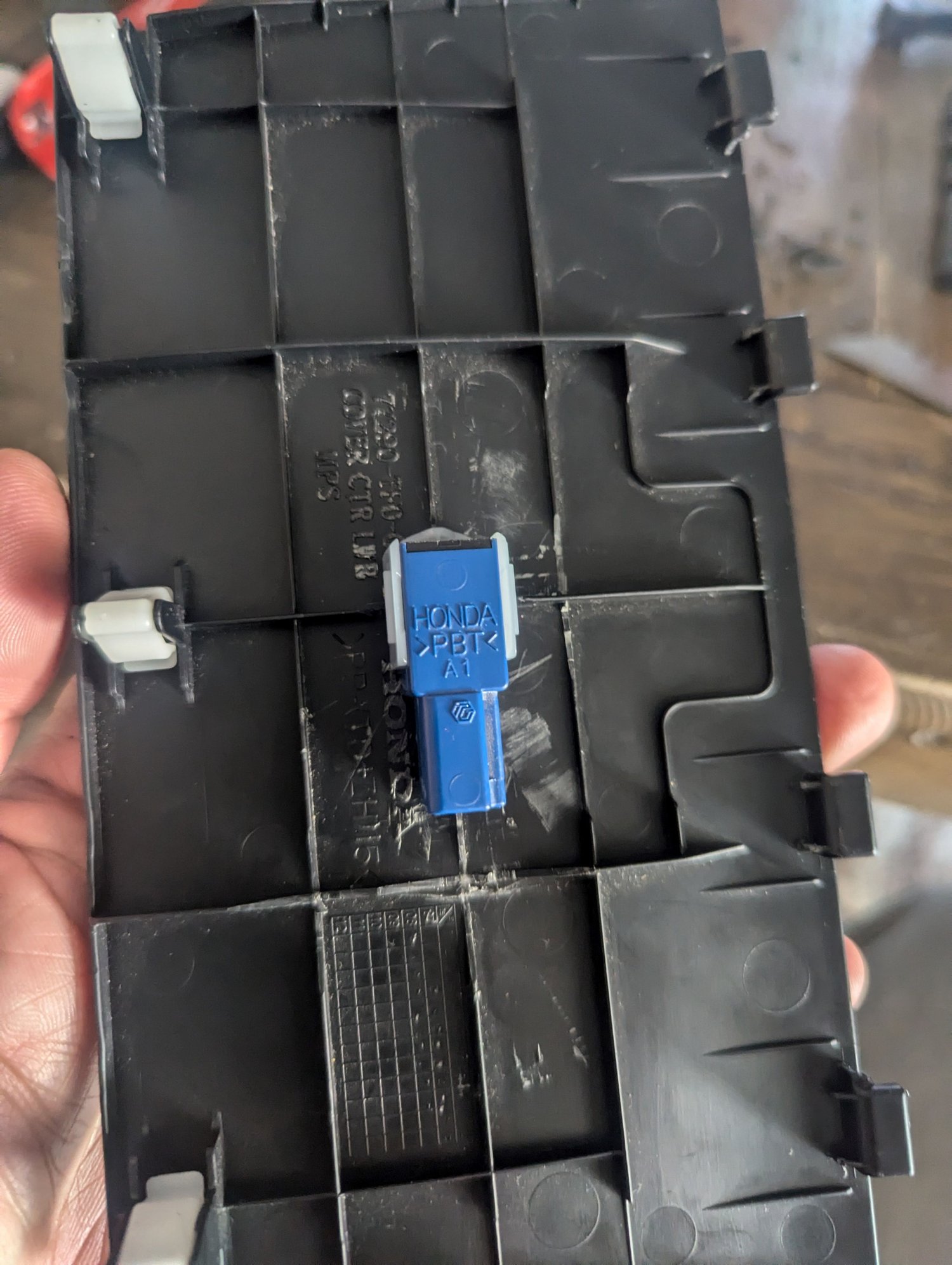

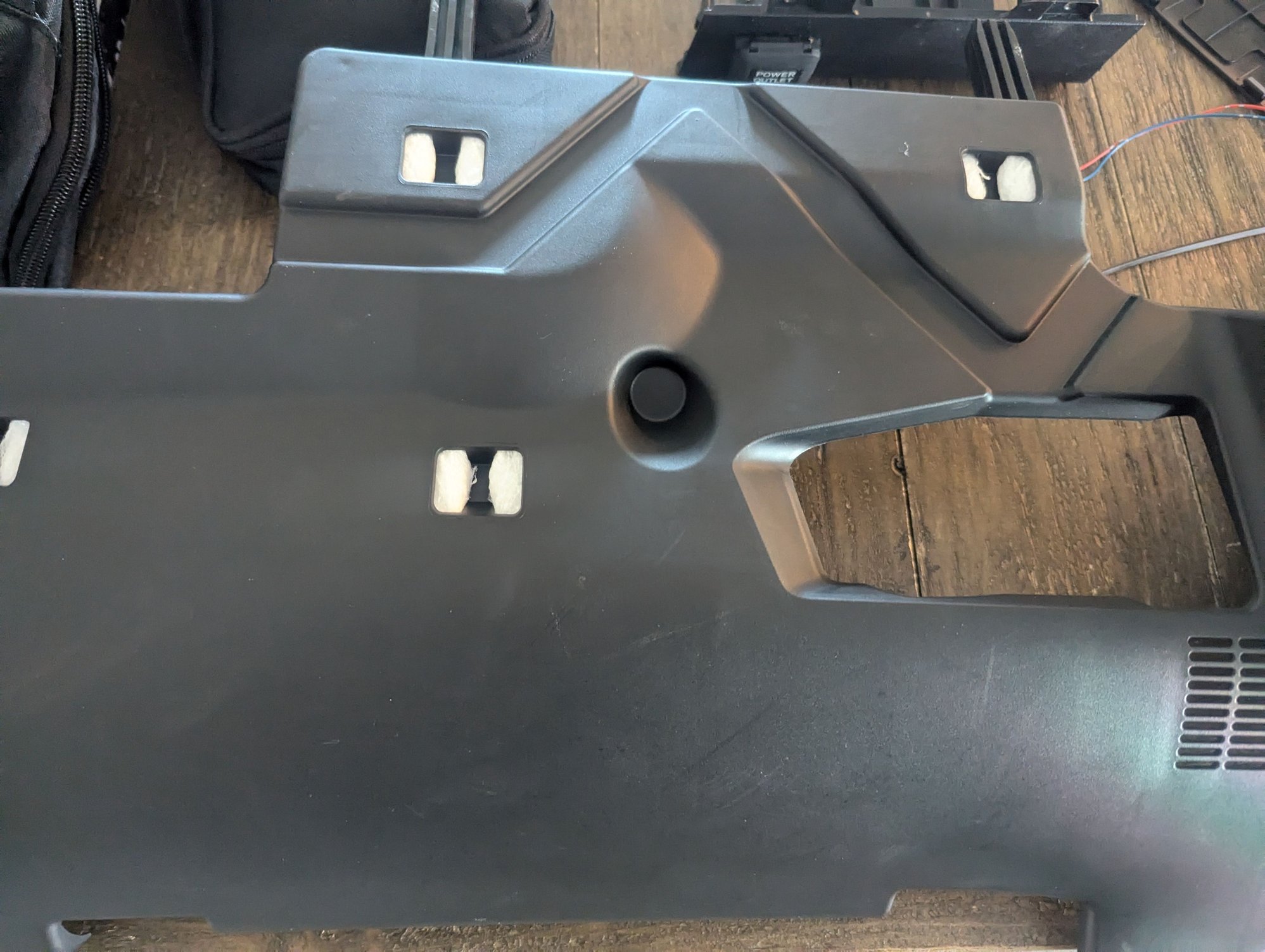

Lastly, since I had everything apart I also installed this little JBL bass pro nano in the hatch area. Tried to install it under the seat but it was too tall.
Made a cutout with the dremel for the speaker
Mocked up
Mocked up
added some vinyl edge trim to give it that clean look.
on the back I added some foam pieces to help with the rattling.
All wired up
All wired up

Headliner done
