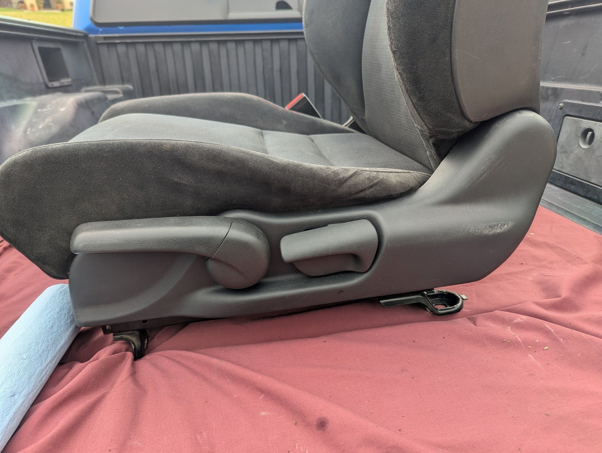

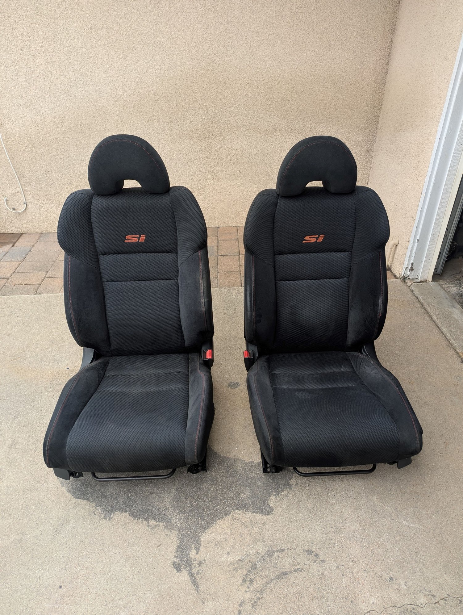

SI seats
SI seats

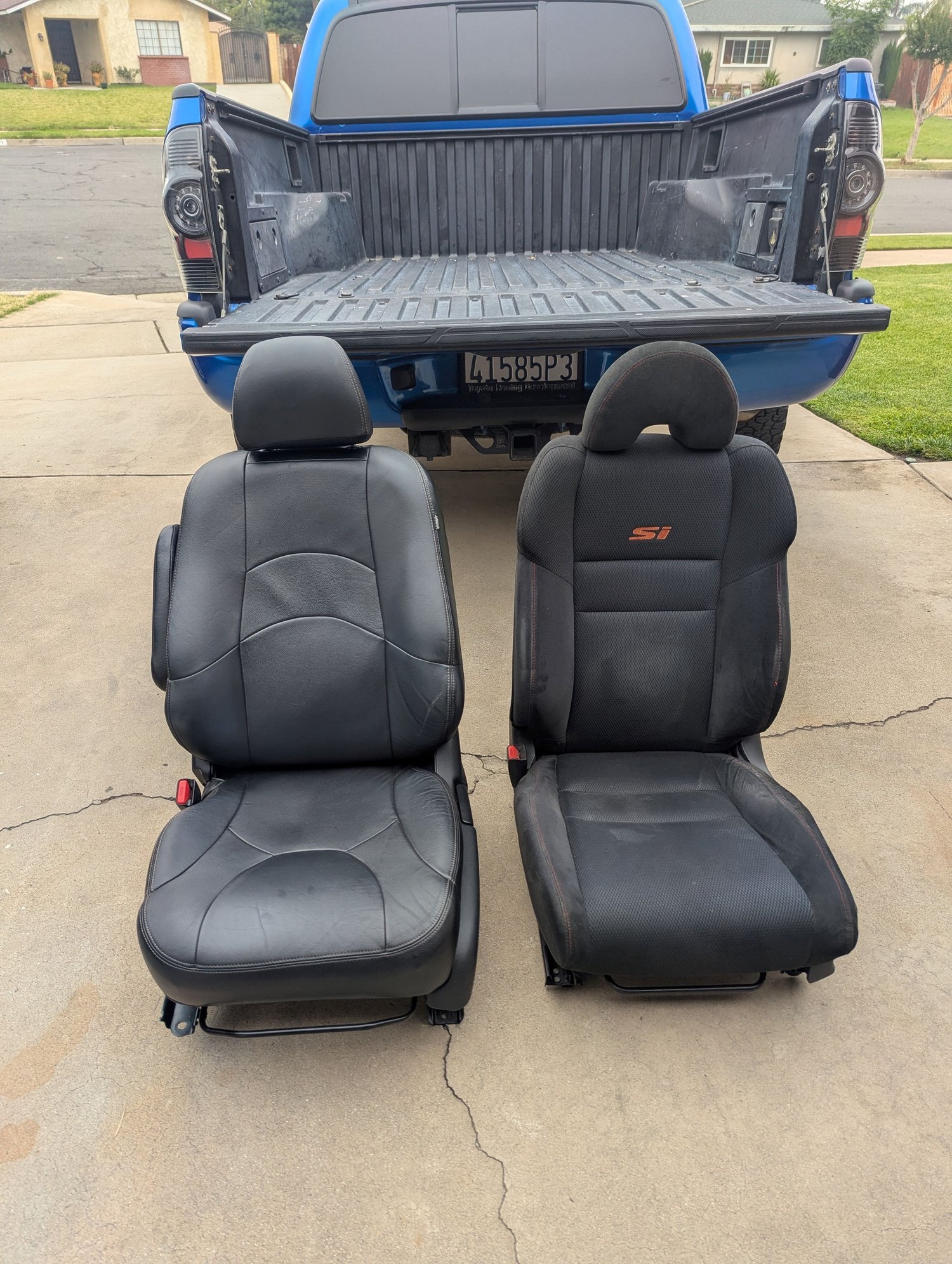

Side by side comparison

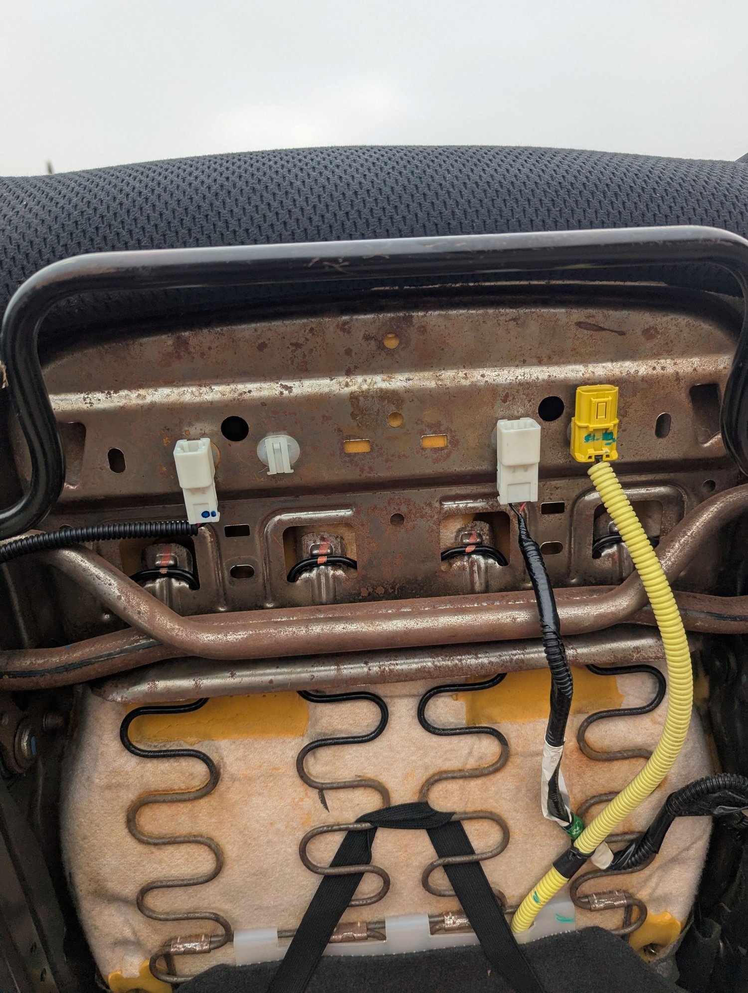

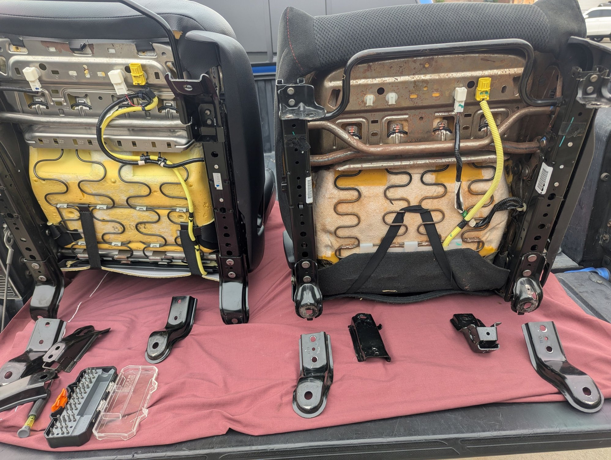

Bottom side of both seats before any changes. Notice the SI seat at the right does not have the harness for the seat belt.
Bottom side of both seats before any changes. Notice the SI seat at the right does not have the harness for the buckle.

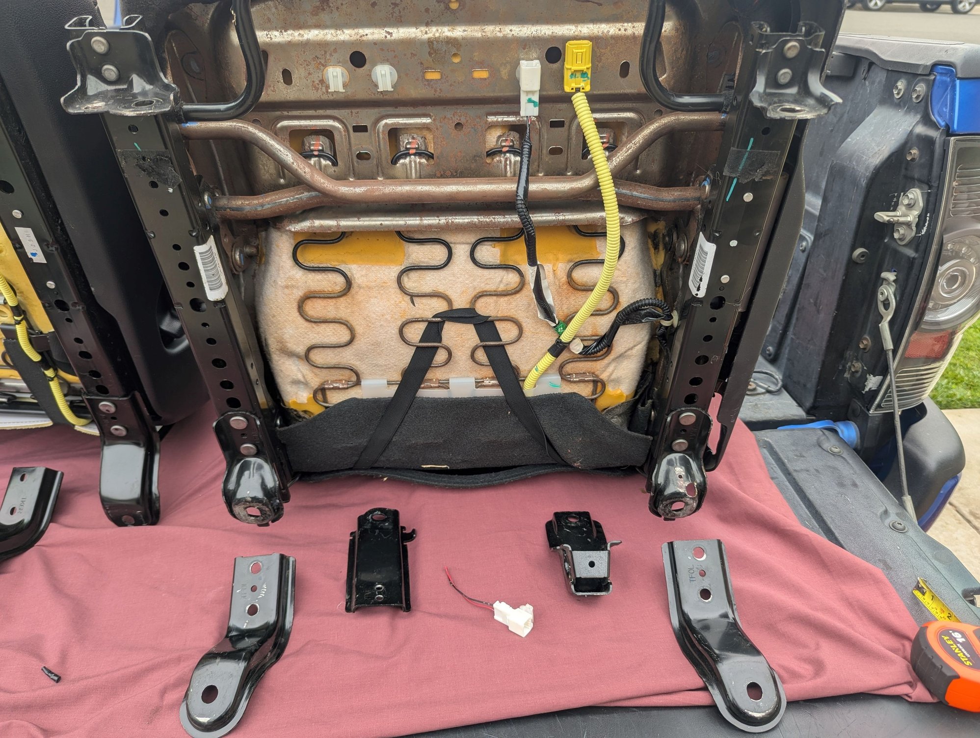

Fit seat brackets and 3 pin connector

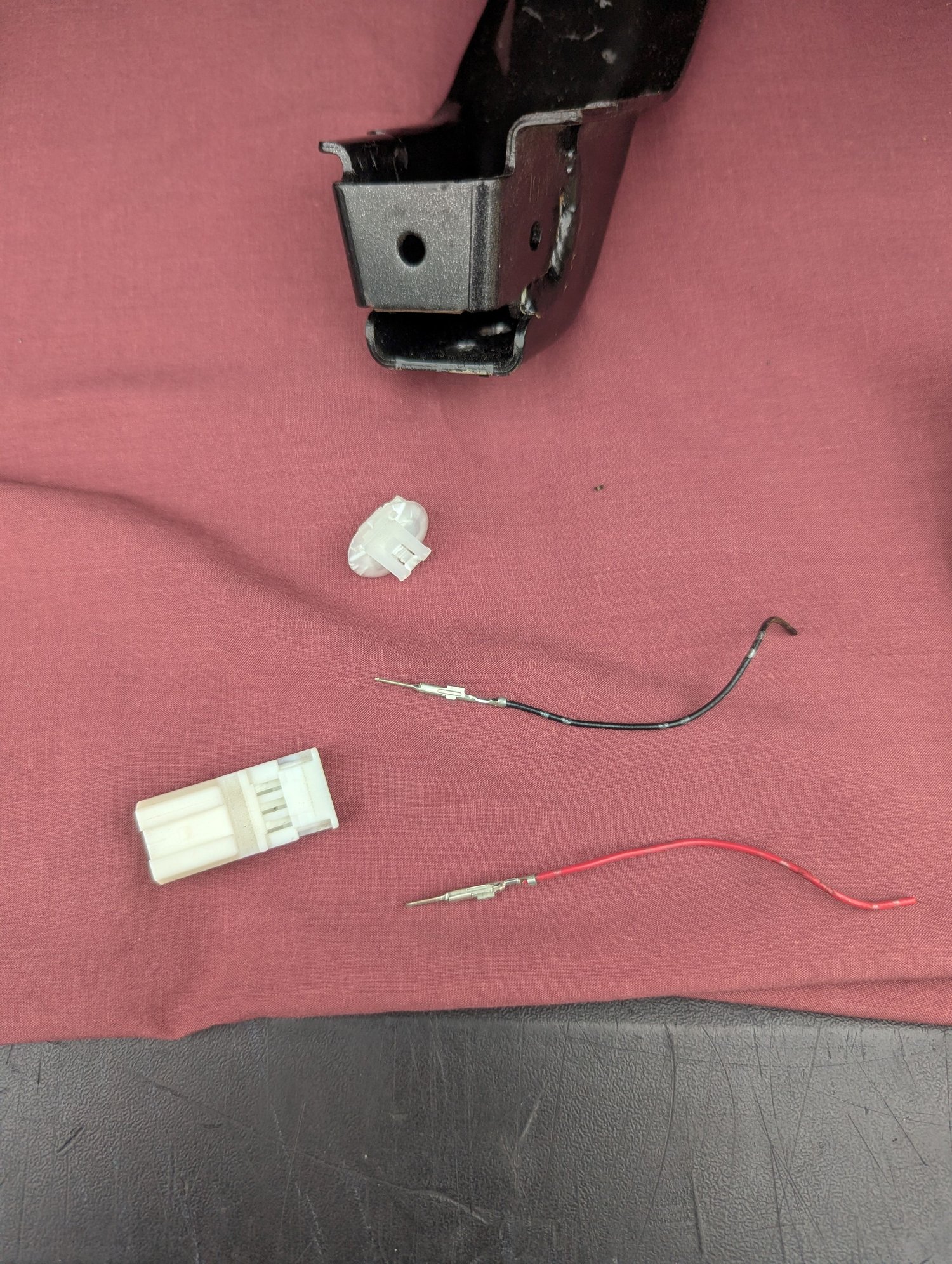

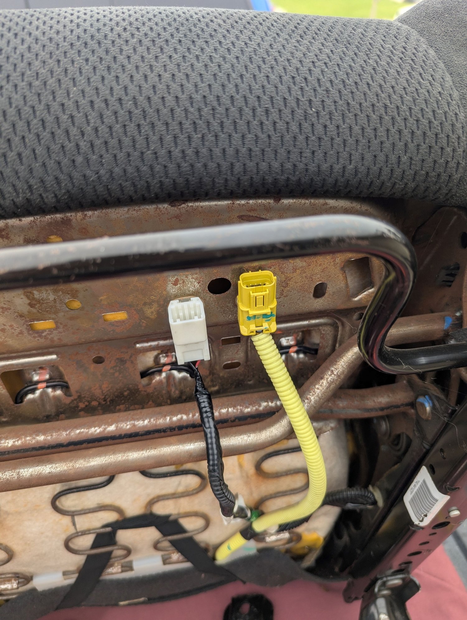

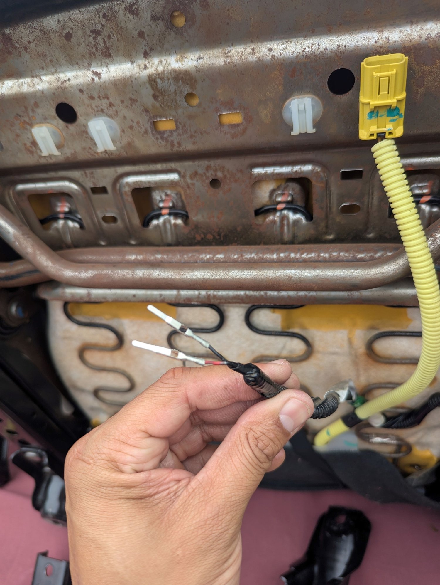

Side by side comparison of the connectors. You have to de-pin the connectors and just swap em.
3 pin connector from Fit de-pinned.
SI connector de-pinned
3 pin connector now on SI seat

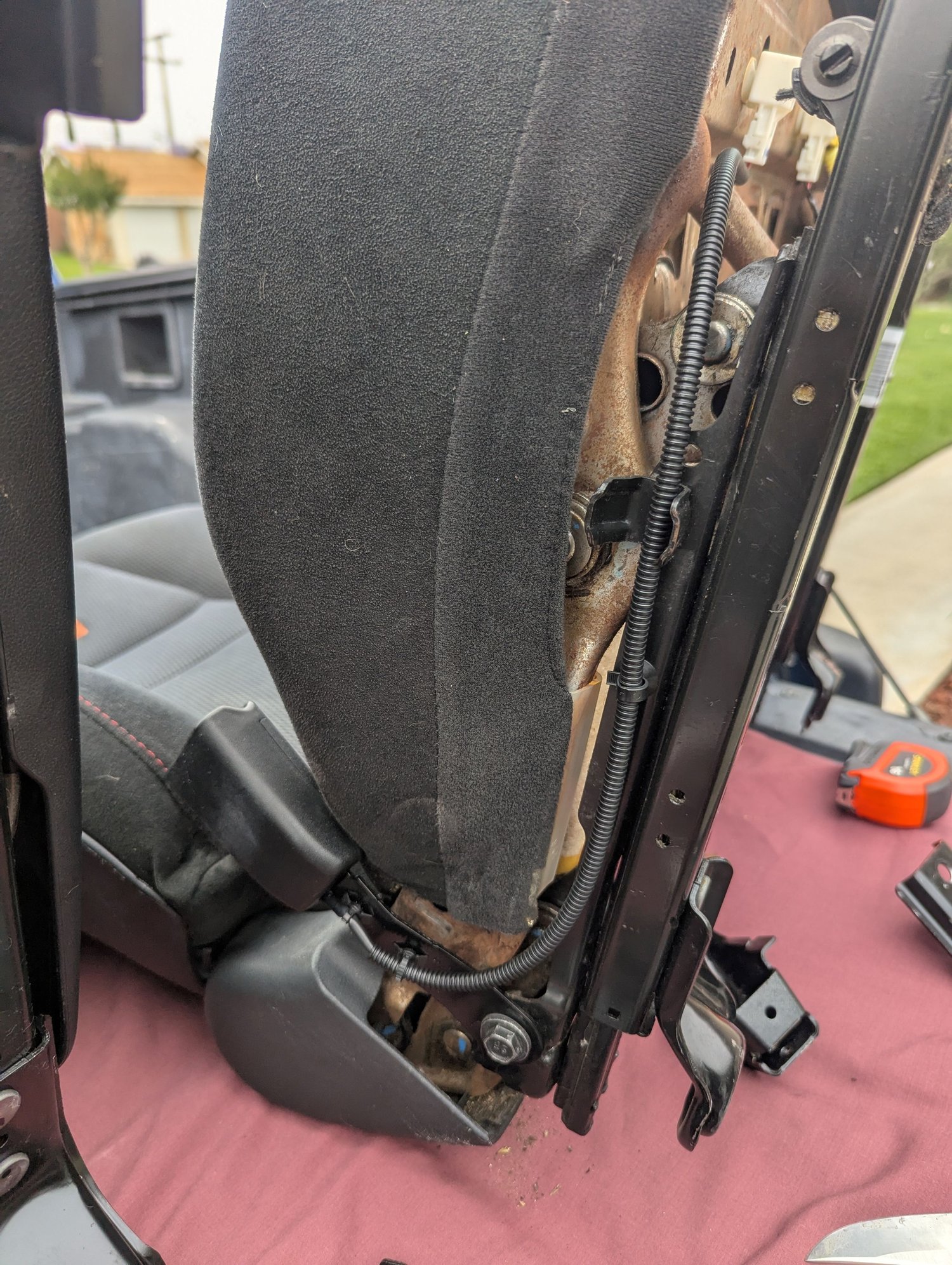

Fit seatbelt on SI seat swap. The harness snaps in perfectly right on the rails.
Fit buckle on SI seat. The harness snaps in perfectly right on the rails.

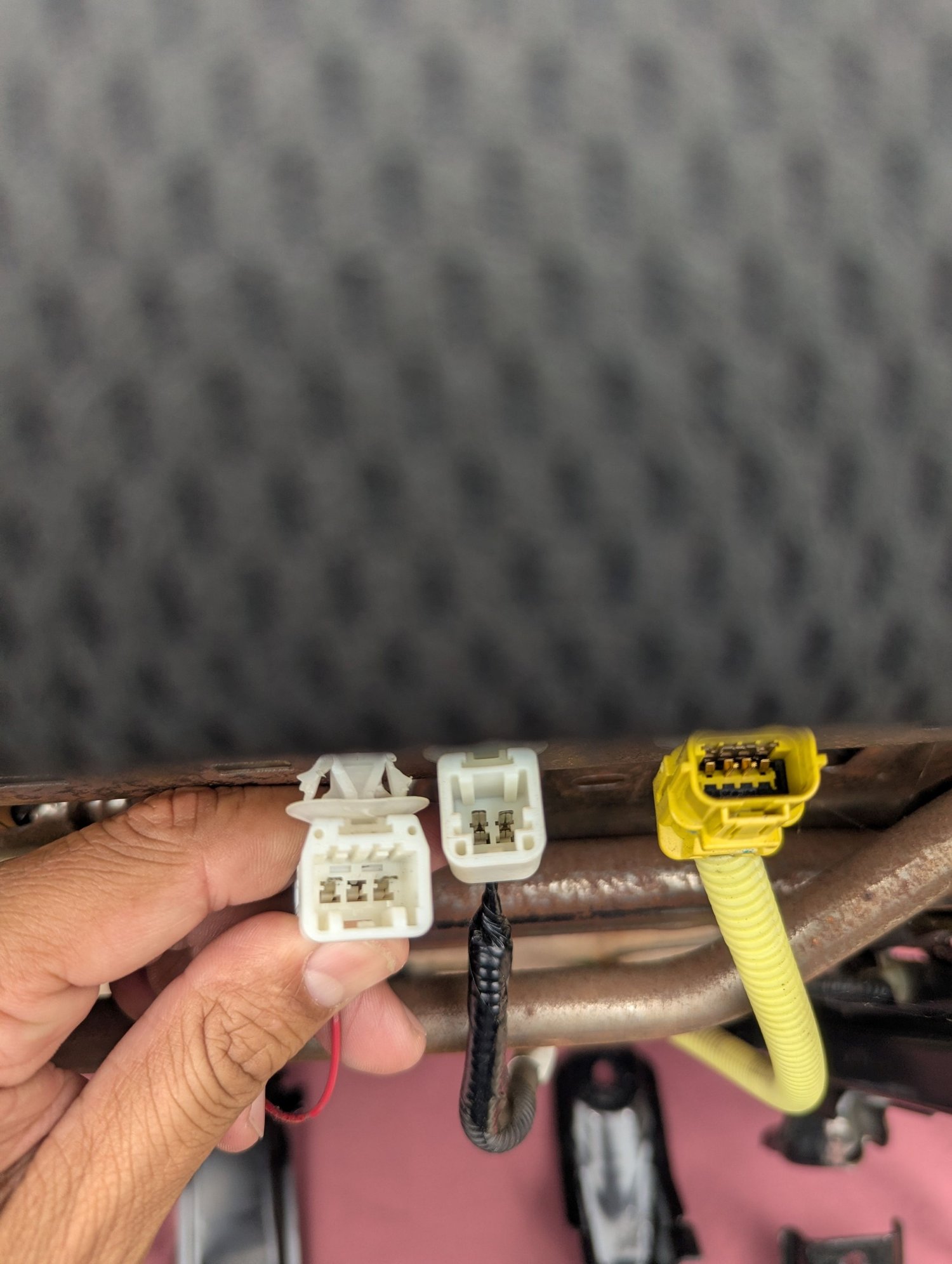

And here is how the 3 connectors look on the SI seat. Left to right - Seat belt, position sensor, and airbag. So technically, all you need to do is swap the seatbelt, de-pin the position sensor connector and swap the seat brackets.
And here is how the 3 connectors look on the SI seat. Left to right - Buckle, position sensor, and airbag. So technically, all you need to do is swap the buckle, de-pin the position sensor connector and swap the seat brackets.

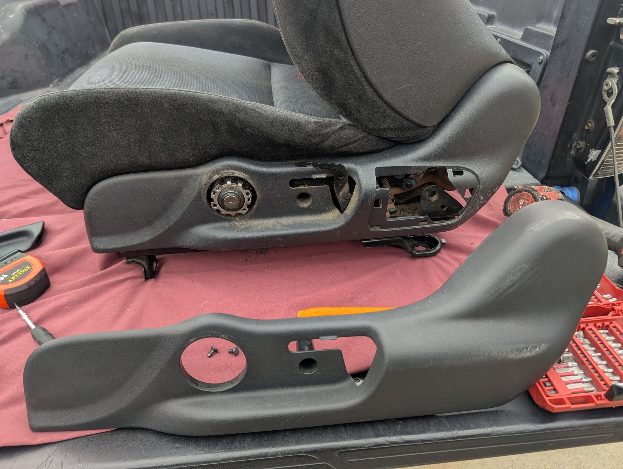

I had found this plastic seat cover at the wrecking yard as well, without the hole for the seatbelt. 8th Gen Civic SI coupe and sedan seats have different plastics.
Side plastic swapped

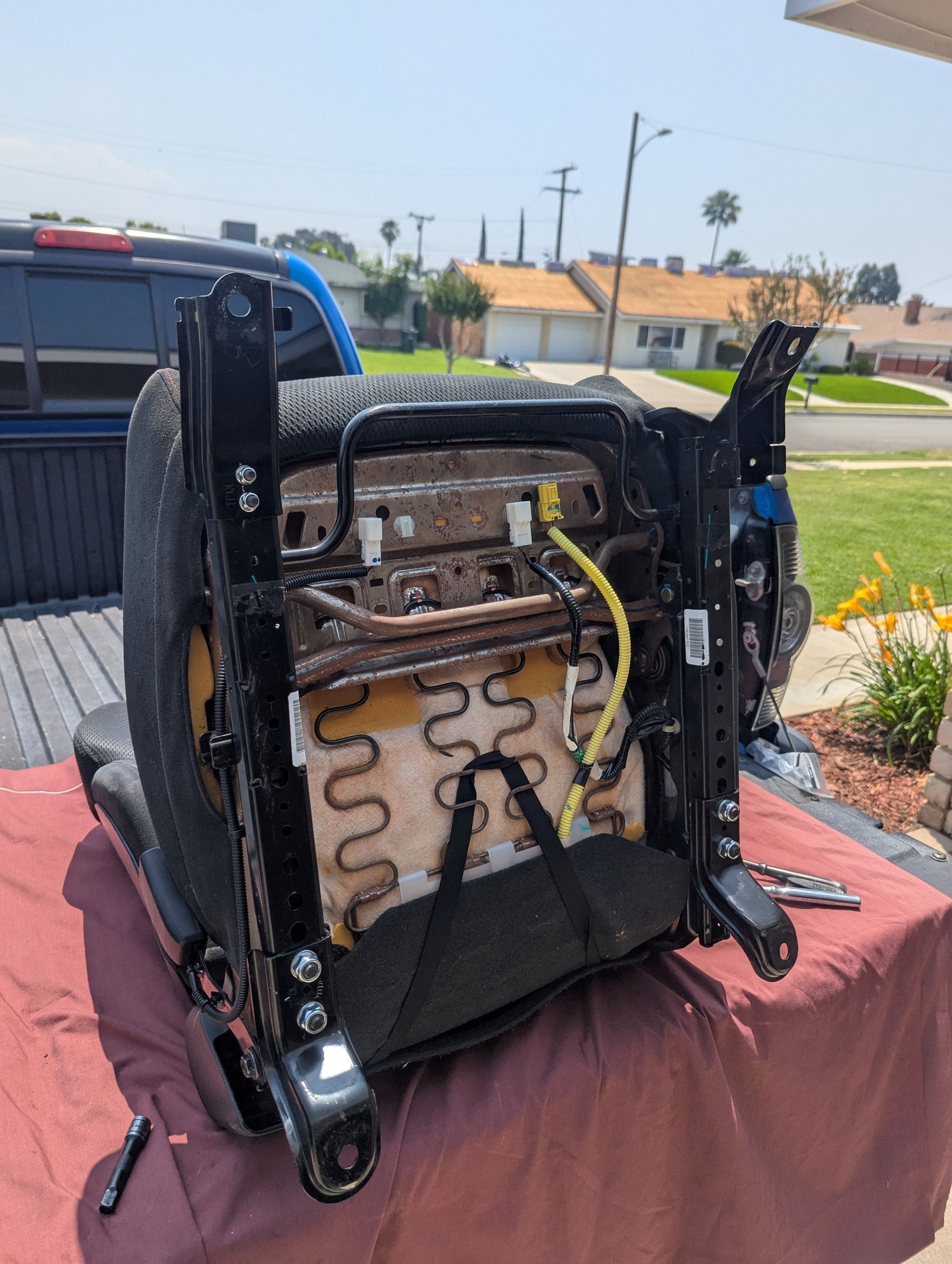

Brackets from Fit onto SI seat. I used M6 button allen bolts for the front and M10 for the rear along with a washer and nylon nuts.
Driver seat plugged and bolted down. Best bart is no airbag light on.

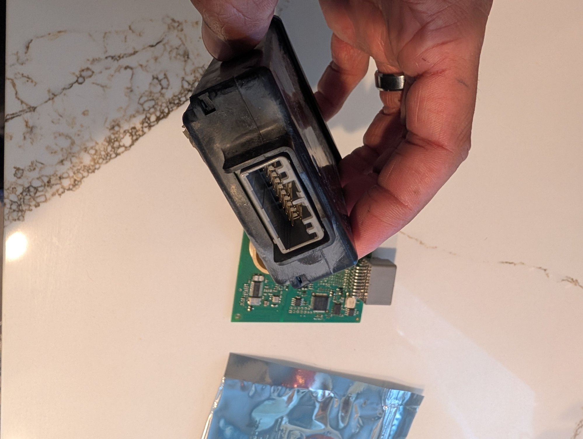

Comparison of Civic SI (left) and Fit (right) OPDS modules.
Opened up the housings and swapped the internals.

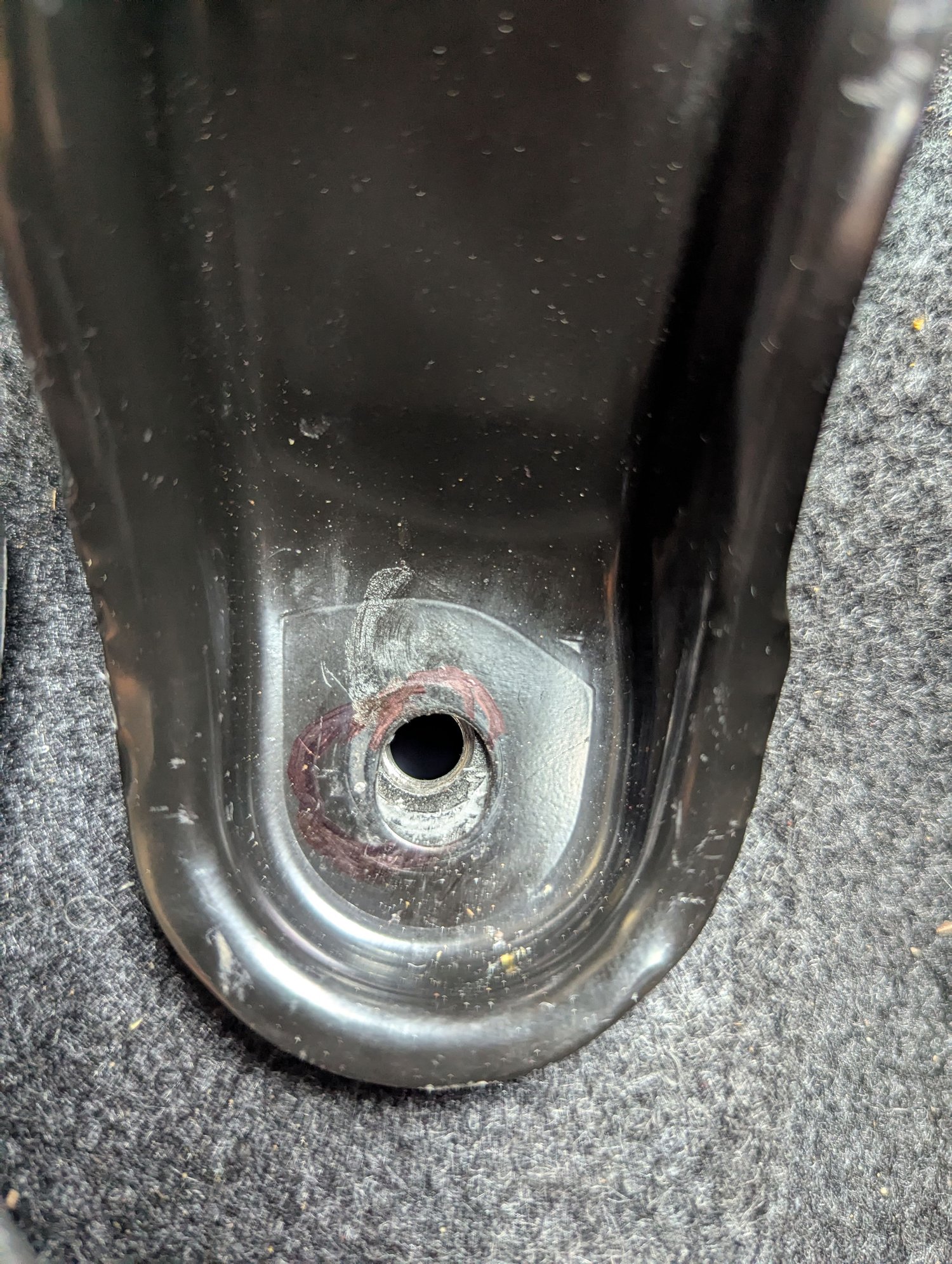

The rear outer bracket has to be slightly enlarged as it doesnt line up properly.
The rear outer bracket has to be slightly enlarged as it doesn't line up properly.
 Something like this
Something like this

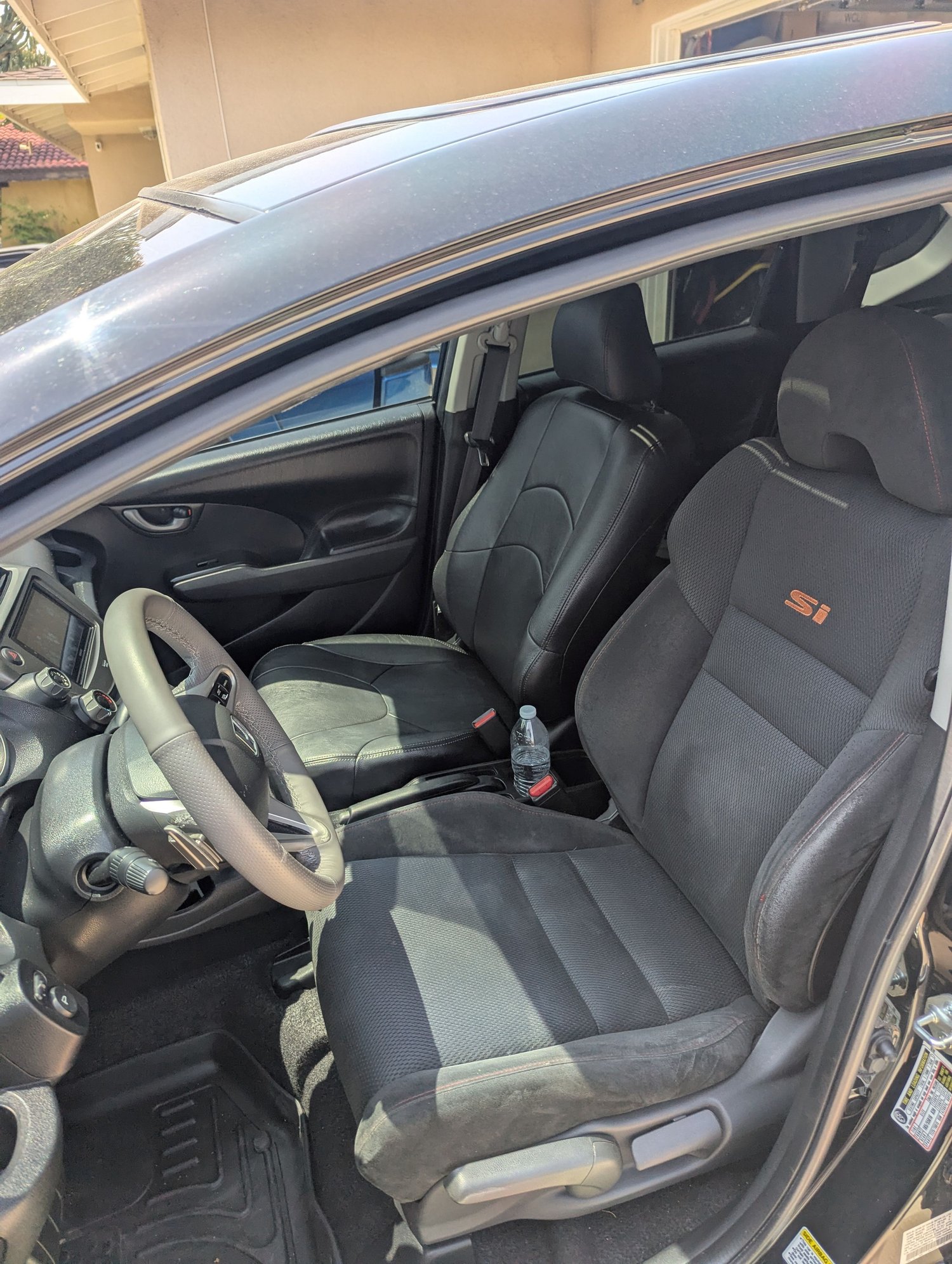

And here is the finished product. Just need the cover that goes where the seatbelt attached.
And here is the finished product. Just need the cover that goes where the seatbelt is bolted to.
