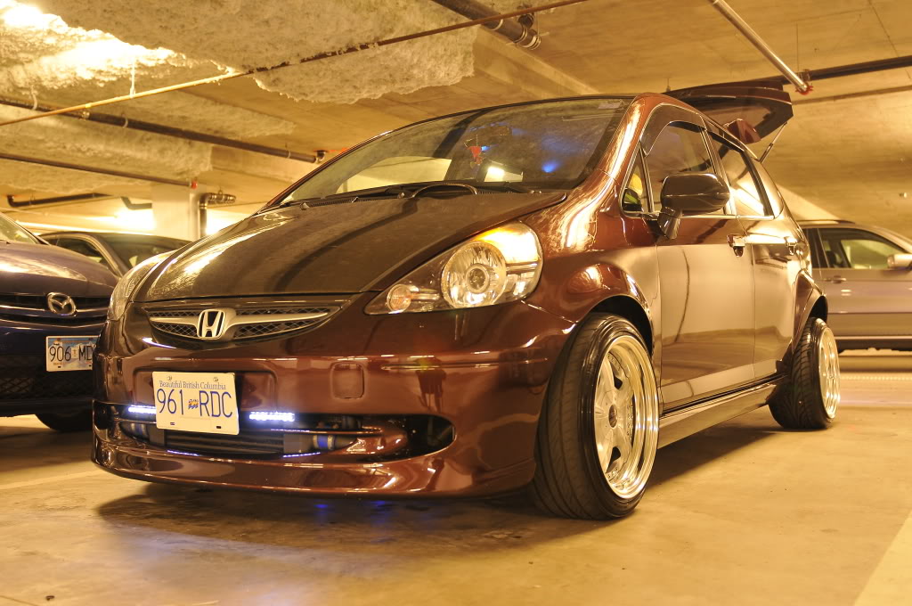

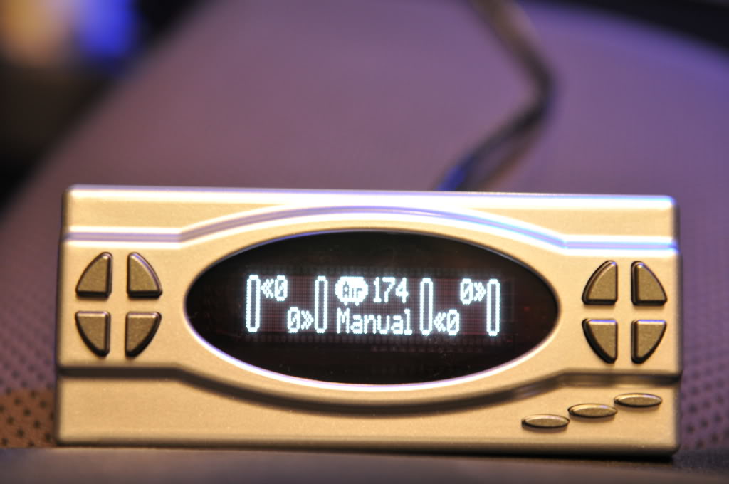

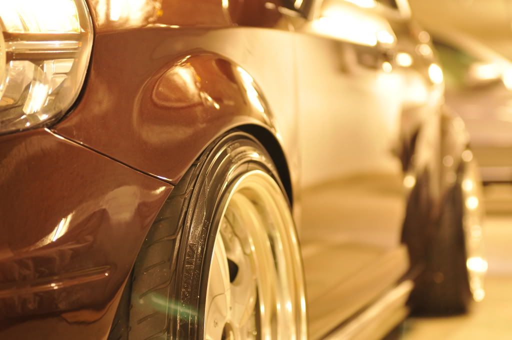

Old Sep 1, 2009 | 06:17 AM
  #663
FELIXY69's Avatar
Posts: 2,790
From: RICHMOND BC CANADA

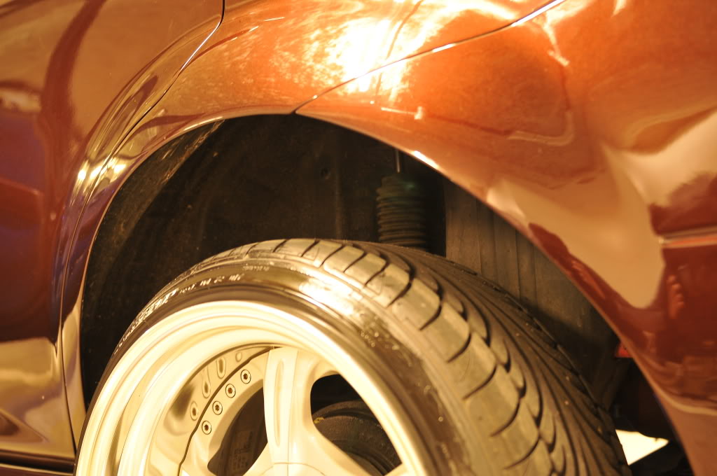

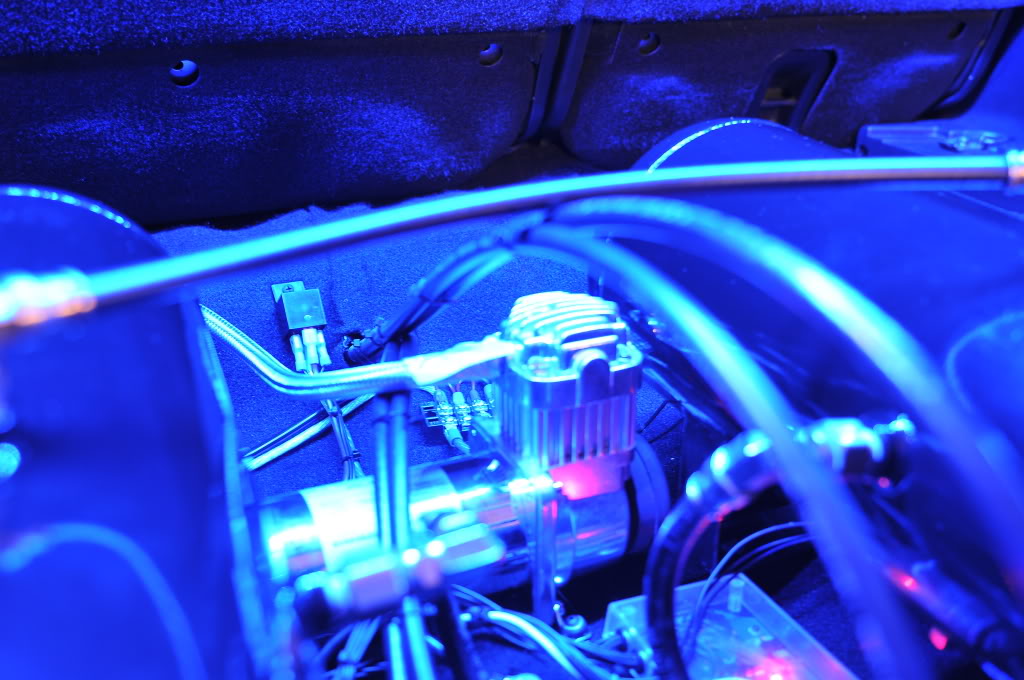

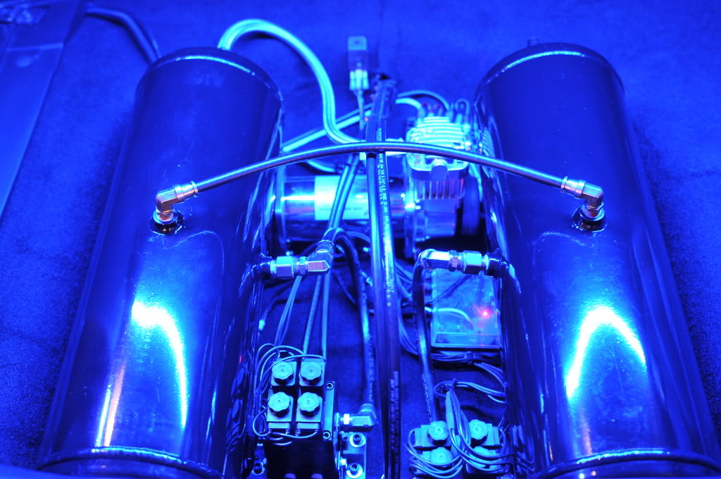

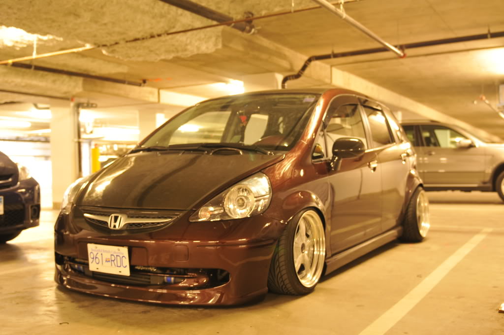

STAGE 1 BAGGING DONE : it goes too high but not low enough and found out MK jetta bags work !!! OMG !
LOW-->not low enough
Old Sep 1, 2009 | 09:42 AM
  #664
mike410's Avatar
Posts: 620
From: Ft. Lauderdale, FL
very nice!
any idea whats holding you up? I am guessing that in the rear the shock is bottoming out, I cant see the firestone being too large when fully compressed. The front is probably aerosport clearance issues or the megans dont thread low enough.
hopefully you get things sorted out and get those wheels on your fenders

Old Sep 1, 2009 | 11:40 AM
  #666
515's Avatar
515
Posts: 129
From: Indo
woh.. NICE..
to bad u can't get the tyre tuck inside the fender...
this problem also happened on my last bag set-up on my merc. end up cutting the bracket shorter.
prob u could solve the rear by shorten the bracket, & get some smaller/shorter bag for the front.
I'm also getting a bagged suspension for my GE very soon.. very soon..

They dont make a shorter bag for the front and the rear brackets are quite small and are machined from aluminium so they wouldnt be the easiest to cut.

Hey felix, ur car looks like a mexican low ride all raised up.. hehe. but everything looks great and i love the control system its cool

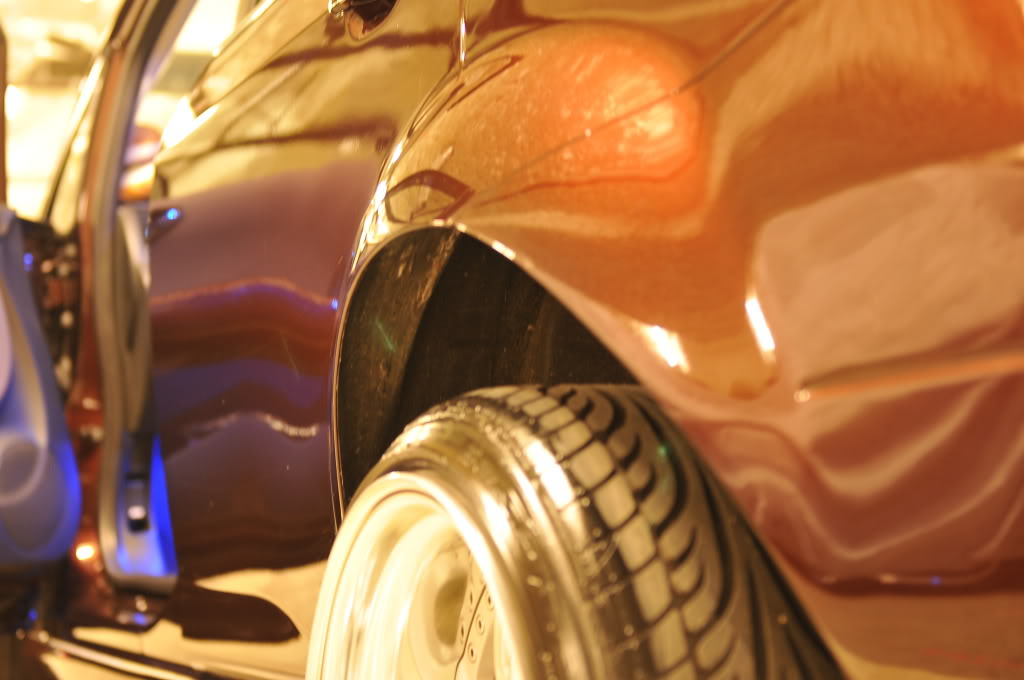

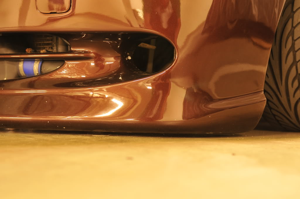

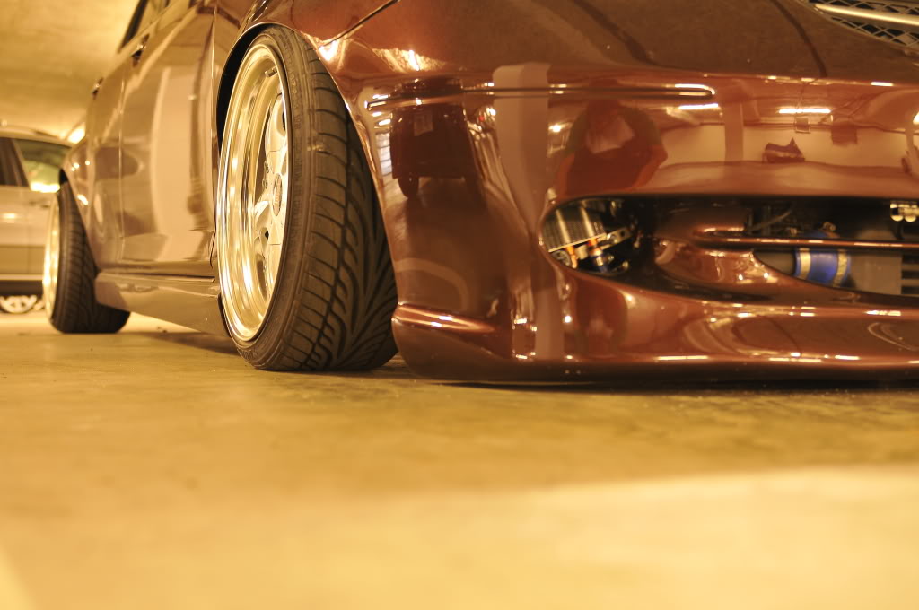

Old Sep 10, 2009 | 11:45 PM
  #673
FELIXY69's Avatar
Posts: 2,790

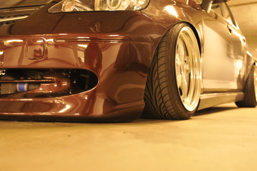

Prepare to Jizzz in ur pants...cuz it's on the ground !
SUPER THANKS TO OUT LAW CUSTOMS ! in Richmond for their work machining skills !
$400cnd later i am on the ground !
the rear will be done very soon
Old Sep 10, 2009 | 11:50 PM
  #674
chickz_magnet's Avatar
Joined: Mar 2006
Posts: 733
From: Coquitlam, BC, Canada
FINALLY!!!
get the rear done already! lol
Old Sep 10, 2009 | 11:52 PM
  #675
mike410's Avatar
Posts: 620
OMG what did they do
please tell us and post pics if you have any
car looks sooooooooooooooooo amazing!!!
Old Sep 11, 2009 | 12:09 AM
  #676
dewthedew's Avatar
iTrader: (9)
Posts: 4,055
From: HollyHOOD, fl
dope!!! +1 rep for dopeness.

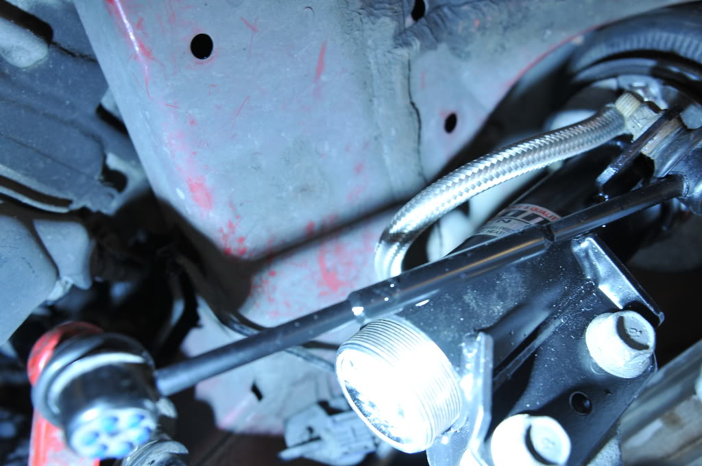

Old Sep 11, 2009 | 01:10 AM
  #677
FELIXY69's Avatar
Posts: 2,790

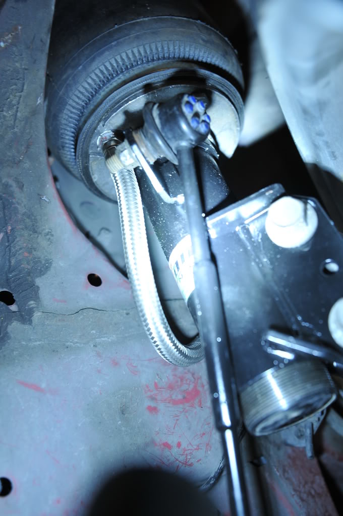

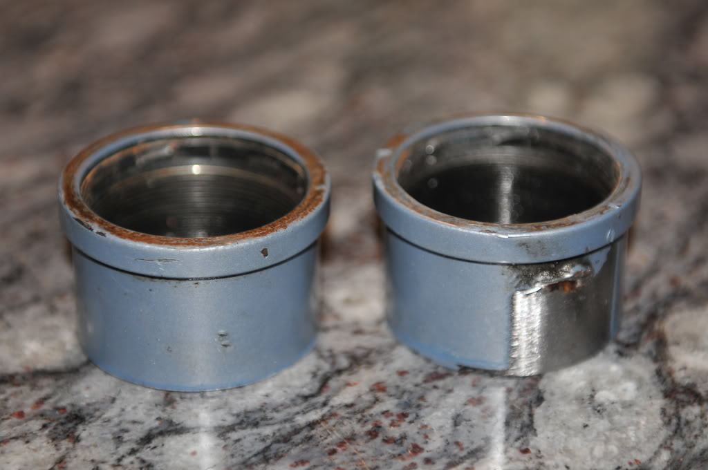

here's what " OUT LAW CUSTOMS " did
i have megan coilovers, and the legs were too long so they machined about 2" off the top off on the legs and then re machined another ring on the of the shorten legs
shorten the sway bar end links and
next week or so they are going to make me a billet top hat so i can go really high and drop reall low !
more coming soon
55% done 85% more to go
here are the bits that was cut off

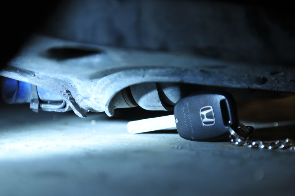

Height from the sub frame

shortened megan racing coilover + Aerosport bags
