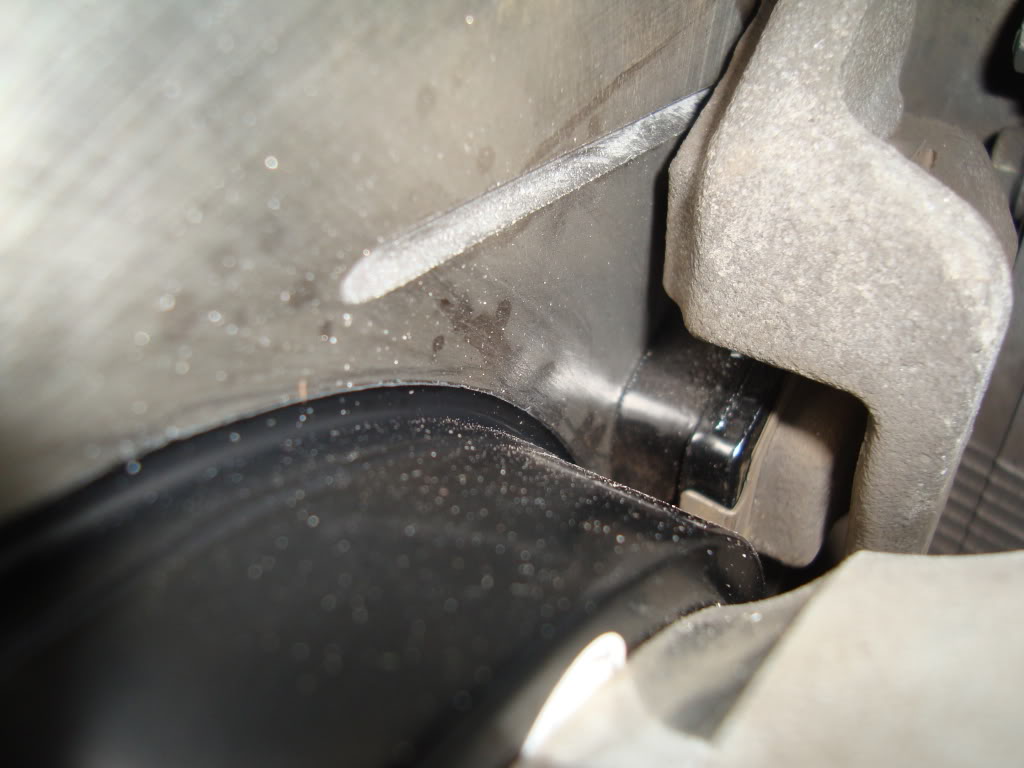

finally after 56000kms of city driving, my oem brake pads finally reached 20% life left
time to upgrade...and too bad i can't fit the spoon calipers or T1R calipers with my wheels
so this is the solution
Hawk HP Plus pads
Power Slot rotors

why can't you get t1r or spoon calibers?
get new wheels!
Old Jun 17, 2010 | 10:08 PM
  #887
FELIXY69's Avatar
Posts: 2,790
From: RICHMOND BC CANADA
get new wheels!
they are too big for the low off set wheels i have....and i would not give up my low off set wheels for brakes..

low offset should give more clearance, are you brakes low disk?
no low off set gives less clearence.

I'm sorry but I think you're wrong
I'll give an example, My old galant came stock with a +46 offset, in order to fit Evo Brembos we needed to run around a +35 offset
It's all about spoke design and the presence of a lip
Old Jun 19, 2010 | 09:53 PM
  #893
Fit4Trav's Avatar
Posts: 3,860
From: Chino, Ca
It all depends on the size of the wheel too. What width were your galant stock wheels.
A x6 +35 has way different clearance than x7 or x8 +35
Old Jun 19, 2010 | 10:03 PM
  #894
Gbaby2089's Avatar
Posts: 5,346
From: Small Town WI
yeah i thought about that after posting, but there a 9.5" wheels that wouldn't clear evo brembos because the wheels were flat face with a huge lip

The offset wouldnt be the case. It's all about the spoke design, full faced fat lip or less lip outer spoked. I run no lip and have a TON of clearance, but that was also the look I was going for.

cool, good to learn new info, but the fact is we tested those and won't fit, so i guess my wheel designs won't allow me to fit big brakes
