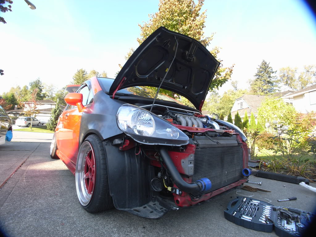

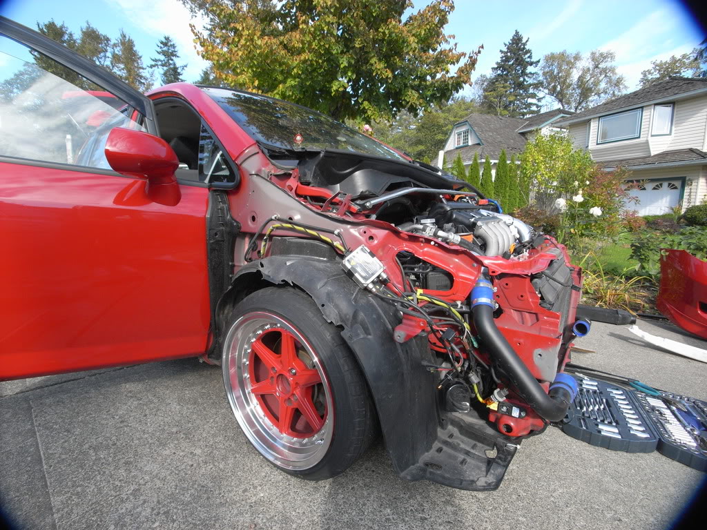

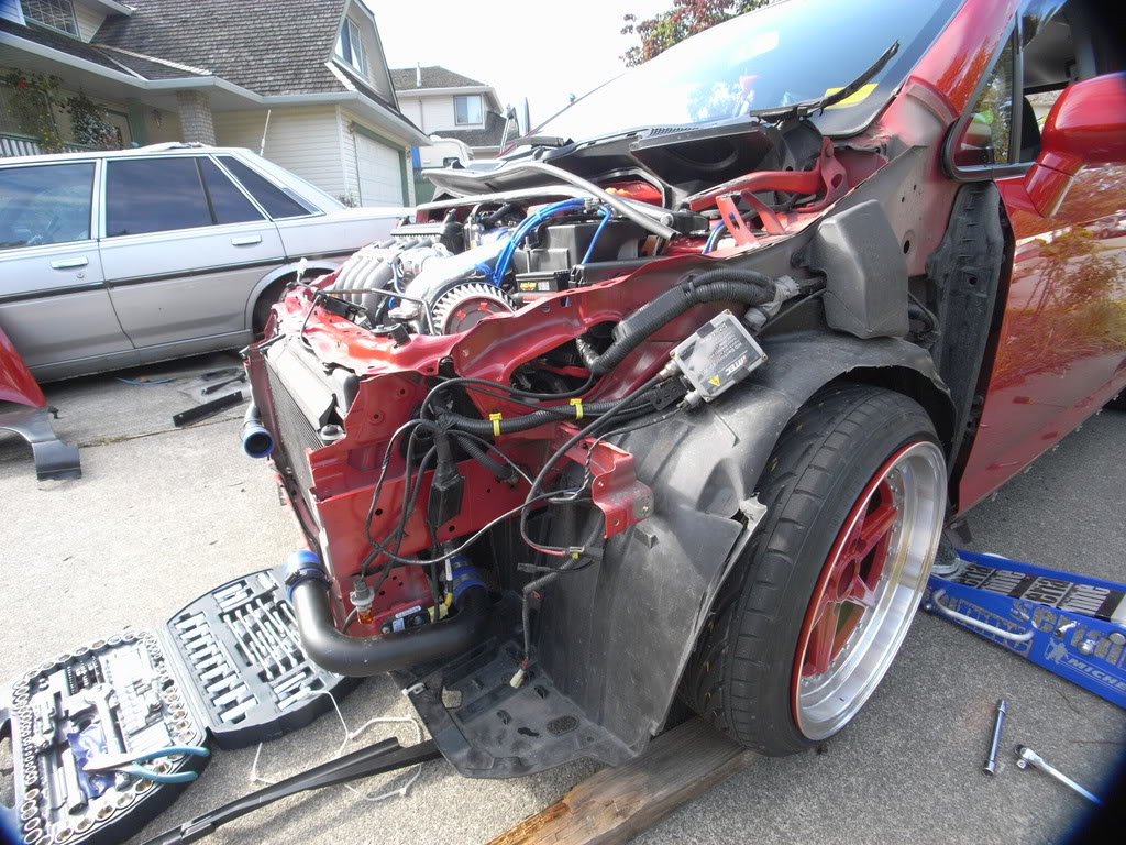

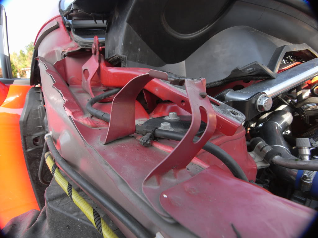

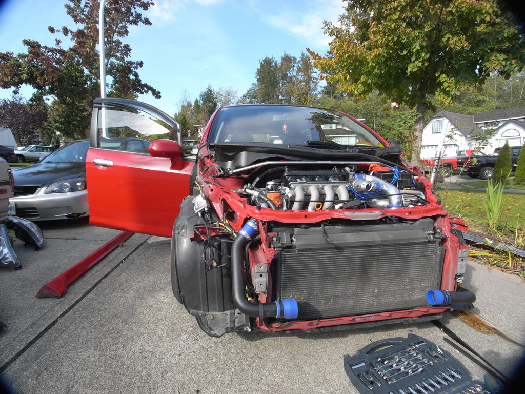

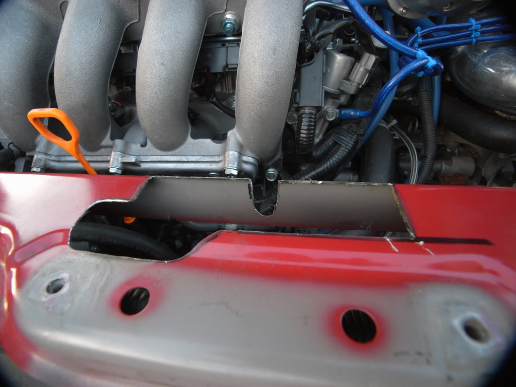

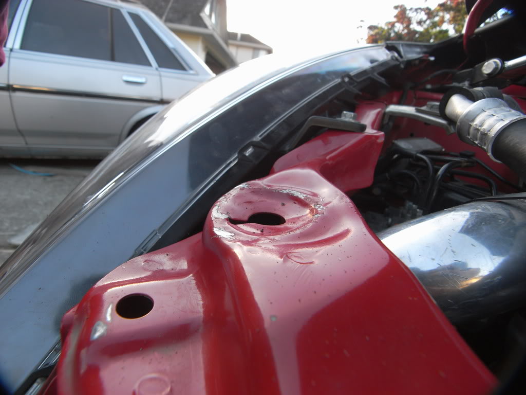

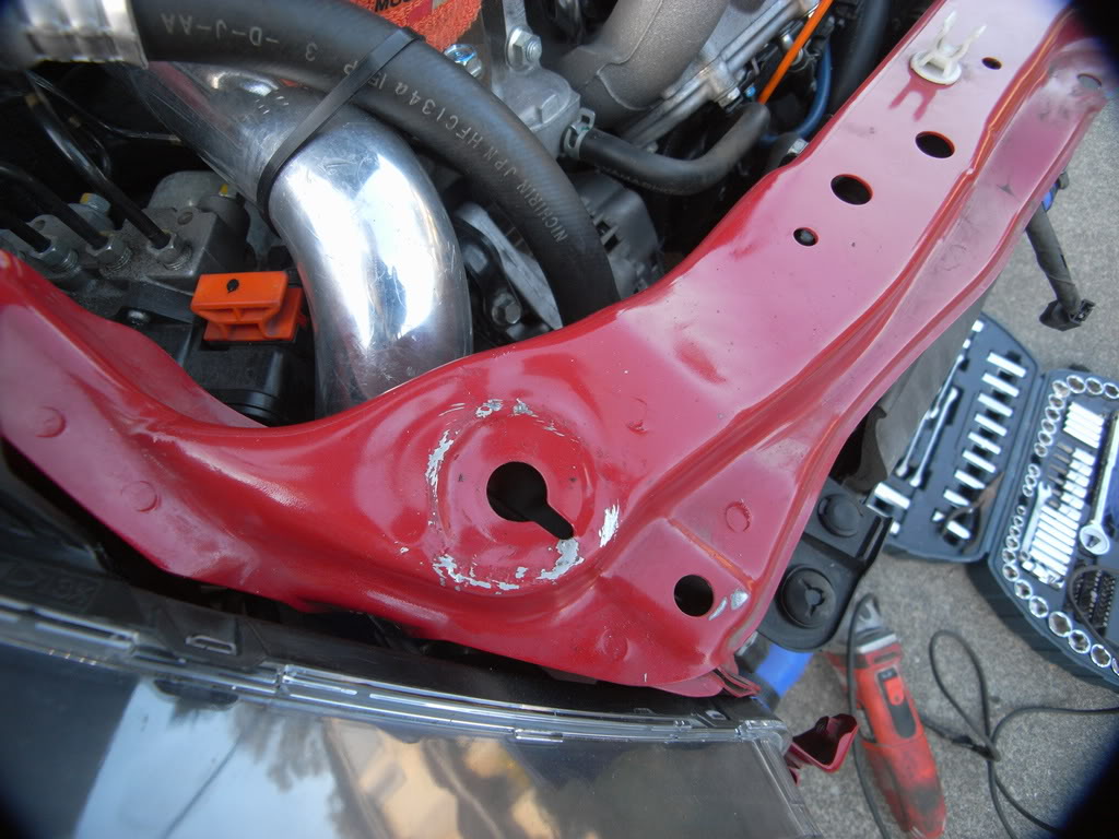

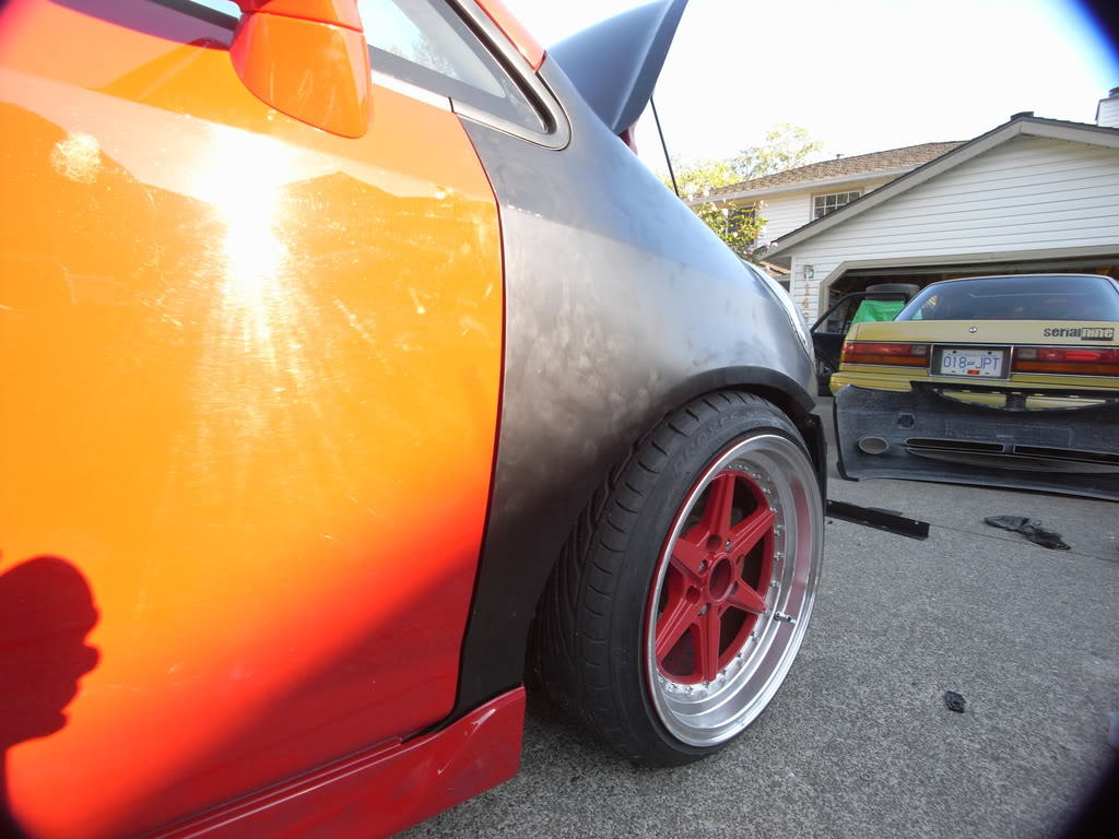

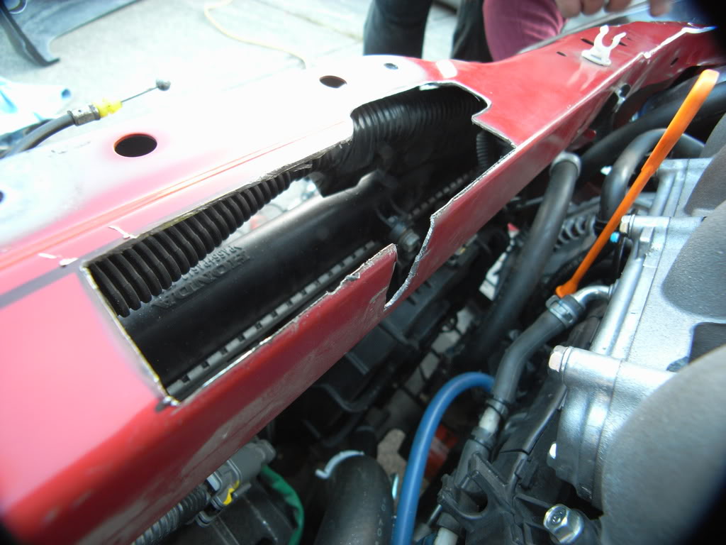

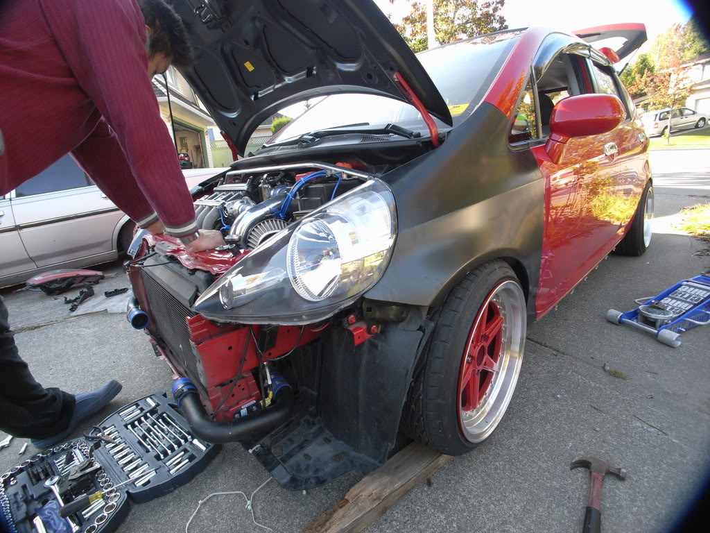

Update !!
well yesturday was a very sunny but SUPER cold day here in Vancouver so i decided to work on the car outside......
did half the JDM conversion on the front end and will finish it this week !!
here are the pictures

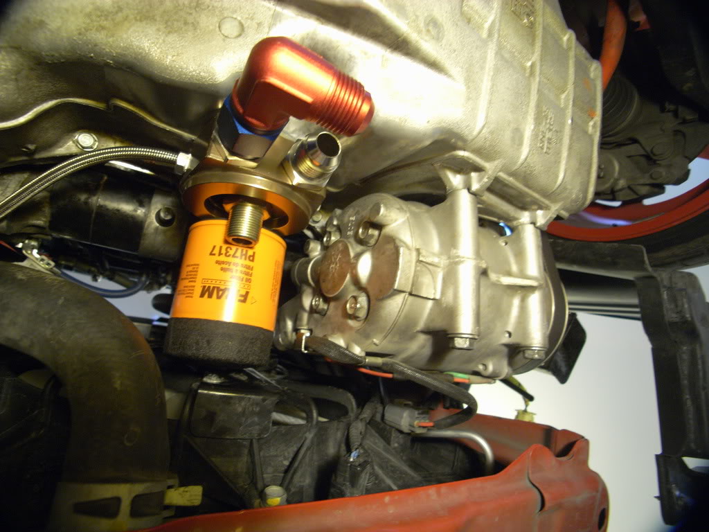

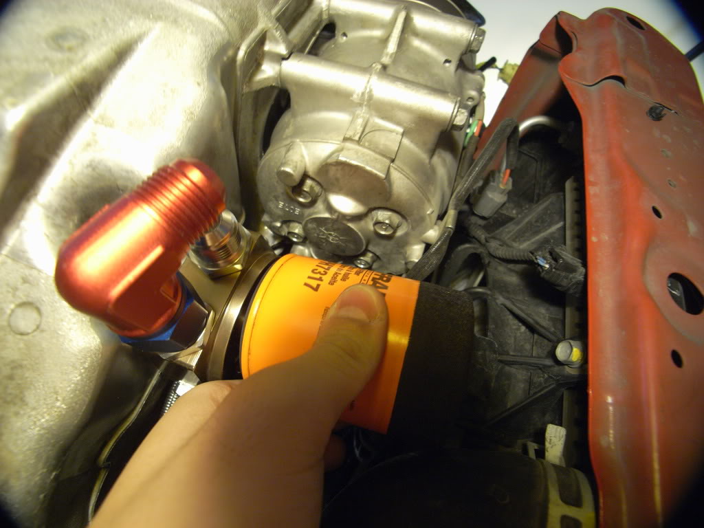

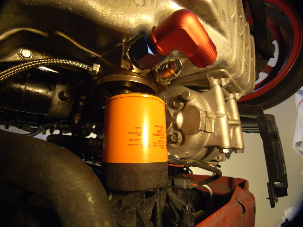

also tried installing the oil cooler kit from T1R...but didn't fit...because the oil filter will hit the fan

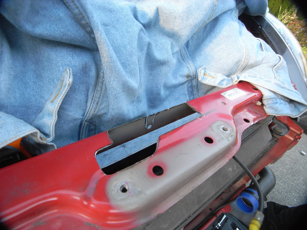

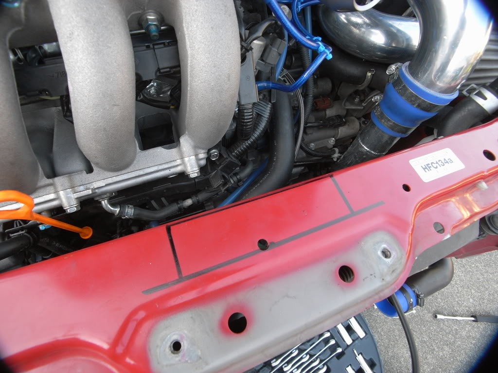

sick man really sick what all is needed for the front end conversion do you need any rad supports or just the fenders hood bumper and lights?
Old Oct 14, 2008 | 12:37 AM
  #115
R@ymun2's Avatar
Posts: 570
From: Miami, FL
Just wanted to ask if you have any vids of your fit after the turbo install?? I would love to hear how it sounds..
Old Oct 14, 2008 | 04:08 AM
  #116
FELIXY69's Avatar
Posts: 2,790
From: RICHMOND BC CANADA
Damn its coming together.
Real nice...
Still interested in your fenders. Im just scared of the shipping cost. :-/
P.S. Fram FTL.
ray
I'll sell them for $250usd shipped
pm me !!
Old Oct 14, 2008 | 04:11 AM
  #117
FELIXY69's Avatar
Posts: 2,790
Its slow and its not worth it
I am hoping to do k20 soon so I'll take vids then
Old Oct 14, 2008 | 04:18 AM
  #118
FELIXY69's Avatar
Posts: 2,790
if you are baller then u should get rad support our wise u do what I did
cut out the bak of the rad support and mount the hood latch there and hammer down the side of it and make the hood fit then gehtto bolt the jdm bumper support on but btw jdm bumper support will not do anything in any accident and it doesn't hold the bumper on either so its just extra weight
Here is a list of things u need to complete the jem front end
jdm fenders
jdm hood
jdm headlights
jdm rad/bumper support
jdm bumper
note: ur hood support bar will not work so u gota get the t1r hydro strut to hold the hood up
