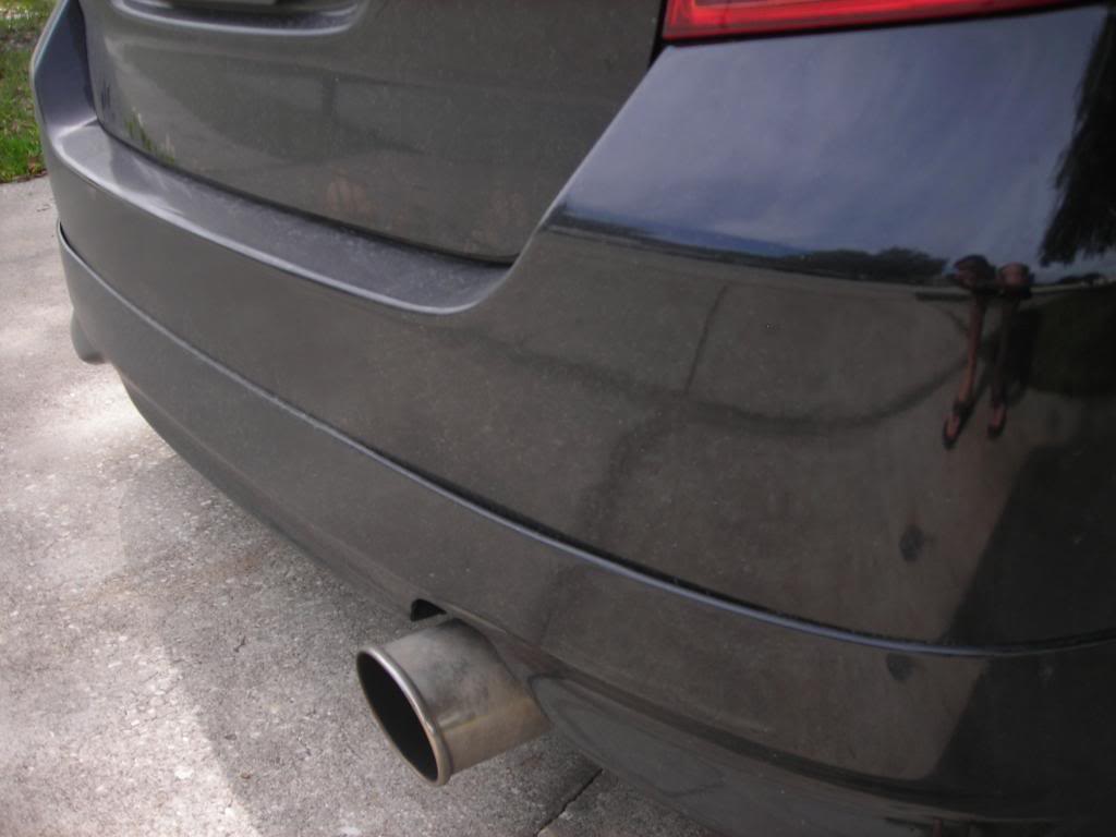

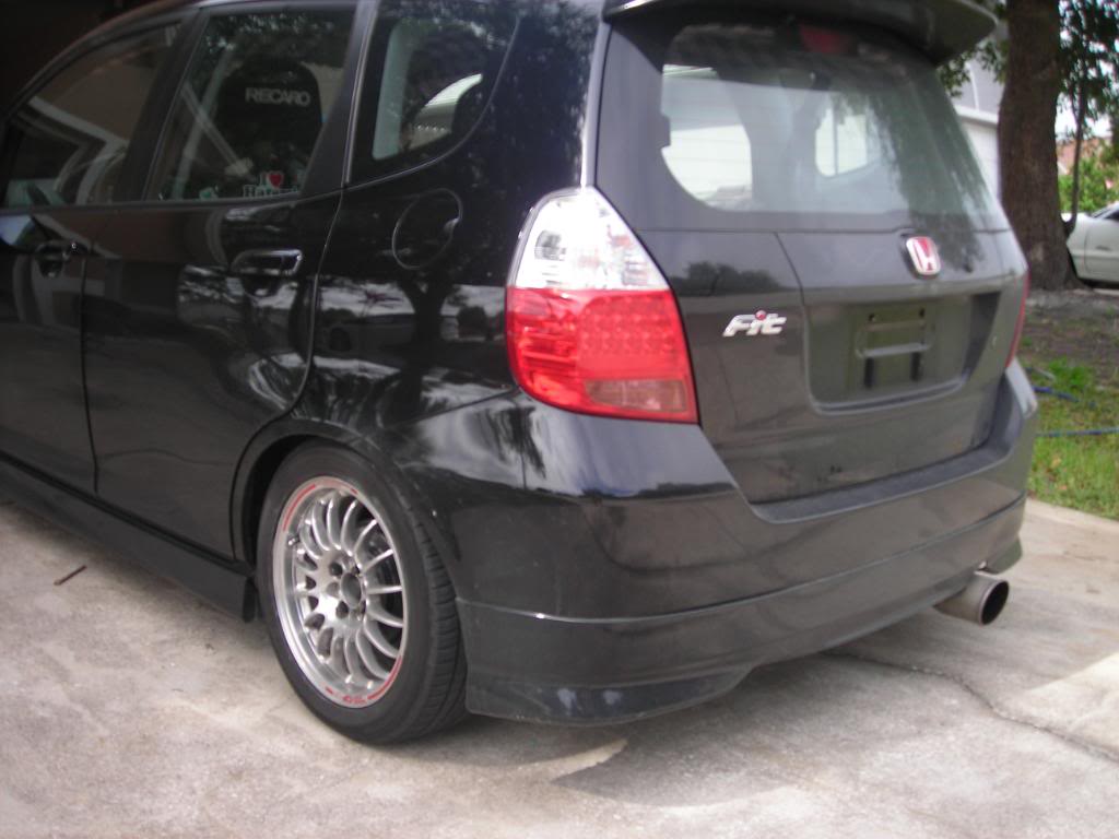

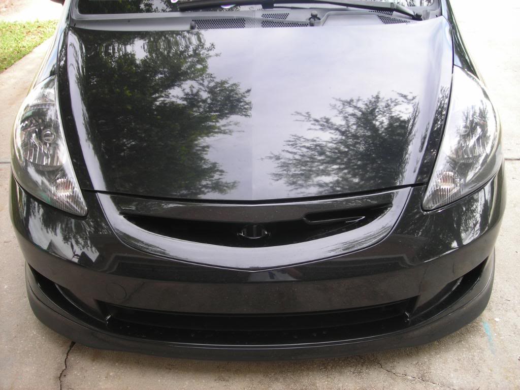

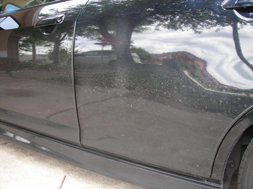

Detailed her car about a week ago but couldnt get after pictures as I worked through the night. She just sent me some decent after pictures as it literally hasnt stopped raining since last sunday.
Car was in pretty rough shape but not too bad overall. Just really dirty considering the drive from miami.

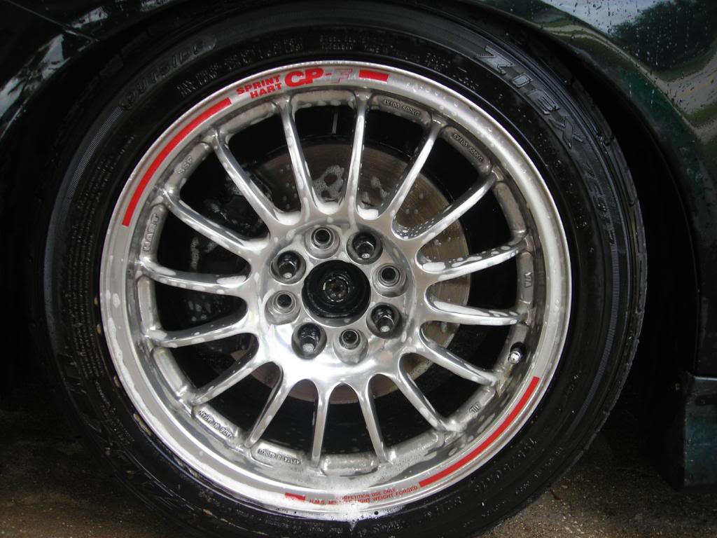

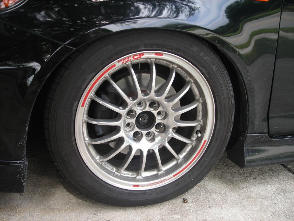

Letting the P21 wheel gel soak in

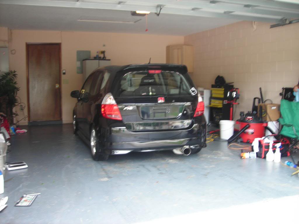

Tucked away in the garage before it started to rain

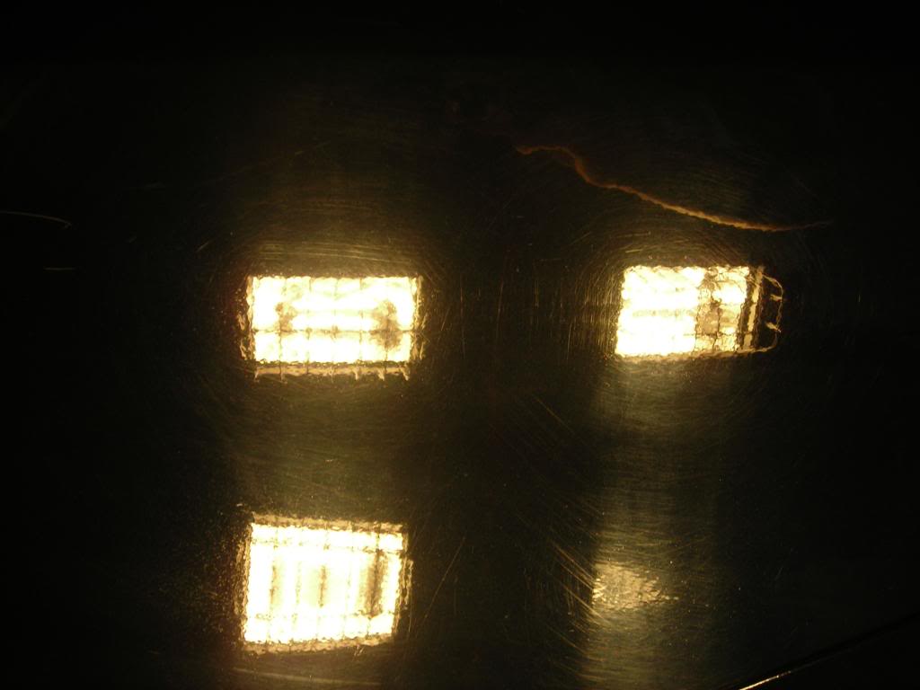

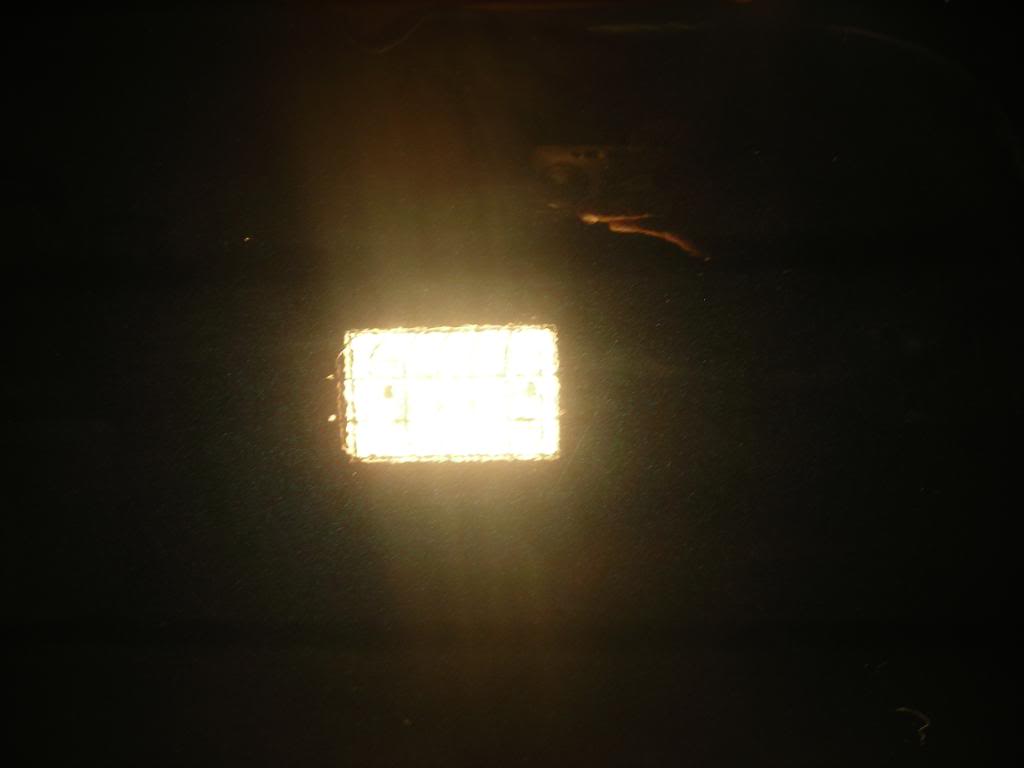

Swirlage

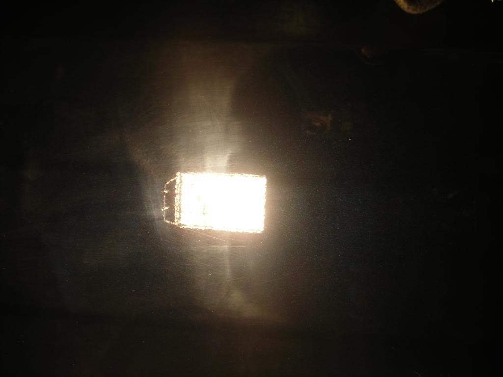

Can you guess which side is done?

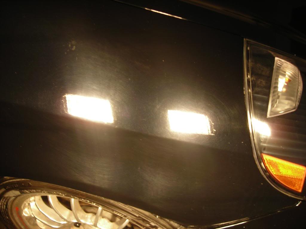

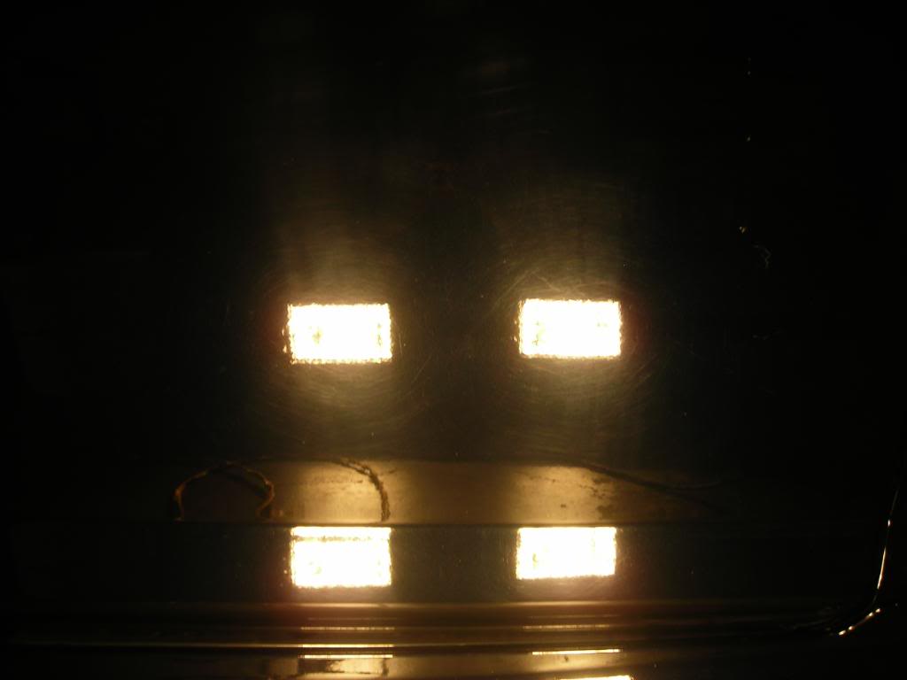

Only after shot I got in the halogens

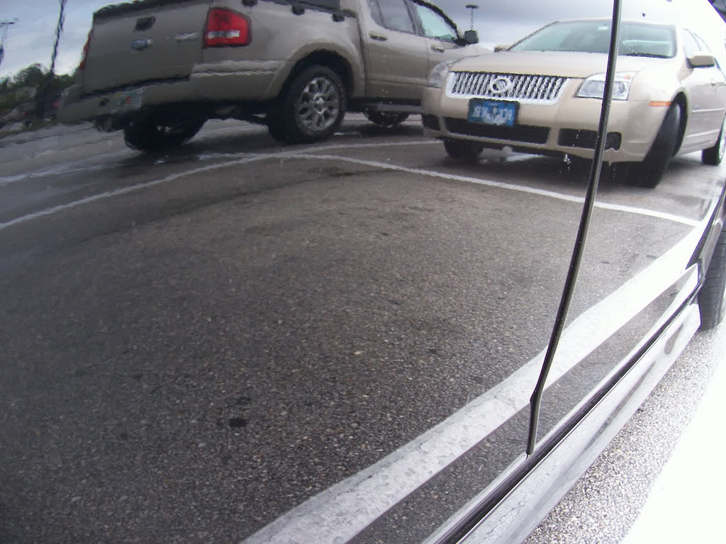

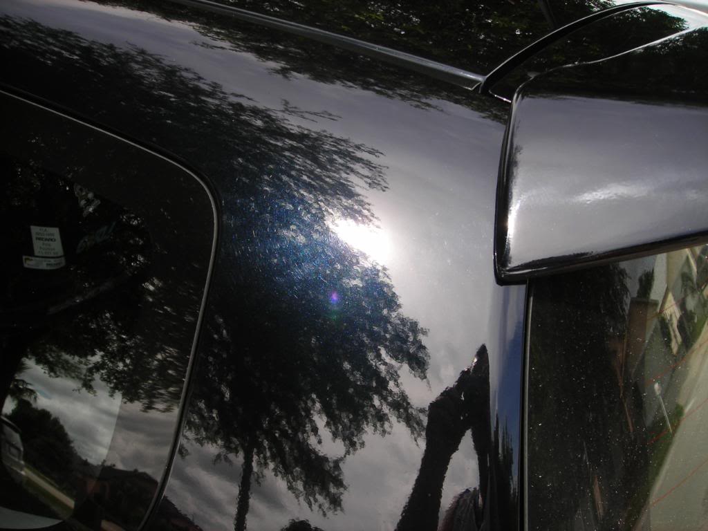

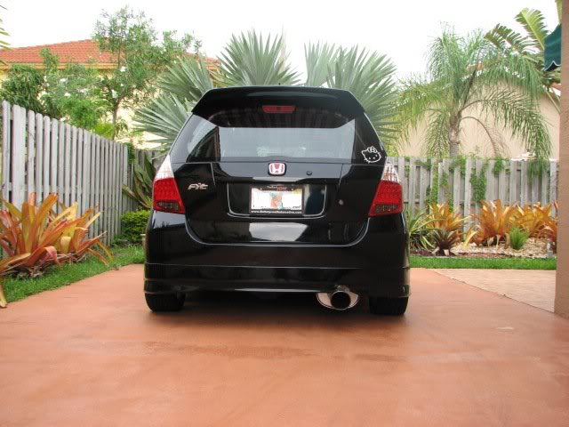

I finished around 10 and it was raining so I didnt take any pictures of the car itself but heres the ones she sent me.

Well I do a different kind of detailing. Its not just wash and wax. This is a full paint correction that took me about 8 hours. Involves using a porter cable and various pads and polishes. Heres my procedure though.
Washed car using 2 bucket method and poorboys world super slick and suds. After the wash I sprayed FK #1119 paint decontamination spray over the entire car and let it soak for about 20 minutes. After that I rinsed it off and washed it again with super slick and suds. Used P21 wheel gel for the wheels and optimum power clean for tires and other various heavily soiled areas like around the wheel wells.
After that it was dried using my 265mph leaf blower and put into the garage. Clayed using zaino Z18 and optimum quick detailer as clay lube. After that was done I did an isopropyl alcohol wipedown to remove any oils/water to get down to the bare paint.
For polish I used a 4" white pad and menzerna 106fa which is a very mild polish but will do just fine for Honda paint. After several hours of polishing I wiped it down with menzerna final inspection to make sure all the swirls and hazing were gone. Started adding the protection with duragloss aquawax (my new favorite product). Let that cure and added M21 meguiars synthetic sealant, then some optimum car wax. And after everything cured I gave the car a final wipedown with FK #425 quick detailer to remove any wax that was left and give the paint some more gloss and slickness.
Used stoners invisible glass for the windows and adams VRT for the tires and trim. Cleaned door jambs with meguiars ultimate quick detailer. Used rejex to seal the wheels.
