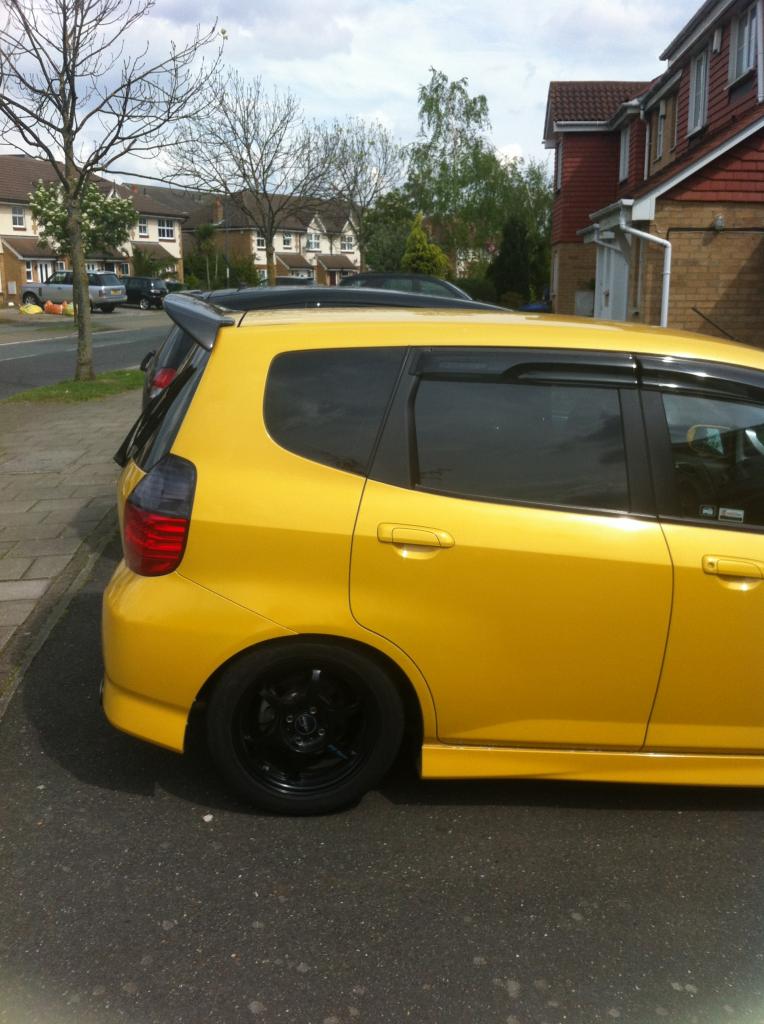

Its been a while since I've updated my build so here's what I have done in the last couple months

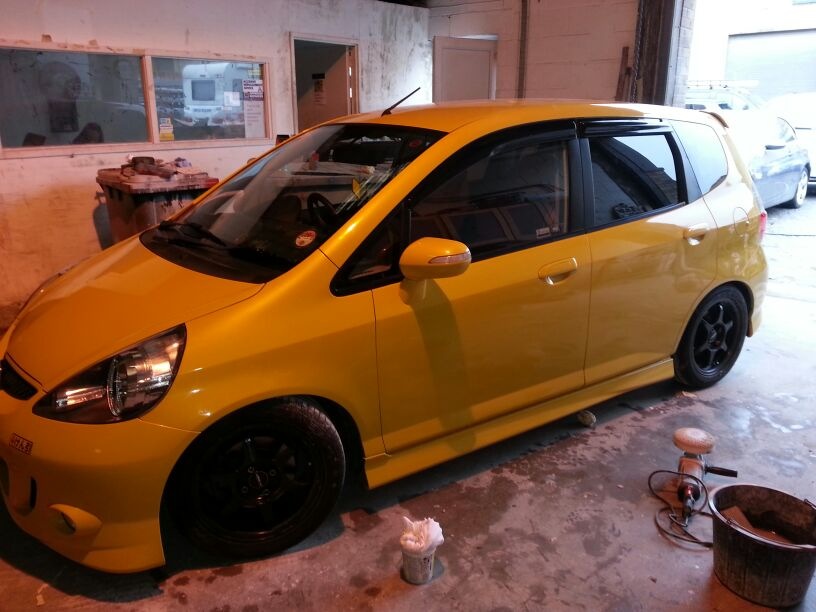

Finally lowered with BC Racing coilovers!
I can still go lower at the rears but its low enough for me at the moment while i still use this daily for work.
Overall I'm happy with the coilovers. I've got the pre load settings to 7 clicks(from hard) which gives me good comfort without compromising the handling.
Still get a little rub from the fronts when turning hard but will higher it a little once i get a lip so hopefully that should sort it, otherwise will roll fender lining or arches.

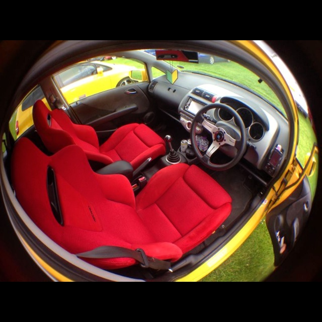

Next was Nardi 330mm deep corn silver spokes with HKB 70mm boss.
Bought this on a group buy from tegiwa
Used a 2.2ohm fuse with the paper clip reset trick to bypass srs light
Can not fault the quality of this steering wheel. Now driving feels so much better than oem
EP3 anniversary recaros arrived and was mint condition with no signs of wear.
I gave it a once over with some foam shampoo to get them smelling fresh!
Bride RO rails arrived!! Courtesy of Mathew from injectionimports.
Couldn't wait to install these!
Done!
Used 2.2ohm fuse again for both seats to bypass srs light and worked a treat.
Needless to say they feel a lot better than oem seats and they hug you nicely around bends.

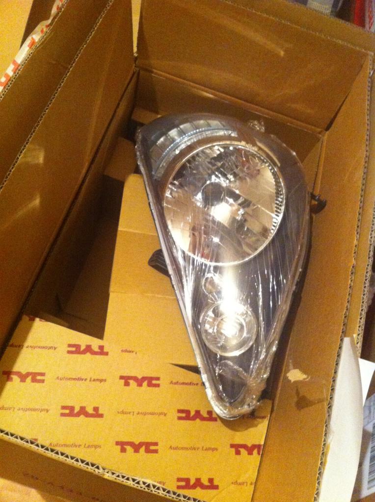

Wasn't too fond of the colour coded head lights so bought some oem black head light housing which imo makes the front look a lot more nicer

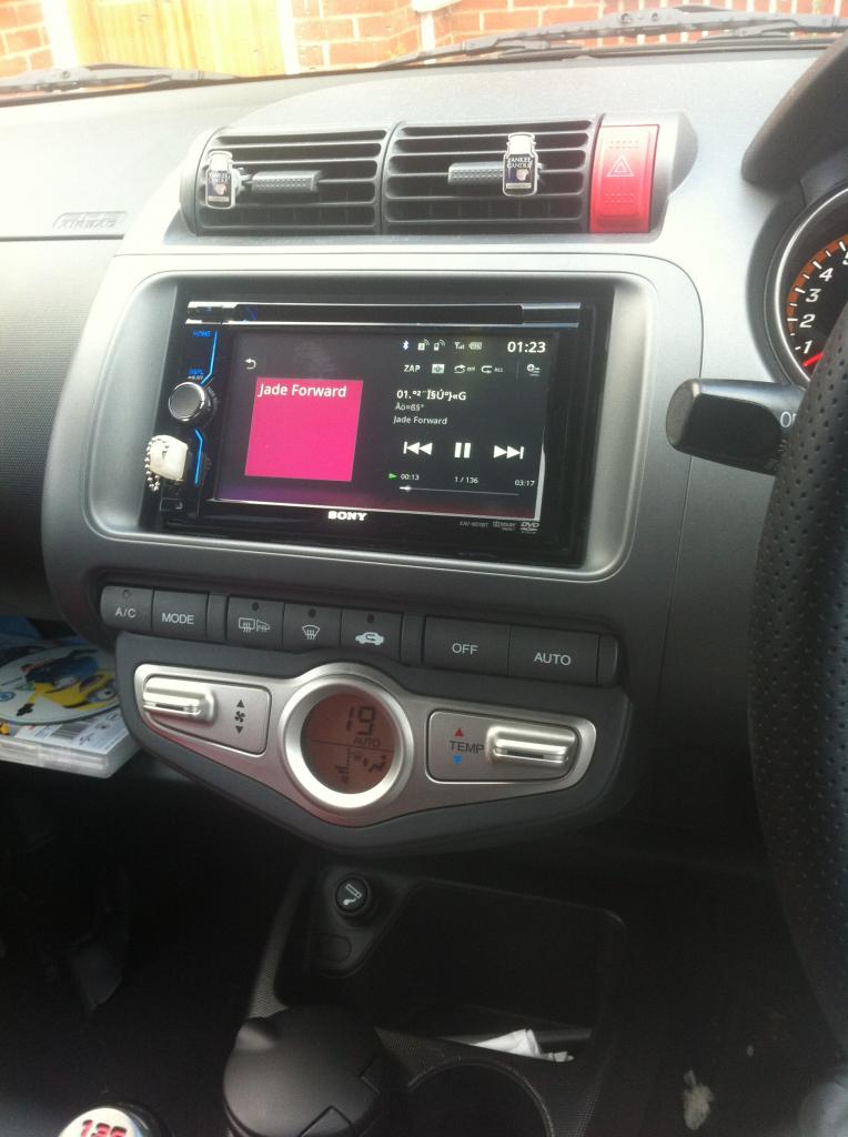

Double din fascia from Honda and a Sony XAV-601bt touch screen head unit

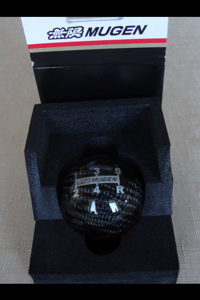

Mugen carbon gear knob

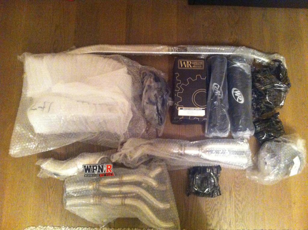

Lots of goodies from the states!

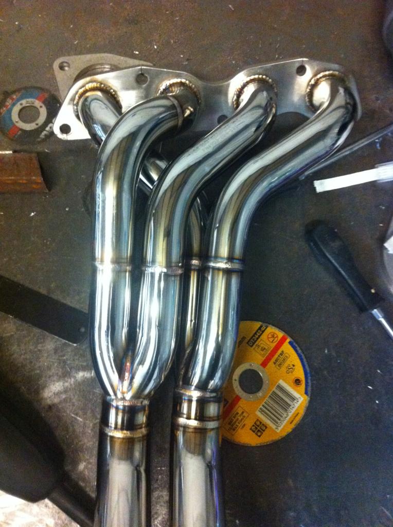

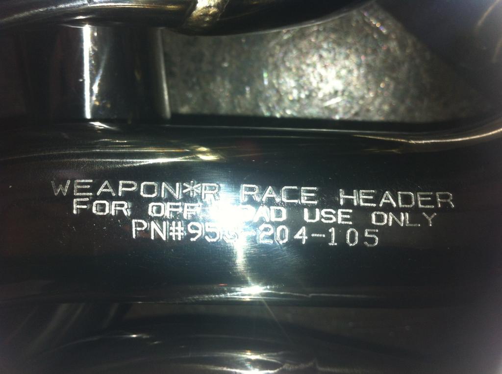

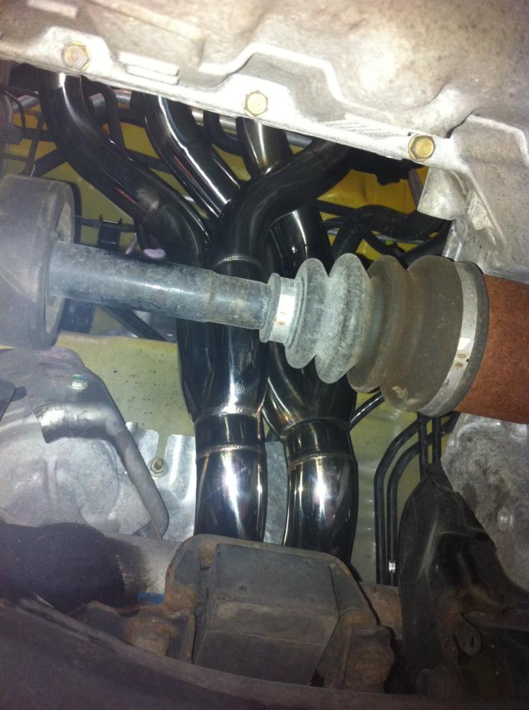

Weapon R 421 decat manifold!
'off road use only' yeah right!
This thing is beautiful!

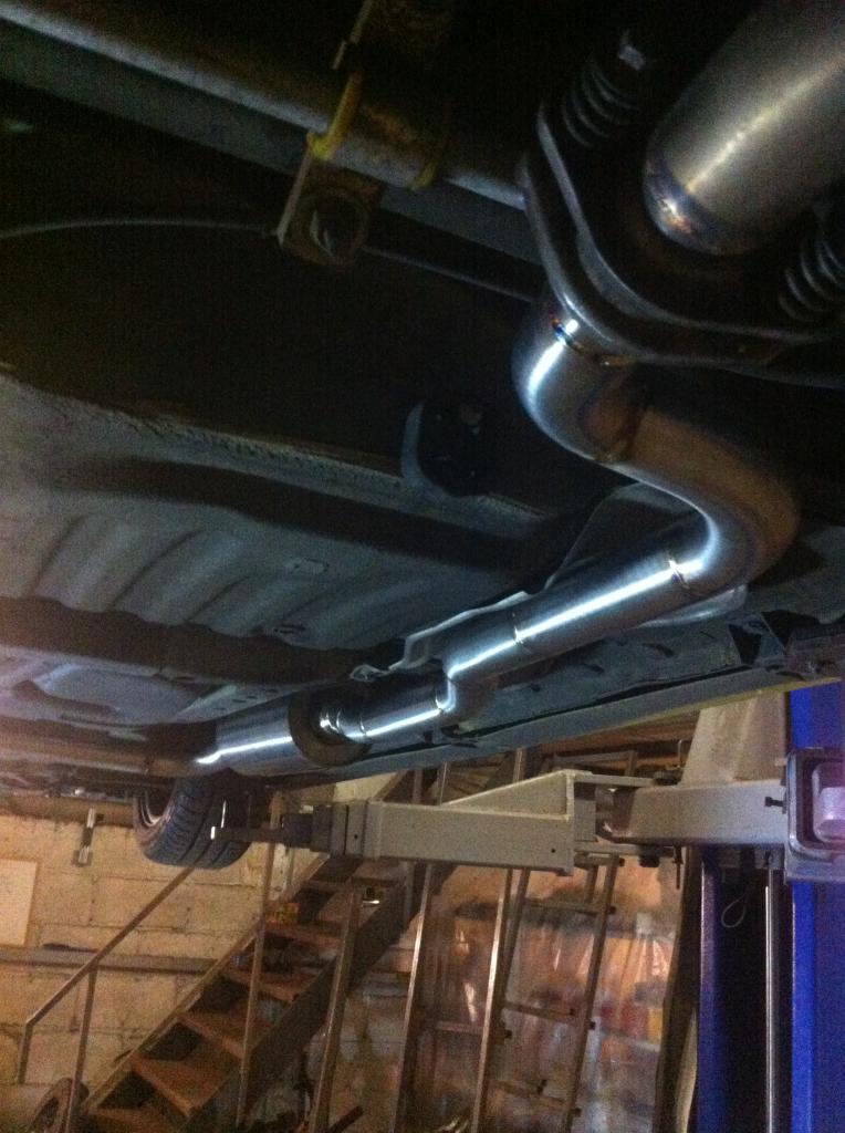

Custom 2" B pipe from Solid fab
First impressions of the weapon r header and b pipe are that its definitely louder but not as loud as i thought it would be which is perfect. Cruising speeds is still relatively quiet and has a nice deep tone when i put the foot down. Power wise its definitely added a few horses but I did this to improve torque rather than power.

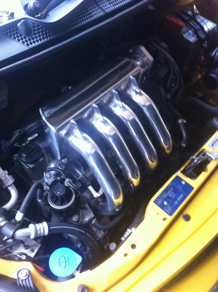

Had a sexy weapon r inlet manifold which wasn't compatible because it's designed for cable and not wire operated! Asked the company I bought it from to make sure it would be compatible with my car before I bought it and they said yes it is, then later found out that its not after removing my stock inlet manifold out!!
Such a shame as it looks so good in the bay!

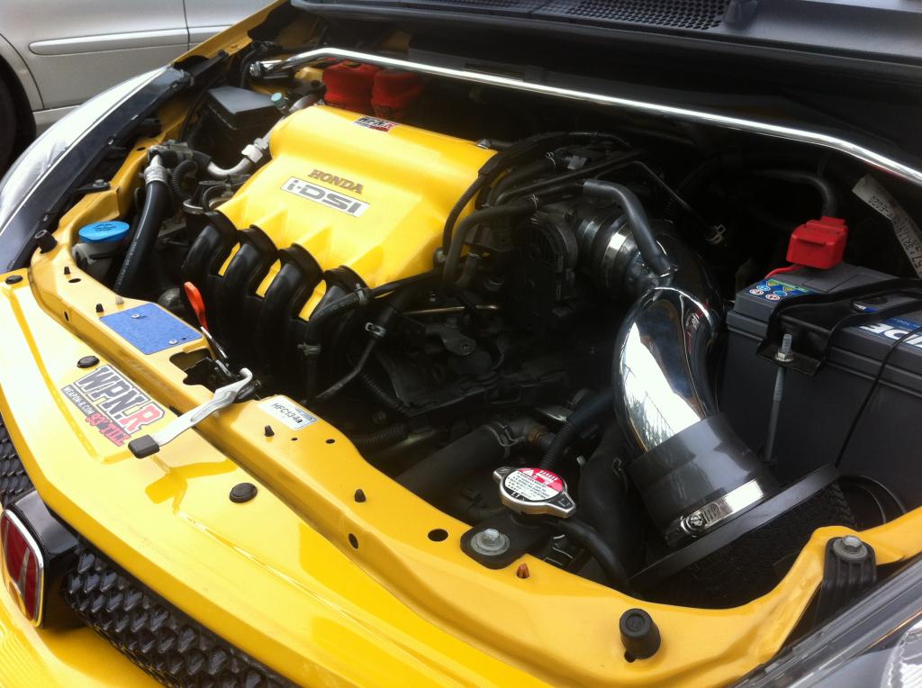

Installed the Weapon R short ram air intake, front upper strut bar and engine torque damper.

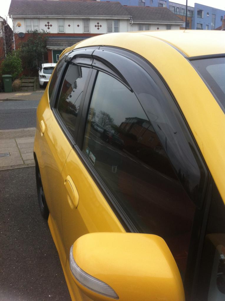

Couldn't take looking at those poor quality mugen rep wind deflectors any longer so i ordered some genuine ones from RHDjapan.
Needless to say the quality and fitment is soooo much better! Looks a lot better too.

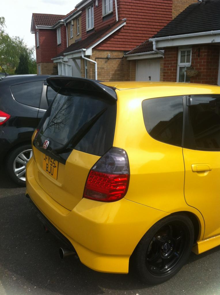

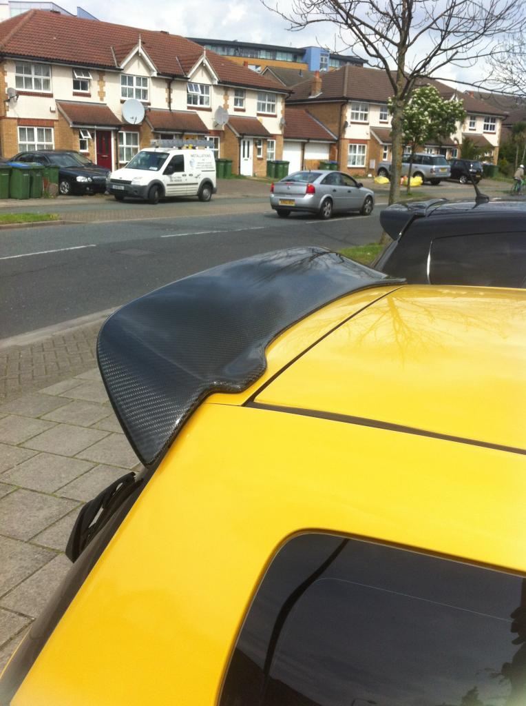

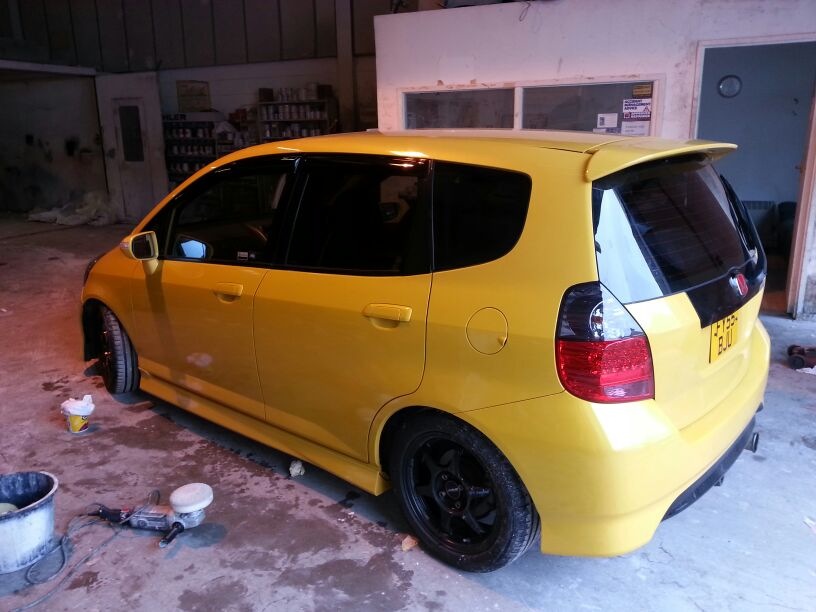

The last missing puzzle to finish off the rear. Been wanting one of these for ages! Carbon duckbill spoiler from kenken

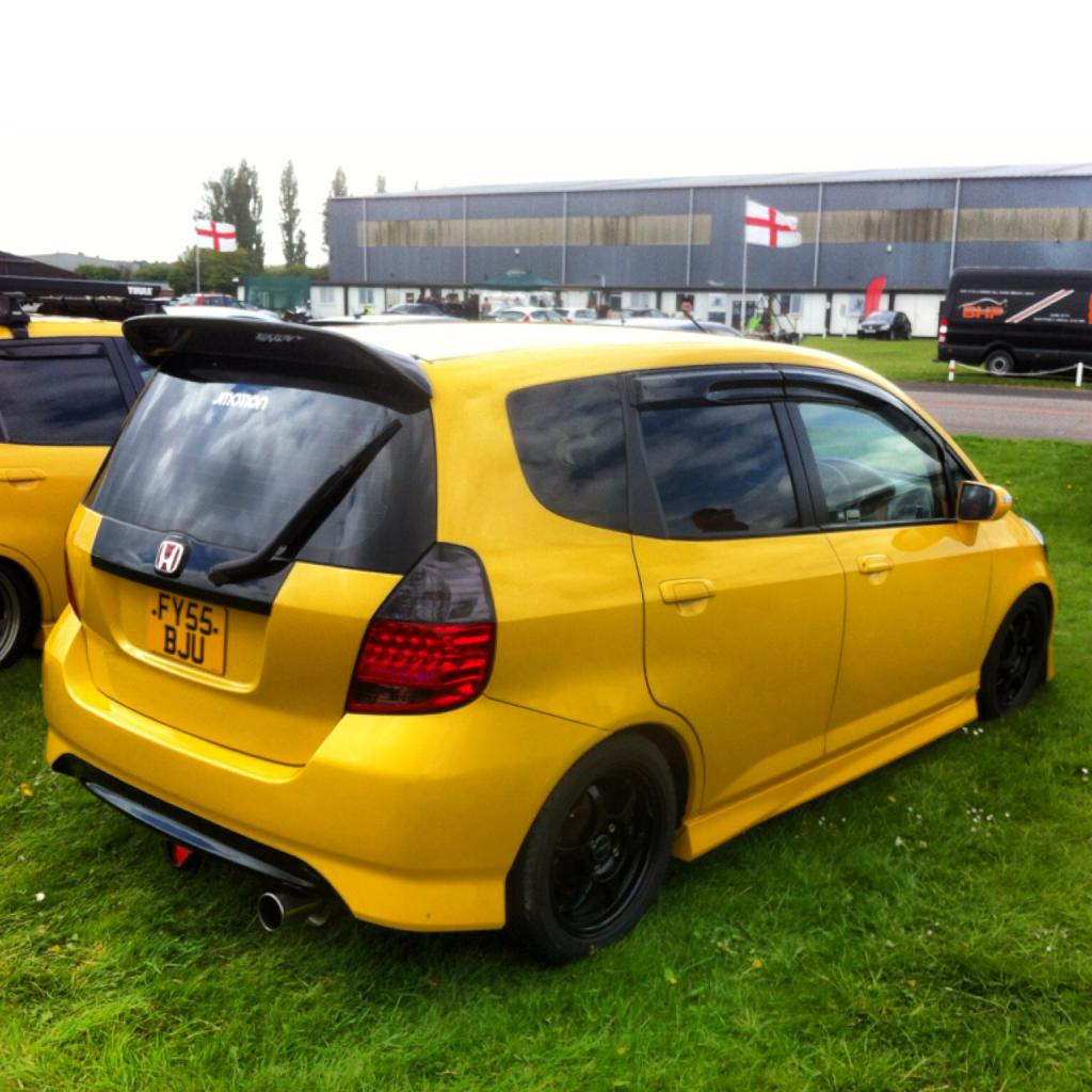

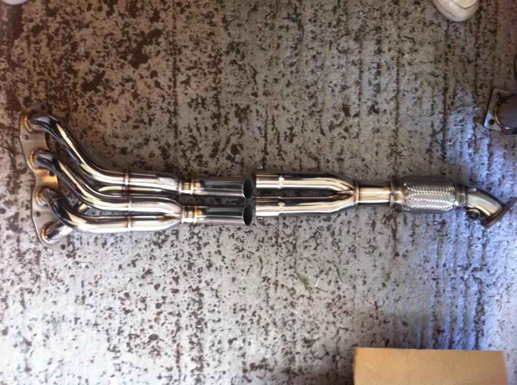

Few pictures from the first Mimms honda show of the year and meeting few of our new JMotion members.
