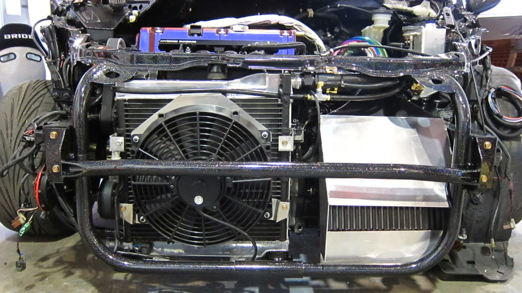

For the rebar, I haven't decided whether I'll buy a jdm one or get something fabbed up like felixy69:

I would suggest the core support and no rebar. Core support is just much cleaner than hacking the current one. The rebar does not fit as I tried it. It was weird. So basically I wasted money there. What I used was an easy custom bar that can be fabbed.
