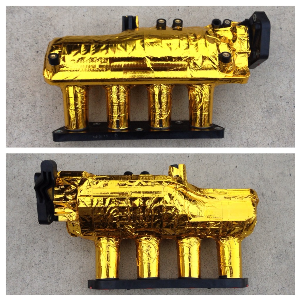

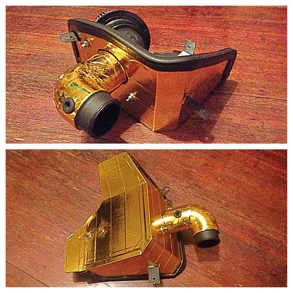

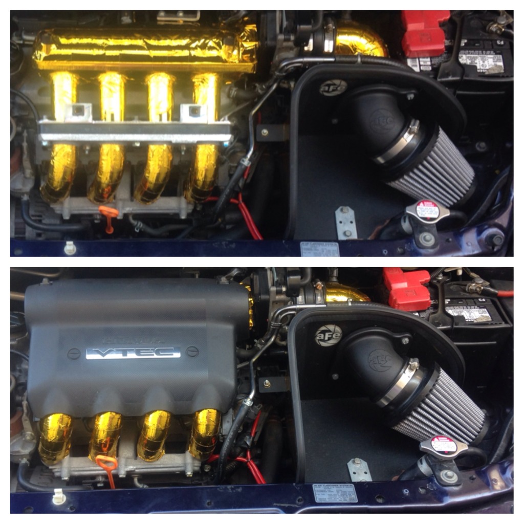

Been a minute since I updated this thread. Did a bunch of new things so I'll start posting up stuff.
Wrapped my aFe intake, intake plenum, and runners with DEI gld foil to hel reduce temperatures while racing.

Are you able to test the aluminum runner for heat after racing or commuting to see whether it lowers or raises the temp?

Unfortunately I never documented any temps. I wish I did but was so eager to wrap the intake. One thing I will be able to tell is by touching the runners if they are cooler. I will find out soon.

yes please let me know cause Im going to start a log up here on some temps verses ambient temps.
My plan is to coat them using a zirconium oxide and perhaps put a heat sink in between each runner but we will see how warm my base line gets first to see if it is worth the effort.

I thought about getting a Heat Shield product panel to cover the valve cover and possible run it over the head around the runner flange. That with a thermo gasket and the intake fully wrapped would have to make some type of difference.
The shitty part on SCCA running for STF class is that we cannot modify or add any type of hood scoops of cowls. Have a scoop by the wiper would help so much with flowing cool air and circulation into the engine bay. That would probably help increase actually numbers.

I've wrapped intercooler end tanks and air boxes before on other cars. It definitely makes a difference. Very smart mod.

So I measured the heat from one part of the runner (non-wrapped) to the other (wrapped). Wow whats a difference. There was roughly about a 25-35 degree difference.

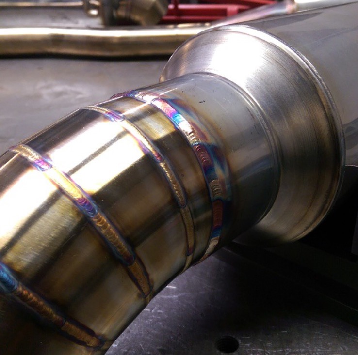

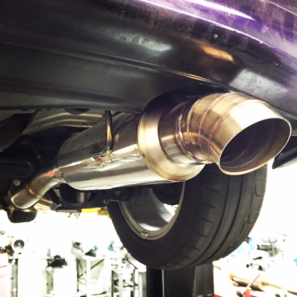

Heres an update on my axle back that was custom made for the Fit by JSPFab.
Cut the MR mid-pipe end off (due to reduction 2 1/4" to 1 3/4") and made it a 2 1/4" end. The axle back is 2 1/4" piping which goes to 3" into the muffler end (muffler is 3" straight through) using a Coast Fab muffler.

Nice exhaust! Which part of the megan mid pipe has the restriction? I need a mid pipe myself. And i'd LOVE it if the WR race header would come back in stock!

On the MR mid pipe where the pipe connects to the axle back on the muffler. It tapers from 2.25" piping to a 1 3/4" connecter. They to this to fit the OE exhaust axle back. Later this year I will switching out the MR product with custom. It should cut the weight in half at least. We're thinking some 18-20 gauge steel.

The DEI wrap cut temps down upwards of 30 degrees.
