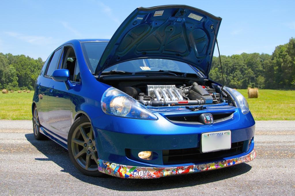

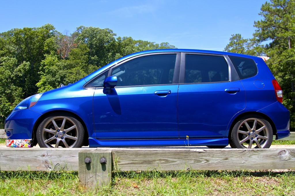

MY 08 VBP KWSC High Boost

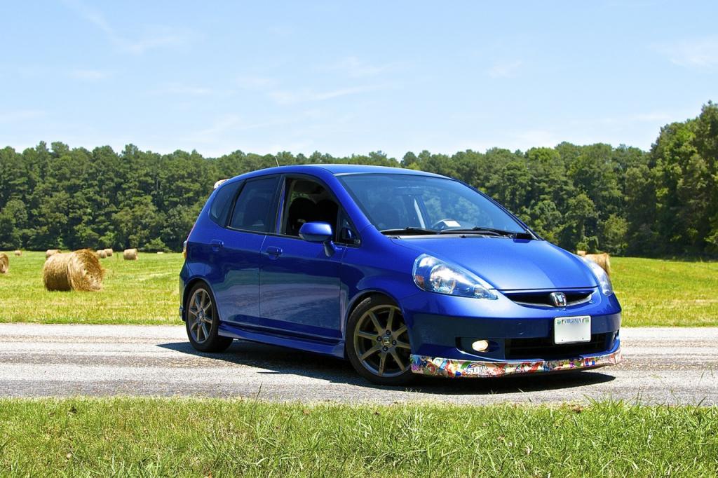

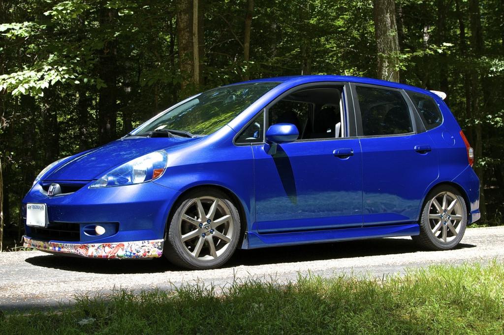

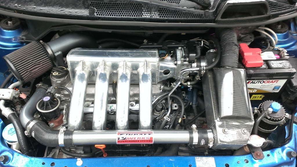

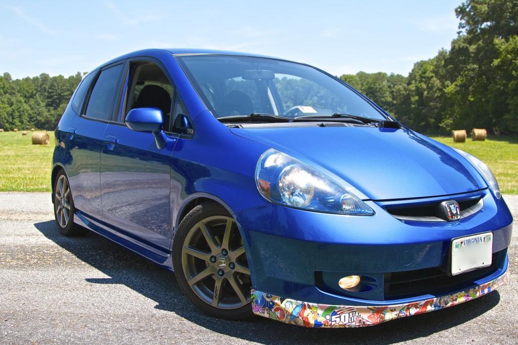

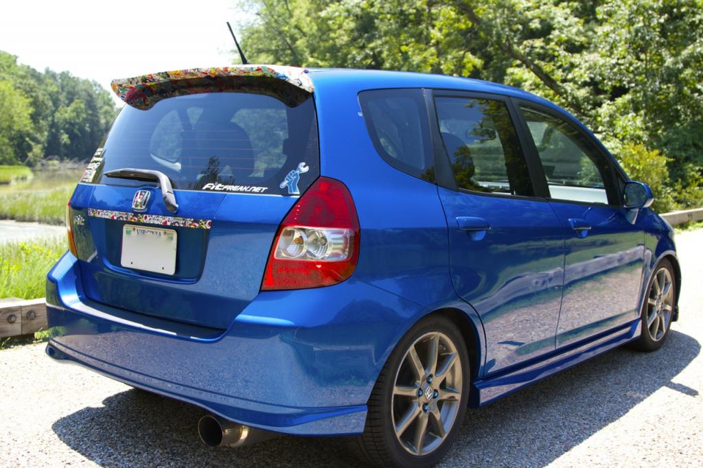

Finally took some pics... East Coast Virginia
KWSC 10psi - max 13psi - 85mm pulley
Weapon-R IM
410cc RDX Injectors
Megan Header
Cat Delete - DC Test pipe
Skunk2 - MegaPower exhaust
Sprint Springs - I love these springs!
Went a touch cooler on plugs - IK24
75 Shot Nitrous
Thinking about IC delete and going W/M as the IC is a choke point for boost.

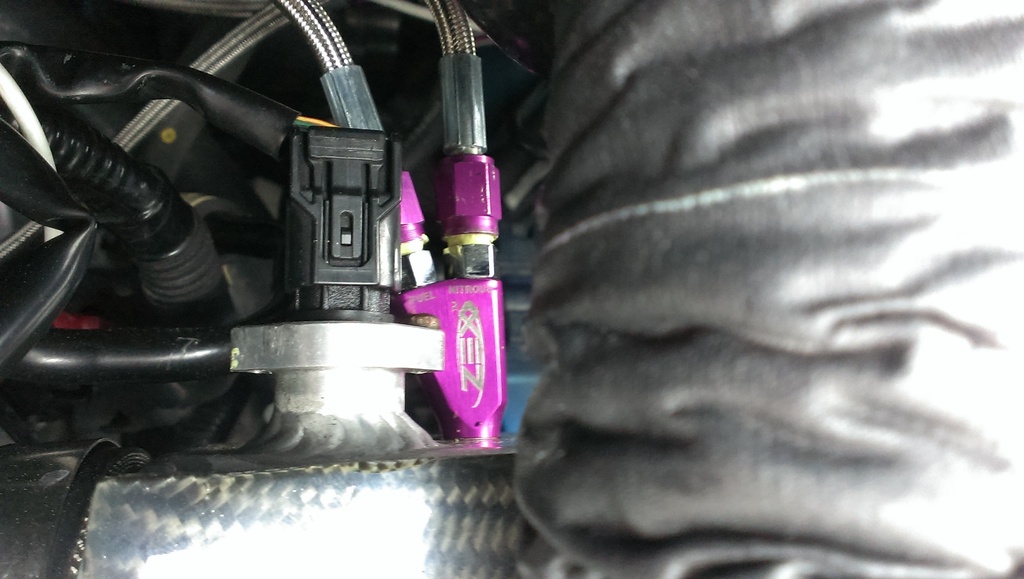

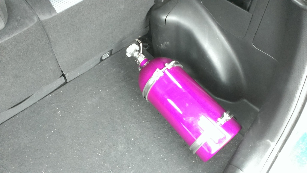

Also, I wanted to ask. Your Zex nitrous setup looks like a wet kit. Have you used it and have you had any concerns with fuel pooling up in your intake manifold?

It is a wet system. I'm not too worried about it pooling. By the time the N2O kicks in boost is pushing it through. After playing with the N2O, I will turn it off and do a 7000 rpm pull to blow it out. I have had a couple times of a hard time starting after running spray and parking. Pulled the plugs and they look great. The only issue is the hard start that I am working on. I went to a colder plug from a IK22 to IK24, but haven't ran spray on them yet.
