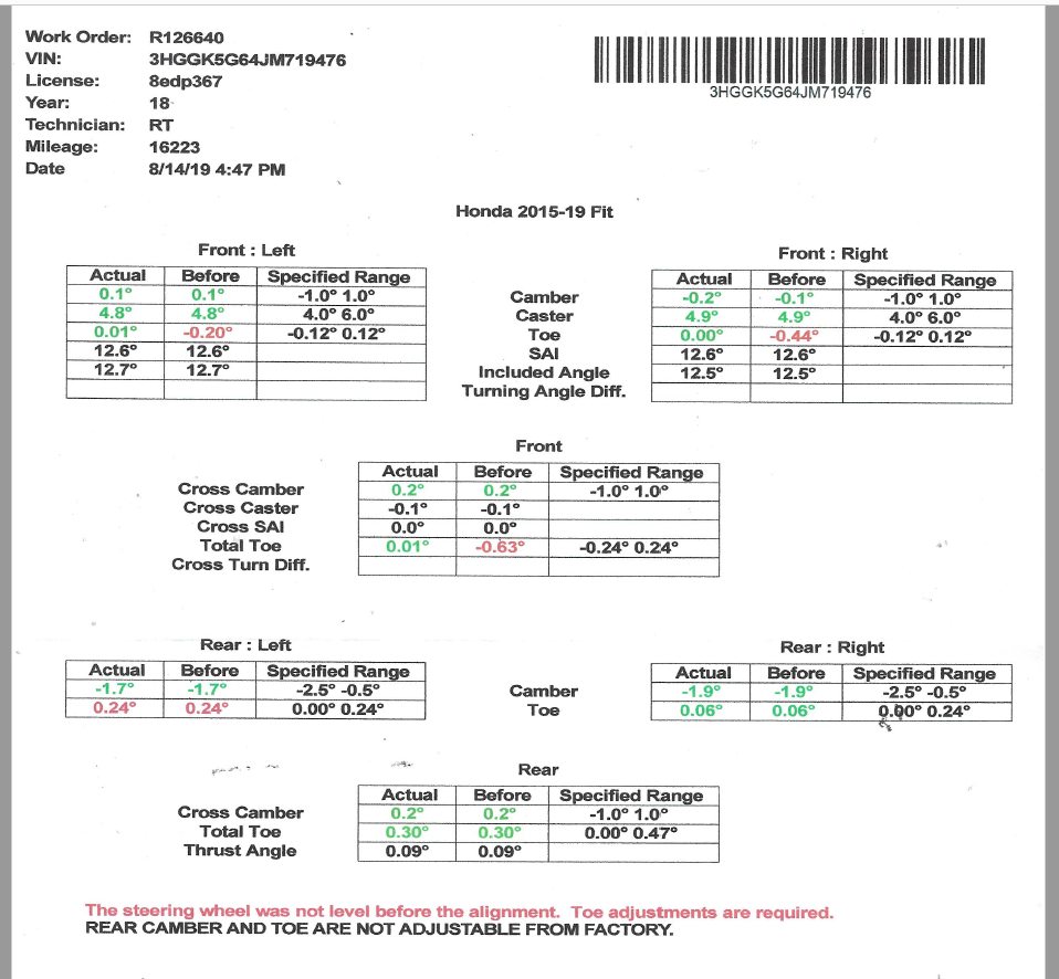

Hi all!
Need some input on alignments. So i recently got the HFP suspension kit installed on my 18 Fit Sport. Drove it around for a week to let it settle in and went back to the shop for an alignment. The left rear toe is off and I was told that since it's a solid rear axle, there's no toe adjustment. While the car does track straight, the steering wheel is slightly to the left as i'm driving straight. Any suggestions on what I can do? I really don't want to but a new rear axle beam. I have 16,500 miles on it.

you'll need shims to correct that toe. there is an spc kit that includes a shim for .20°, so that would put you at .04° and you'd be back in the green.

went ahead and uploaded instructions for ya, for when youre ready to do that fix. should take a whopping 30 mins of your life to do

You're crooked steering wheel while driving straight can be fixed. I got an alignment and while it tracked straight, the steering wheel was turned to the left. I took it back and they fixed it.
