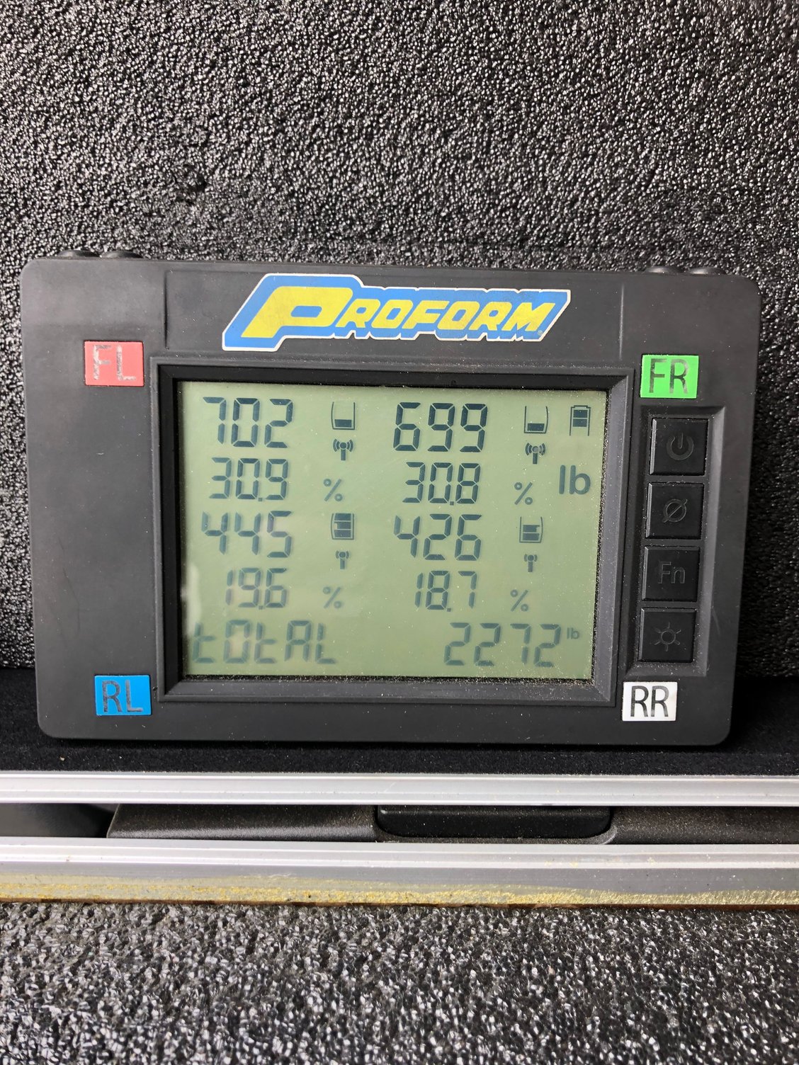

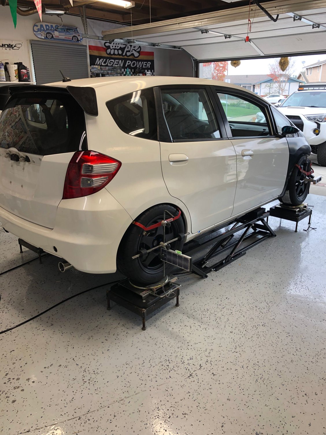

2010 fit Alignment and corner balance done. 2000lbs with kswap
Had my alignment done and with tcs plates was able to get 6.5 caster 3.5 camber and a corner balance weight of 2200 with me weighing 185lb and with kswap.
This thing should be fun on the track.

That thing is going to be a blast!!! Nice setup you got there too!!
