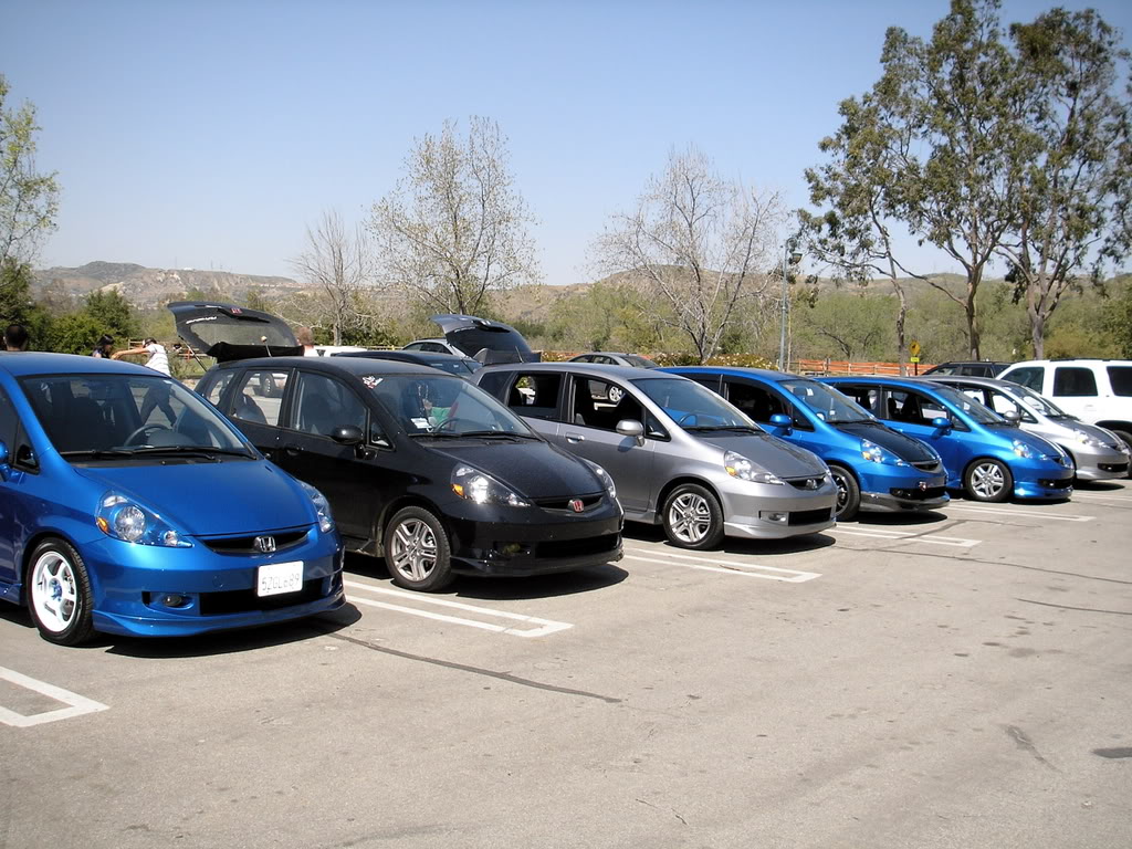

This picture was taken right after we installed the coilover and was wondering how would look when slammed

They are DME( Design Motorsport Engineering) full coilover, but the company have yet to release them.
And as requested more pictures
I'm the last blue on the right

Looks awesome. i wanna go that low or lower

Sound slike a good plan in theory. But the fits nose hangs out pretty far, and any more than a 2" drop and you really mess up your roll center. So handling will get really wonky and unbalanced. Also with coilovers the rear suspension only ends up with about 3" of travel at best. Go for it if you want, but it's not going to be safe.

Thanks, but honestly going lower is bitch to drive sometime, but we did slammed my fit to the point where my lip is just sitting on the ground, hell it was really cool for show, but driving F**k that. lol
