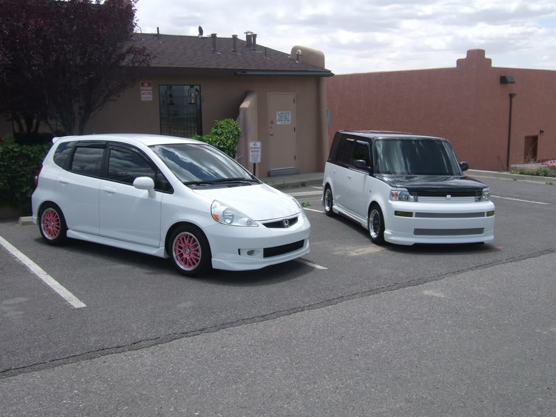

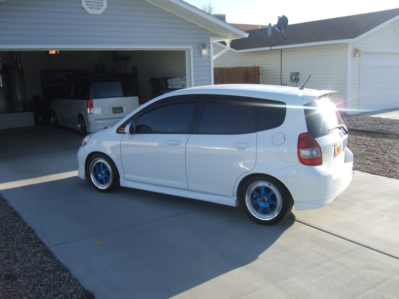

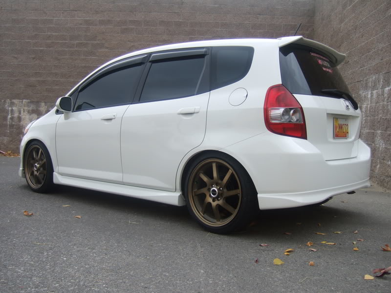

Just like was posted by the starter of the topic, we ran 205/40/17s after fender rolling, there was no rubbing.
I dont need snowy or ice conditions to test it, I live in an oilfield town with four wheel drive trucks ruining the streets all day long. no snow, nor ice could make a vehicle rub worst than it would dry. The only reason it would rub worst is if you were rally racing the car. they rub because of the suspension absorbing shock, not because of slippery conditions on the roadway.
The falken 17"s were run ALL WINTER LONG.
All in all, we have run 3 sets of 15"s, 1 set of 16"s, and one set of 17"s.
That is just the fit, all in all, I have ran 13 sets of wheels in about 5 years. Including a set of 19"s on a 98 contour SVT that EVERYONE said would rub. It never did.
Also, offset doesnt mean anything if the wheel width is different. a +42 offset will stick out about 6 mm more on an 8" wheel, than a 7" wheel.
