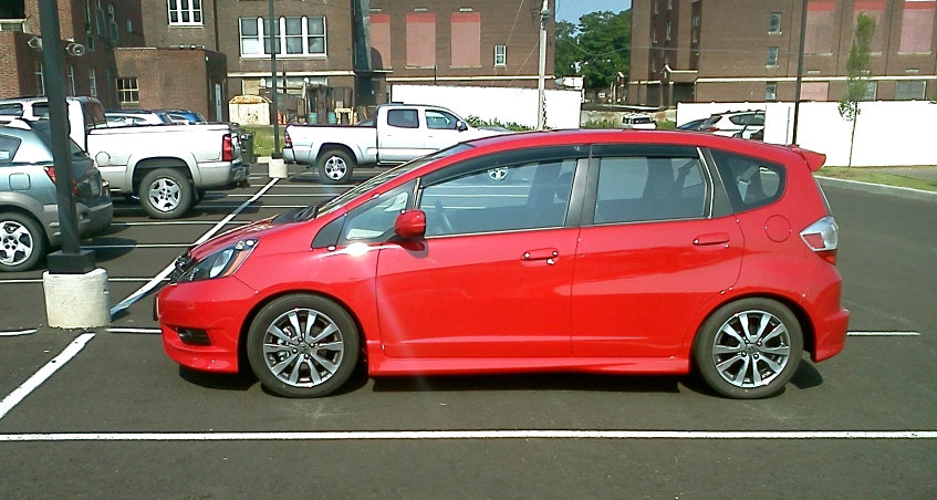

Had Eibach Pro-Kit installed this morning by Chris at Redshift going back in October for rear shocks. Picture not the greatest, lower then I thought but was very happy with the results.

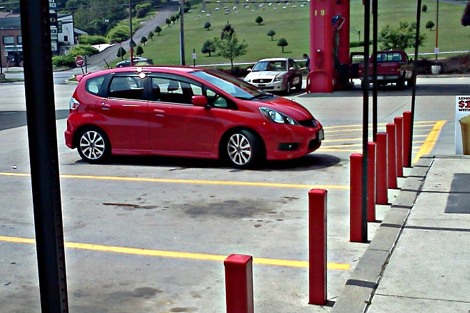

Better side picture.Name:  secondoffice2.jpg

Looks good. What finger gap do you have R/R? Do they feel hard or just firm?

Have not measure the gap. (Will later today.) Rides similar to OEM just feels a litle more planted, which was my goal with the springs. Handling should be the same as OEM. Before the car seem to bounce around at high speeds or windy days.
I was surprise at the drop I was not anticipating this much but was very happy.

cjecpa, please if you could give me some feedback. Your Fit in the profile view. Is the rear lowered? Cjecpa, you did this soly by changing the springs? I'm looking for a lowered look. Yet keeping the ride as close to OEM as possible. It's shame many states don't allow tints. First thing I did was get tints and OEM window visors. I p/u visors through EBAY.

I used Eibach springs lowers the rear by 1.4" and front 1.2". When we took it off the jack stands I did not expect this amount of drop but I was very happy to reduce the wheel gap. The ride to me seems the same as OEM. I read on the Sport in reviews the ride was more stiff. My next mod will be a progress rear sway bar I am trying to keep improving the handling.
