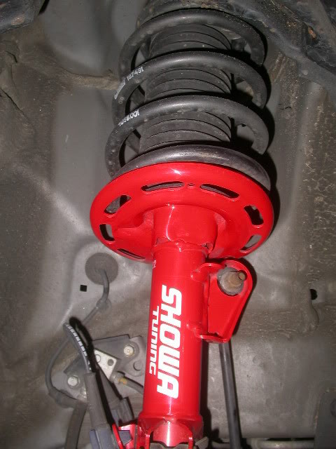

Mugen,J's racing,SPOON & showa tuning are all manufactured by SHOWA, which Showa also manufacture tons of hydraulic parts for Honda & Acura. My setup are not the SPOON setup. I actually bought these ones:
SHOWA TUNINGFƒVƒ‡[ƒEƒ`ƒ…[ƒjƒ“ƒO
I'm using Eibach pro kit front springs & T1R ver.1 rear springs now to maintain a certain ride height(I don't like it low) while stiffen up the ride. I use the T1R rear springs just because the Eibach rubs like crazy when I have something loaded in the back(again it's 15x6.5 +45mm with 205/50R15 tires that I'm using now). I think either +42 or +45mm offset is safe to go for. U can even use tires in 195/55R15 IMO.
Make sure u get camber bolts installed & alignment done after the Mugens are settled after a couple of weeks

Originally Posted by Type 100
Would like to ask about these. Sorry for resurrecting this thread.
Did you try the ride quality on the Showa Tuning springs before you swapped them out for the Eibachs?
I didn't buy the setup with Showa's springs. They weren't available from the source that I bought them from. I would recommend swift springs or other springs closer to a linear design if u want it a lil more responsive. The Eibach pro-kit front springs I got are a lil soft.
