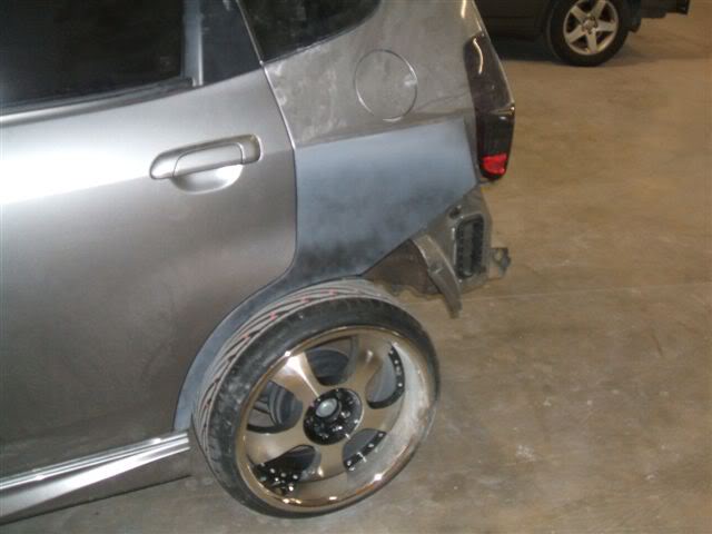

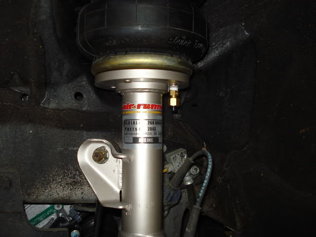

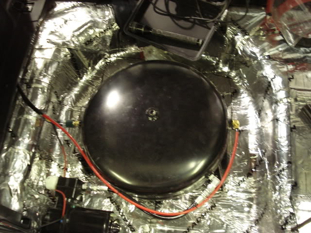

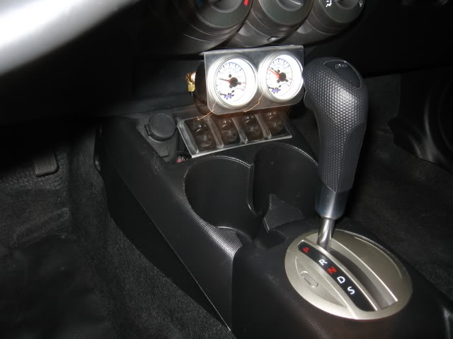

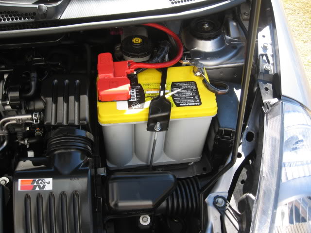

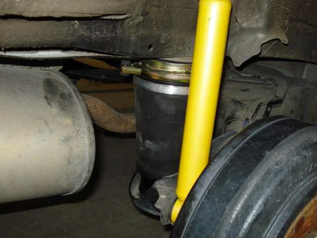

1) Type of shocks: Bag over coil or Bag over strut
KYB for Air Runner
2) Brand/Type of bags: Uair sports bags or Firestone Sleeves
Firestone
3) Size/Type of tank : 5gallon or 4.5gallon pancake tank
4 gal pancake
4) Brand of Compressors and how many
1 ACC compressor
5) Air Managment system : full digi or not....
Analog gauges
6) brand/Size of your wheels/tires
XXR Style 504 18x8 +32 205/35R18 Toyo Proxes T1R
XXR Style 006 18x7.5 +42 215/35R18 Toyo Proxes T1R
XXR Stle 513 15x7 +15 195/55R15 Toyo Proxes FX4
7) Other Tech info you want us to know.
Air Runner Kit. Daily Driven without issues
8) Detail pictures

MarkyMark that looks sick. Was the kit straight bolt on? Does your alignment get out of wack if you raise and lower the car a lot?
Old Nov 23, 2008 | 07:35 AM
MarkyMark's Avatar
Joined: Jan 2007
Posts: 574
From: ATL, GA USA
bolt on for the most part, it's a JDM kit, so there was a little drilling. As for the alignment, the front toe is set to spec, which shouldn't change.
