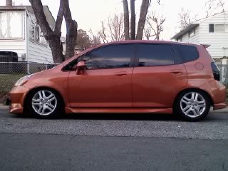

SKUNK2 PRO C's all the way! Thats what I am running, I love em' they would be great for what u wanna do them as far as daily and weekend lapper! there 12way ajus. damper so u can go back a fourth from daily to lapper in just a few turns of the nobb on top of the sturt, I drive daily on setting 6 and it rides like it just came of the lot and its slammed, if this is the route u wanna go call Tony shagday up at skunk2 his # is 951-808-9888 ex.204 tell him Jason from Baltimore MD. sent u and he will hook it up. heres a pic 4 ya
and I can go a 1 1/4inch. lower all the way around
