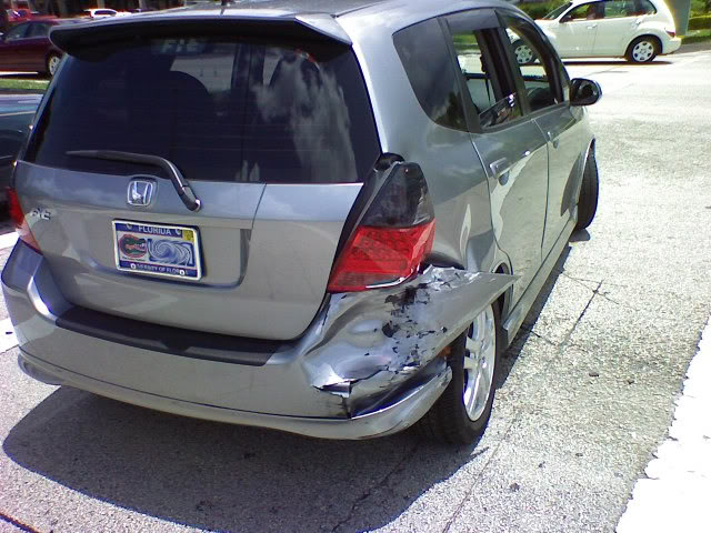

I was rear ended in my fit. luckily there was not any damage to the suspension. I just needed a new rear bumper/lip and part of the rear quarter. here is a pic of the damage:
I do not know what it would take to mess up the suspension but I am sure it would take quite a lot.
