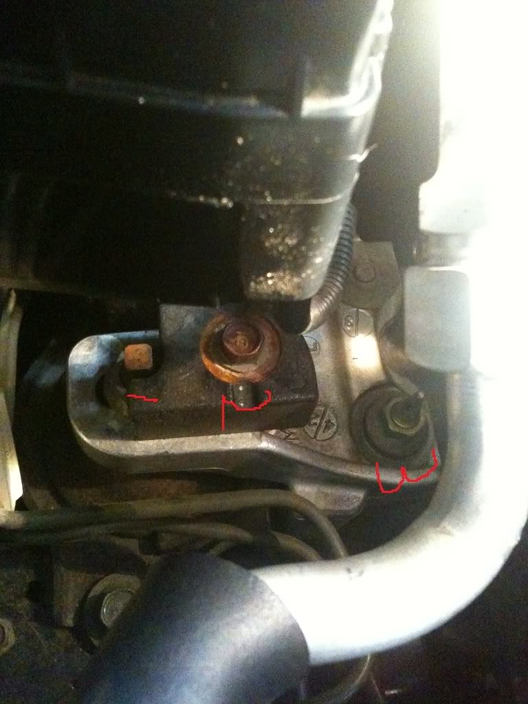

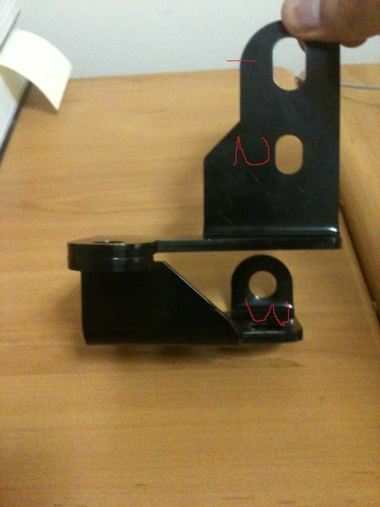

To install the bracket that mounts the ETD onto the engine mount it appear I have to under the 3 bolts on the mount. This is the part I am unsure about.
If I undo these 3 (they all have to come off at once) will the engine move/(worst case scenario) drop out of the car?
I've attached some pics of the bracket and the bolts so you have an idea of what I am talking about. Every other ETD I've seen has been 1 or 2 bolts at most on the block or mount and look like a 2 minute eyes closed job.
Any ideas would be appreciated. I've never seen another Jazz/Fit with one installed on the forums otherwise I'd have asked them for some advice
I have also used my extreme mspaint skills to label the holes and bolts with corresponding numbers.

The spoon one only bolts onto bolt #3 shown in the picture (from what I have seen of the pictures of brackets and it installed on the net).
This is the correct part for the JDM GD3 and it lines up no worries at all. I am just concerned about undoing the 3 nuts on those bolts and having them off at the same time.

Just use a block of wood and a jack and put it under the engine and lift it some. That will allow you to loosen the bolts, install the bracket, and then tighten everything back up again.
I've replaced engine mounts without having the engine out of the bay before doing it this way.
