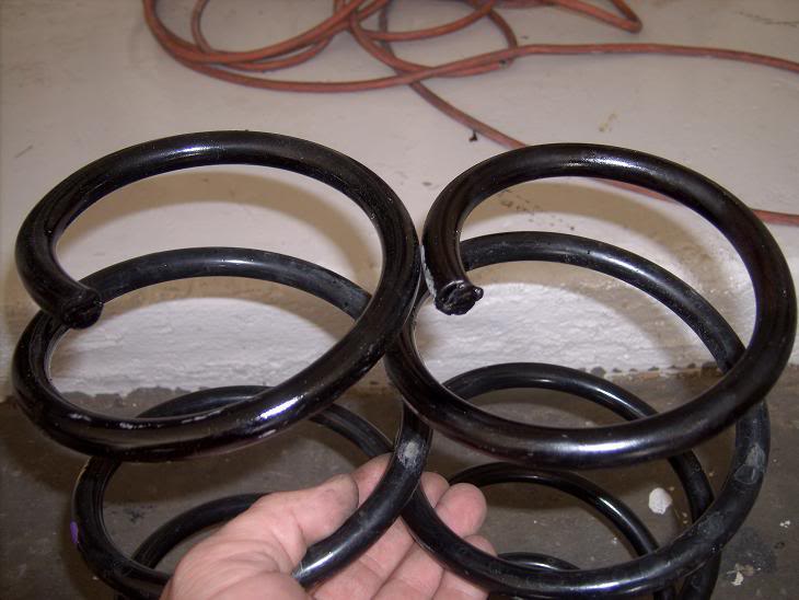

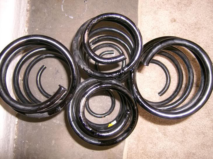

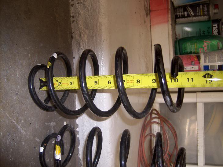

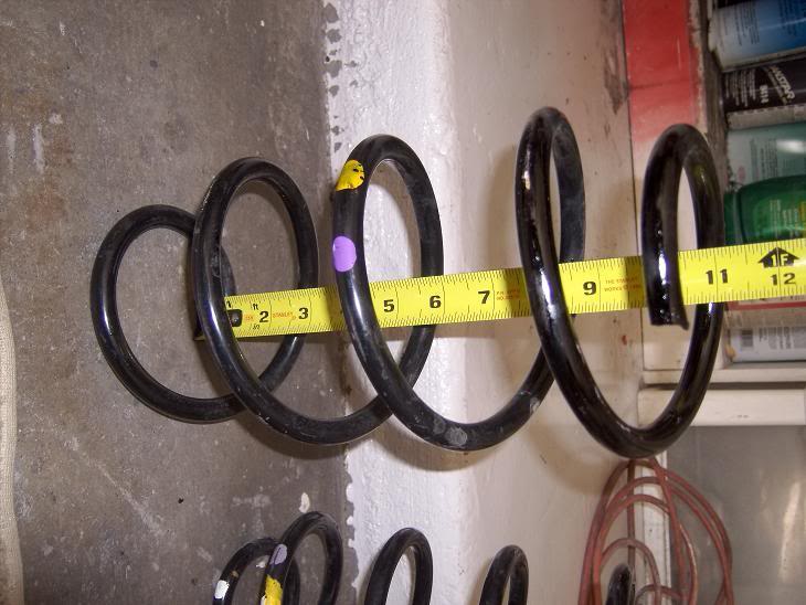

The problem with cutting fit springs is they are tapered in at the top & bottom so aside from the cut they need to be heated up and rewound as seen below. Note how only 1 side needs to be cut and i suggest you make it the top. Although some crafty home mechanics with a heavy duty vise, torch and balls can do this i would recommend handing it over to the professionals. In my town we have Mc Brides springs co. any spring and suspension shop will be able to take on yours it helps if you find one that deals in commercial repair and modification though epically if you can find some old timers familiar with cutting techniques and variable spring rates.
I told them to make my cuts on the heavy side of 2-2.5" and ended up with just that.

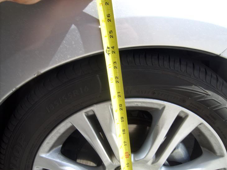

At the following measurements i can vouch it does not bottom out.

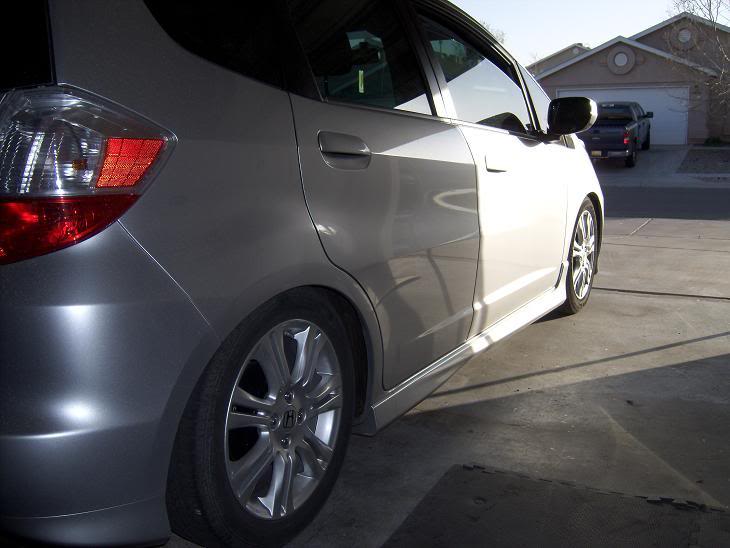

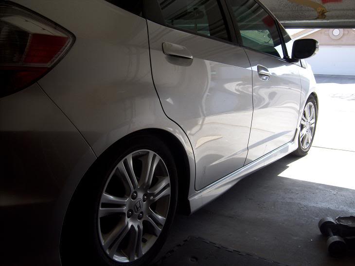

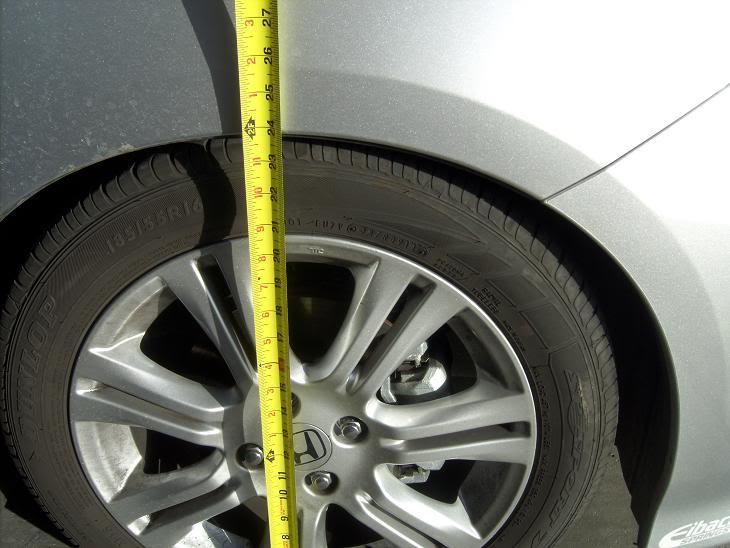

Heres an overview
REARB4
REARAFTER
FRONTB4
FRONTAFTER
CARB4
CARAFTER
overall i am verry pleased i wish i had gone further down on the front but gravity and time should help with that.

If you can settle for a swift 1" drop (
) more power to you.If you can shell out a few hundie to use a different setup great!!
and to clarify i replaced eibach 2"+ drop springs with modified stock springs.
Ok but the problem with that is that now all your springs have different rates now. No human could ever heat and cut in the exact same position on a spring. I know they did this in the old days but that was because there wasn't any companies selling stuff to modify your car.
Lol you guys take it like monkeys attacked the springs with a angle grinder. The truth is your right they will never be 100% exactley the same rate. However when lined up the cuts were dead even as were the re-wound areas. They ride great far better than the ebiachs that are designed to perform and fall horribly short. They feel even to me and that's the measurement that counts in the end.
If anyone can cut springs right, its the people I used. Arguing the state of craftsmanship here is arguing there 40+ years in this bussiness. They can compress and measure spring rates, they can and do cut springs from rolls of metal. They have done it every day for 40 years.

i don't think they're talking about 1 or 2%... i think they're talking a much wider margin of error on that one unless you're using a very accurate oven and heating each one the same amount of time... and not using a torch...
the eibachs have a higher spring rate which will accelerate the wear on the struts... it's been fairly well documented all over the place that nearly all the time, when replacing springs with lowering springs w/ higher spring rates, you'll need higher performance struts to go with it...
but have YOU been doing it for 40+ years?
i don't think anyone is arguing how major manufacturers make springs... i think we're arguing the safety of a guy doing it in his garage with a torch and a vice...
the issue with heating metal with a torch is that you're creating hot spots in the metal that will decrease the strength of the spring, and, in all likelyhood, in one place... this means that the spring now has one defined weak point to break, should it decide to do so...
with that stock spring rate and with that small distance of travel, you will be riding the bump stops quite a bit on bumps...
people have been cutting springs for a long time... many have been able to get away with it, some haven't... if all you're going for is look, then enjoy and i hope it doesn't fail... but they will not perform better than the swifts on stock struts, or on eibachs with aftermarket struts...
