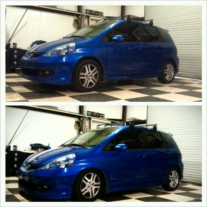

Morning everyone, last night I lowered my '07 fit sport with tein springs. I havent got to drive it enough yet to review the ride but so far it seems to ride pretty good, and I havent rubbed anything yet. I am however not happy with the rake. I havent measured the height so I do not know how much of a rake it has ( I will measure when I get off work and post results)
Is there anyway to raise to the front or lower the rear to reduce the rake? It looks like about .5" would be enough to even it out.
Before and After pic I took with my cell phone

Looks like you did it correctly. Unfortunately, springs really do not offer that much drop. I think the most drop I've seen from springs will be with the Eibach Sportlines F2.0" R1.8". I am on Skunk2 springs and mine only dropped a little.
Hopefully yours still settles a bit, try driving it around for a while. Or if you're still not happy, just save up for coilovers. That's what I'm doing.

You did it right. According to the specs, Teins have 0.6" of rake front to back, which is on the high end for springs. My Swifts only have 0.2" (1.2"F and 1.0"R), but the drop overall is less. The sportlines do look to be the only springs with a big, almost-level drop. (I consider 2" a lot if your car is a DD).

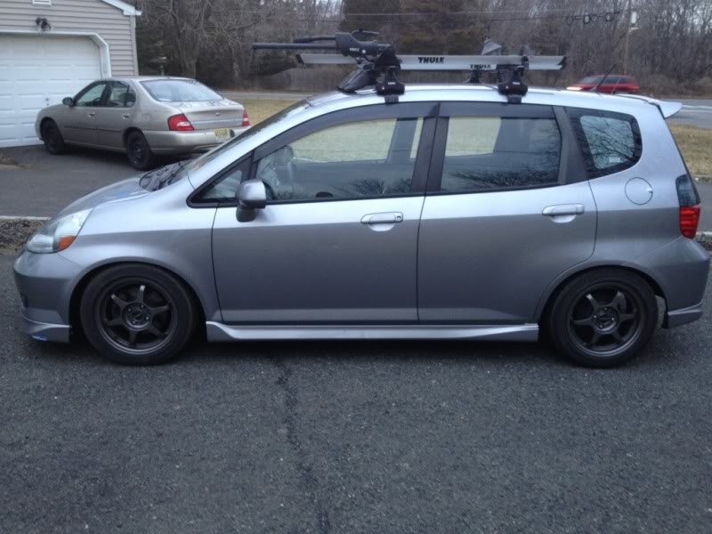

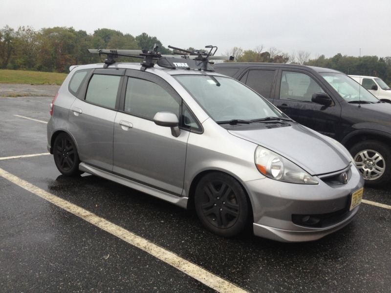

If you feel comfortable, You could trim one coil off of the rear. This is on both of the fits in my household. Here is the GD:

I didn't do the work, I bought them both used from the same member on this board. It looks like he cut one coil off and put some heater hose around it. Here is the thread:

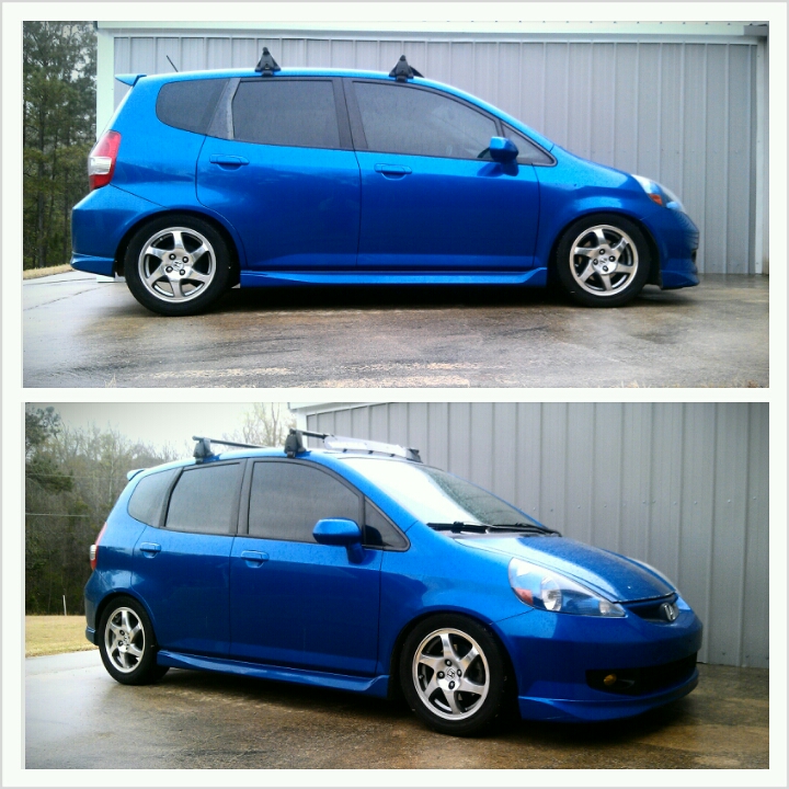

Ok so Friday after work I removed the rear springs and trimmed exactly half a coil off, and I am happy with the results. I could feel a little difference in the ride in the rear it feels a little more bouncy but not much.
I took the car on a 400 mile trip this weekend so I can review the springs a little better. The drop on the Tein's in my opinion is too low in the front. I RARELY ever say something is too low but this is my vacation (road trip) car and with this drop and a 205/50/15 tire I rub the inner fenders on most bumps. I may be able to modify the inner fender a little to prevent the rubbing which I will try and do this week.. I love the look, and it sits great after I trimmed the rear springs but I wish the front sat about .2" higher.. that way I would not rub and my wife would nag me less. If I am able to modify the inner fender enough so it will not rub I will be alot happier. I wanted a good stance but still have no rubbing due to the constant trips we take in this car, thats why I went with the 1.8" drop with tein over the 2.0" sportlines. If I was on the sportlines the tire would be touching the inner fender while sitting still.. right now I have barely 1 finger gap between the top outside edge of the tire and the inner fender. The ride is pretty firm compared to stock but I do not believe it is due to the springs I used I believe it is because of the suspension setup. On my honda wagovan when I lowered it I also added extended tophates so the strut kept the stock travel while the car itself was lowered. This is not possible on the fit and when you install lowering springs, no matter what brand, the strut operates semi-compressed at all times. That is my logic on it but I could be wrong. I have had alot of lowered cars so take my opinion for what its worth. My daily driver sierra is lowered 5 inches front and 7 inches rear.
anyways onto a picture. this is the tein s-techs with the rears trimmed half a coil on the bottom side of the spring. also installed some GSR Blades let me know what you think.

looks great. check out the fender liner tuck, should solve all your problems.

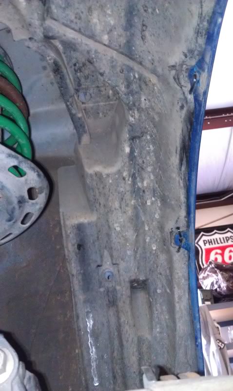

I tucked the fender liner in last night (see the pic below). I drilled a small hole on each side of the mounting holes in the fender liner, then I tucked the liner in behind the mounting tabs on the fender and zip tied them together. This was harder than it sounds because I wanted the bulky end of the zip tie on the topside of the liner so that it would not strike the tire. To do this I had to basically remove the whole fender liner and starting at the hole by the front bumper attach and tighten the zip tie then work my way back towards the door. After I got the liner secured I used a body hammer to "roll" the fender. A fender roller would have worked alot better but this did the job and didnt chip the paint except at a spot where the paint was already chipped. It feels like I have alot more room now but I havent driven it enough yet to see if I rubbed. I did do a couple u-turns both Right and Left and I didnt rub (I rubbed before doing this) so that makes me feel better. Its getting there! Going on another trip this weekend so I will be able to tell if what I did helped with the rubbing. also fixed the clunking issue I think.. sway bar end link was a little loose, barely loose but hopefully that fixed the issue. I didnt hear the noise driving to work this morning.

Just wanted to report back that 99.9% of the rubbing is gone after tucking the fender liner and rolling the lips in the front. Very happy with the setup now! Thanks everyone for your input and assistance!
