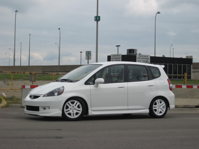

If that pic you posted is on Sportlines I wouldn't want to go any lower than that anyway, and if HTS can't handle lowering springs that's slightly disappointing.
