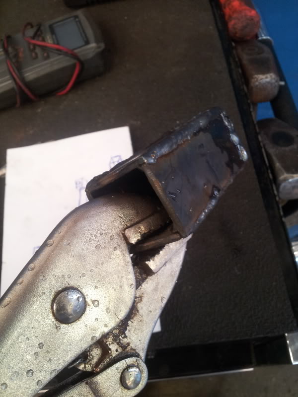

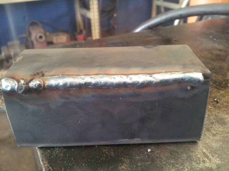

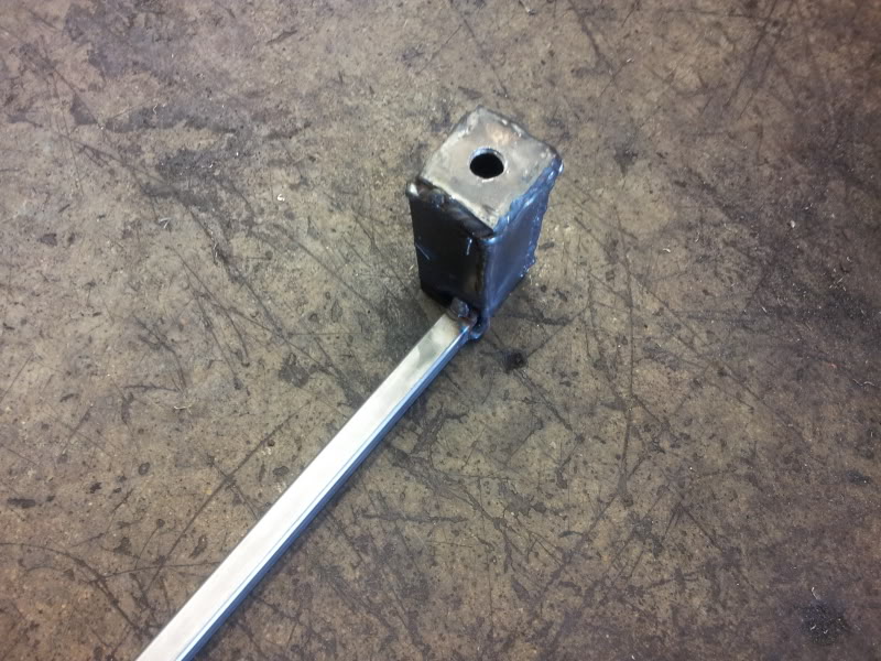

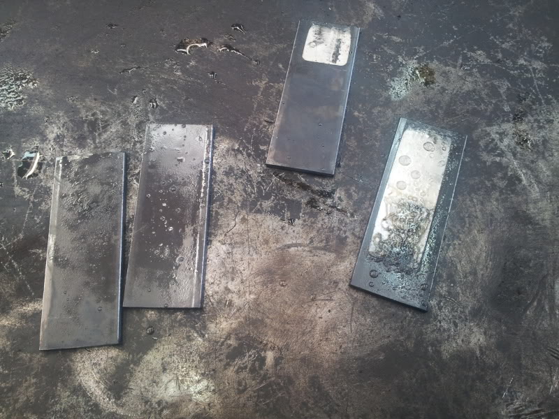

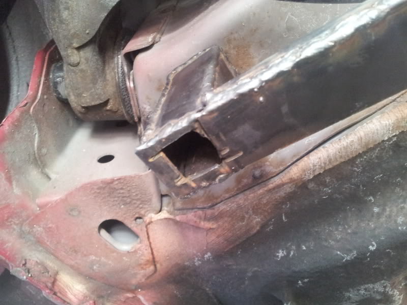

whats up, it was slow at the shop the other day so i decided to whip this up.
to be honest i wasn't sure if it would really make a difference or not but it actually did...
im warning you its a very ugly prototype but everything was done by hand.
1. well heres the start of the mounting posts.

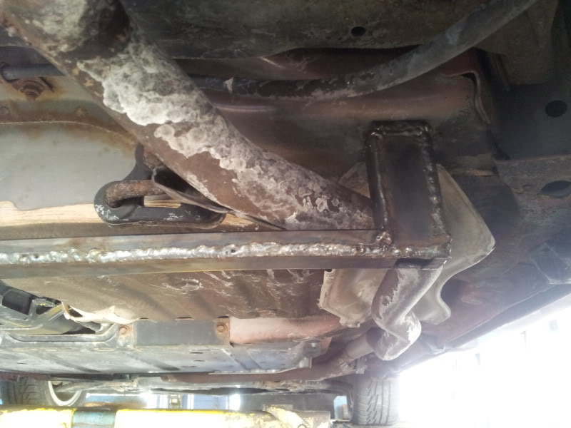

and the finished product

A+ for fabricating something, you don't see enough of that anymore IMO.
Just add more pieces and box it with some other points and X braces. You've gone this far, why not.
Then paint it. Pink.

Very clever way to add bracing. Looking at chassis design though I have doubts that does anything but add weight. I have wanted to box in the mount location for the rear torsion beam suspension arm much like the hpd rally fit.
Honda Media Newsroom - Fit - 2009 Honda Fit - Body - Structure
If you read over this page it will give you an idea where the strong points to the fit are. Now really good bracing crosses strong points. A triangle is the strongest shape to create a bracing designs.

and I was also quite skeptical as to whether or not it would work but it actually does, the rear feels so planted now, a lot less rear roll, shes already got strut bars front and rear also but still on the stock sport struts and shocks and springs.
if you've got the time and equipment ide say go for it.

I would remake it with some 1.5inch diameter 1/8inch thick tubing cut about 2-3 inches long, instead of that box.
Might make it easier to install and improves cosmetics.
If you are so bored, make a few to sell on here! Get with one of the moderators to determine any rules or restrictions.
Or just clean that one up and sell it to me lol

well I know its ugly but its so solid, besides this was just a rough draft.
and yea I was thinking of making another one to lend out and get feed back from another driver.

Is that mounted to the underside of where the seat mounts are?
Old Mar 29, 2014 | 11:12 PM
13fit's Avatar
Joined: Dec 2012
Posts: 1,911
From: Ft.Hood TX // LaCrosse WI
The seat mounts do not go all the way through. They bottom out on top just a little bit past the length of the seat bolts.
I wonder if they are unused holes from the awd model of the Fit
Old Mar 30, 2014 | 06:56 PM
bigiepigie's Avatar
Joined: Aug 2012
Posts: 34
From: illinois
there are two little black flat braces on each rear corner of the pinch welds basically, just look under there and youll see what I mean. I used the inner bolts on the braces.
